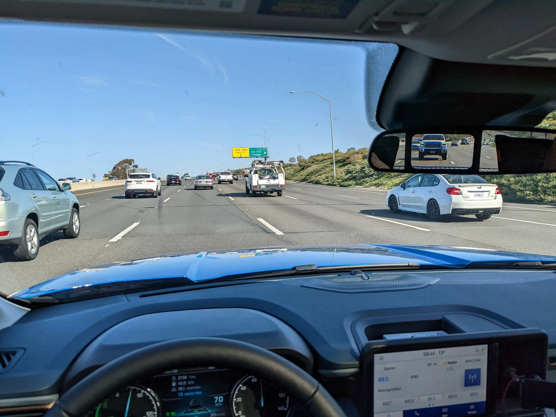

Original poster here:
Thanks @haze10 for your blunt recap of this discussion. You're absolutely right: no real solutions thus far, and I myself have been slacking on pursuing a solution too.
Been busy with other things, mostly house, family and work related, it is kind of how things go sometimes.

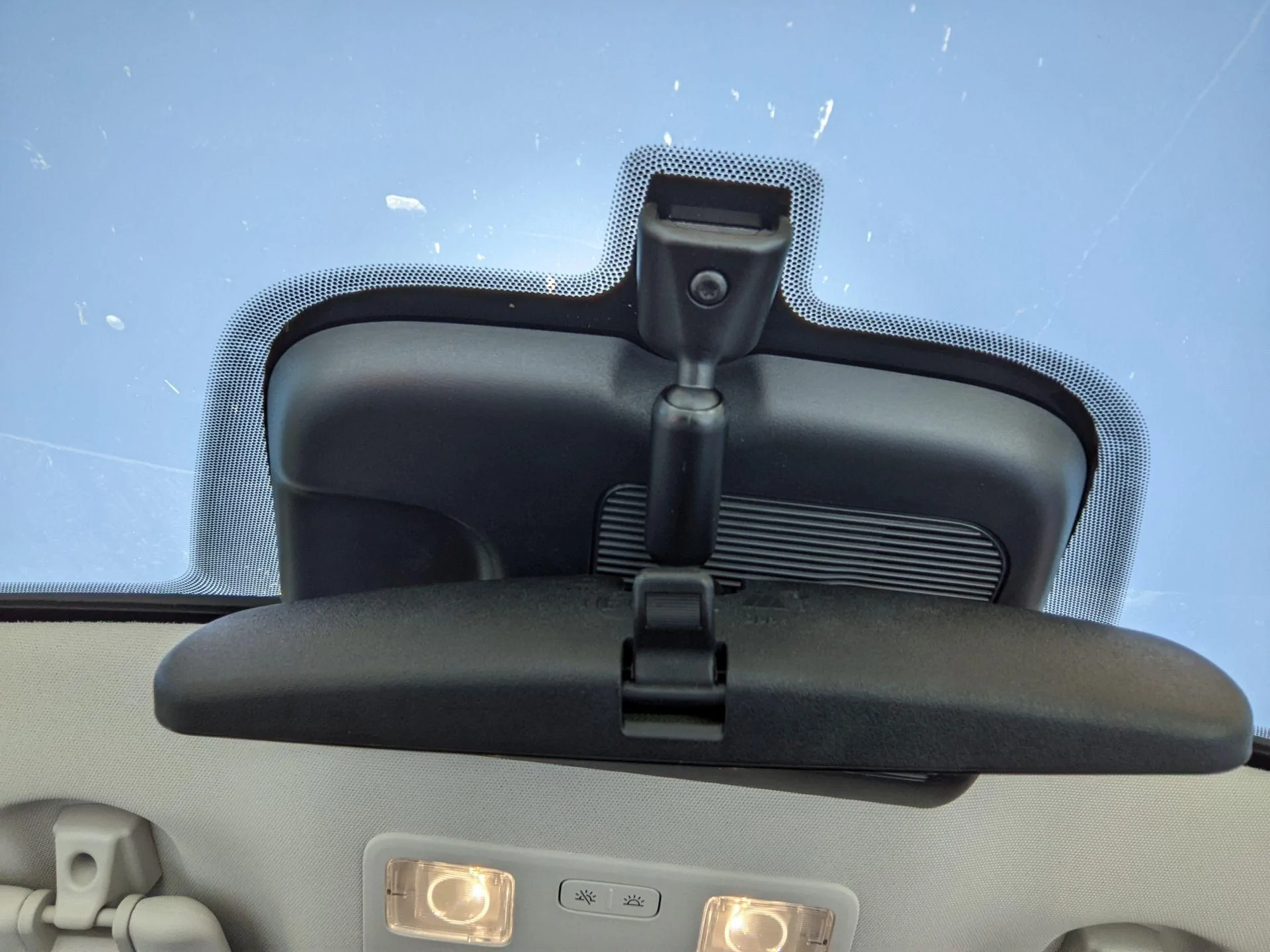

I intend to tackle this probably over the coming couple of weeks. The plan is to cut the OE Ford mirror stem halfway between the joints, and extend the stem an extra 3 inches with a carbon fiber tube that I'll epoxy join to the two metal stem sections. For clamping pressure on the ball joints there likely is a single spring in the center of the stem to which I'll add a suitable spacer, or I'll get a longer spring with a slightly higher overall spring preload. Epoxy adhesive on properly prepared surfaces should be sufficient to hold the spring tension without additional mechanical fastenings, screws or dowels are not an option here.
The OE Ford mirror stem is a tad over 3/4" in OD, I'm measuring .765" or so, which translates to 19.5mm. It turns out to be easy to find 20mm ID carbon fiber tubing with 1mm wall thickness so that's pretty much perfect. Just search on Amazon or Ebay.
I'll post on here when done, and if it worked ok or if it was a disaster!

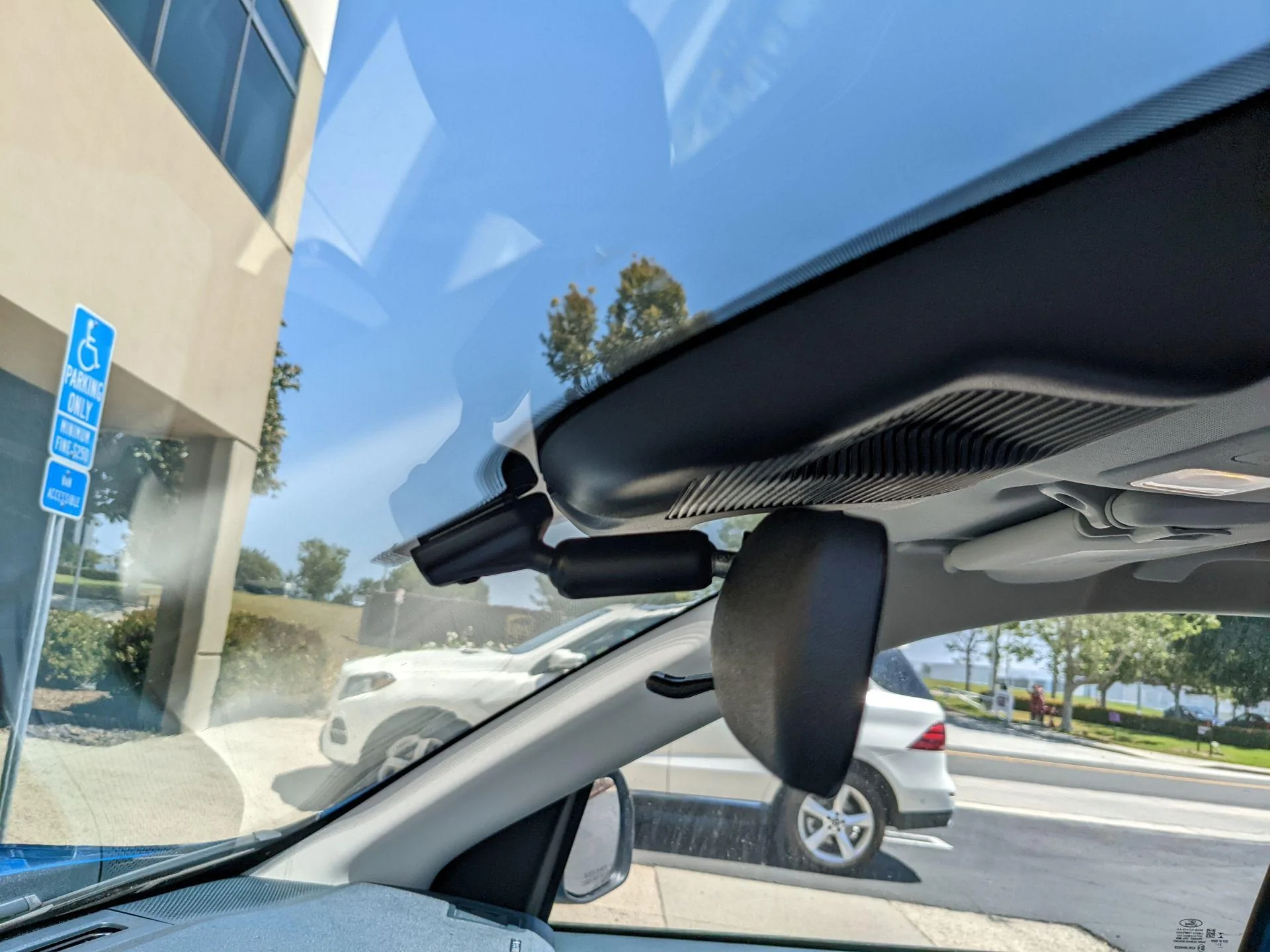

@haze10 No need to apologize at all. And I much appreciate your feedback.
Question: what makes you think that extending the stem won't work?
I too have the driver assist electronics/camera in that console.
When I looked at mine I concluded that extending the stem 3 inches would result in a significant improvement as it would raise the mirror overall roughly 2 inches, but only with the stem "hugging" the plastic console. I may add a simple support between the plastic housing and the stem if it ends up vibrating too much due to the increased overhang. Have a look at the side view picture in my original post on page 1 of this thread.
It has been a while since my review though and I'm curious what made you conclude otherwise.
