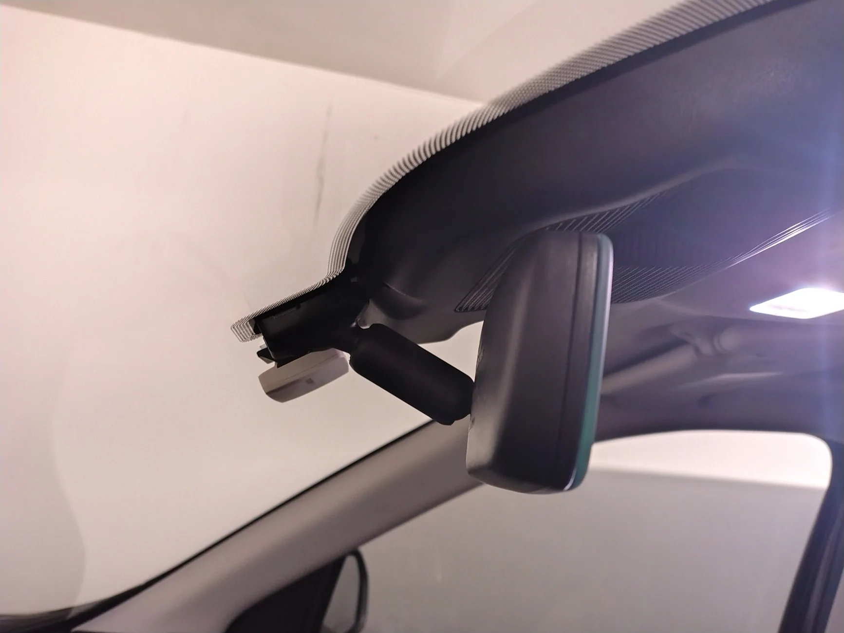

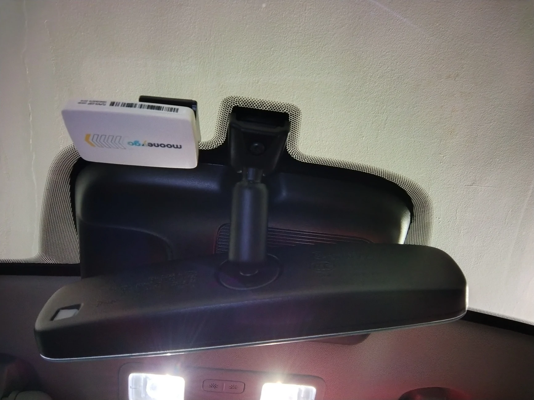

Looks great and your wiring job looks good too. A DIYer after my own heart. Could you take a picture a little further back to get more of an overall look of the mirror with the interior?
Ford Maverick Mach-E Frameless Rearview Autodimming Mirror - install DIY 1000019196
Ford Maverick Mach-E Frameless Rearview Autodimming Mirror - install DIY 1000019197

You said you bought one from aliexpress????
I just found this on AliExpress:
1 Set 5 Pin 2.54mm Car HUD Electrical Cable Connectors Female Male Wire Harness Plug For 31072-1070 31072-1010
https://a.aliexpress.com/_EuapXeW
1pc For Ford 2019 Focus edge BCM-F Plug Connector C2280f 72pin wire
https://a.aliexpress.com/_EjH25Vc
this two things i bought from aliexpress the pin for the BCM and the conector for the mirror plus the wire.
