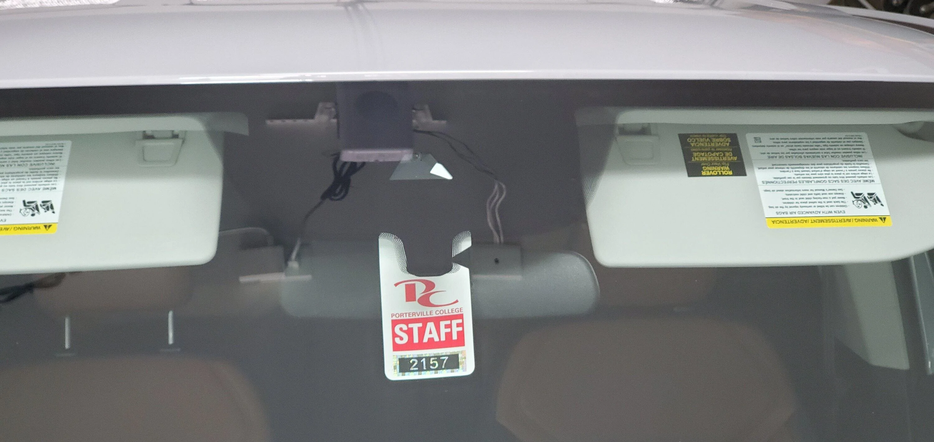

Anyone know how to get access behind rearview mirror?
rdnbrbk
Jimmy
May 31, 2022
59
Tulare
2022 Cactus Lariat 2.5L

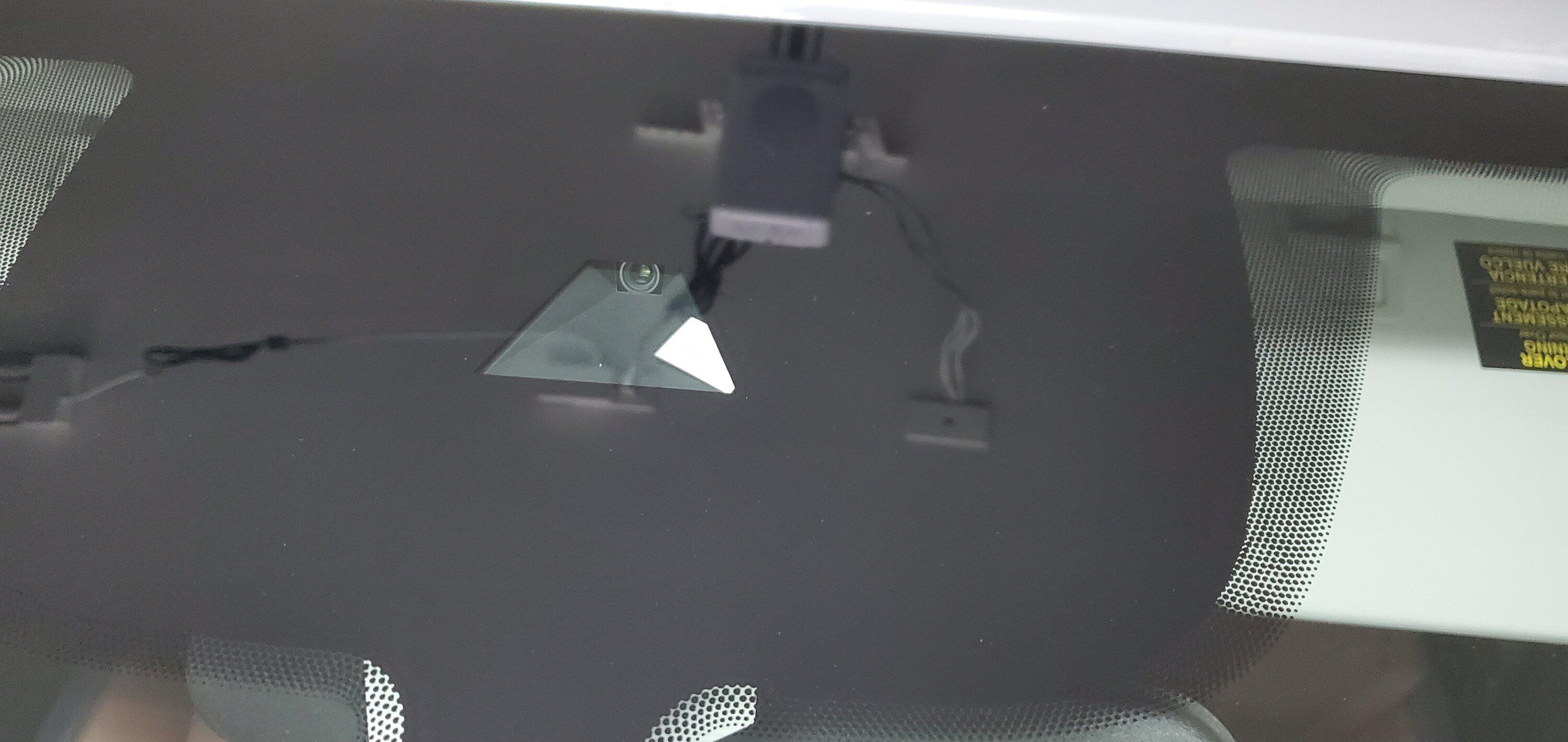

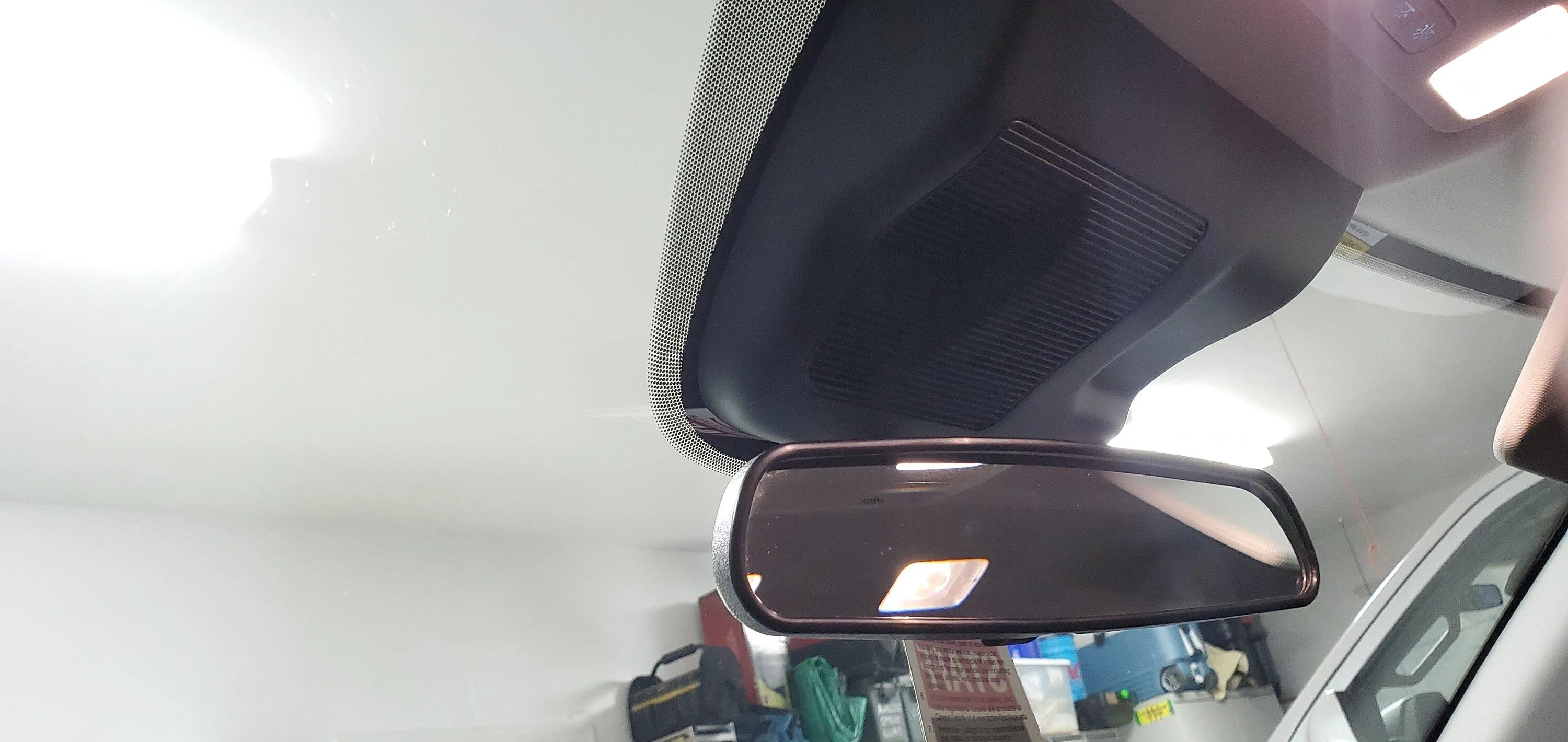

as you can see in the picture something has fallen down in my fear might interrupt with my forward facing camera or whatever that sensor is having to do with the whatever else it is doing. My question is if any of you know how to remove this panel behind the rear view mirror to gain access to that area and remove that white piece of paper or whatever it is??

I think that is sealed to the windshield. Probably need to go to the dealer.

That‘s going to be tricky. I have that cover off mine for some radar detector wiring. The camera is mounted to the large plastic piece that I’m sure is glued to the windshield.
I popped the camera out, but there really isn’t access to the area where the foreign object is.
My guess is that the dealer, or an independent glass shop you trust can correctly remove / replace the plastic panel and remove the object.
Good luck!

OP, are to talking about removing the large black plastic cover in front of the rear view mirror? If so, just wedge a cheap panel tool or something else under the rear corner and pop it off, it comes right off easier than expected....
