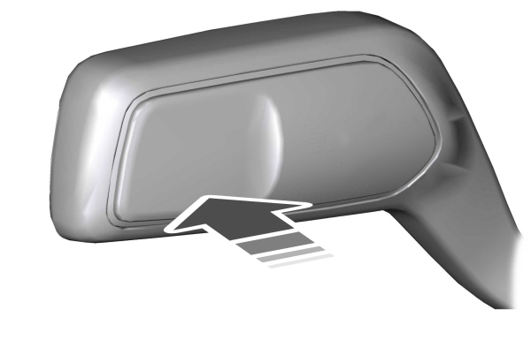

Not sure if the 2026 works the same but this works on my 2024 Lariat. I can "defeat" the auto high bean without going into the menu.
OVERRIDING AUTOMATIC HIGH BEAM CONTROL
Ford Maverick -- imagen2
Push the lever away from you to switch the high beams on.
Push the lever away from you again to switch the high beams off.
Push the lever away from you for a third time to switch automatic high beam control back on.
