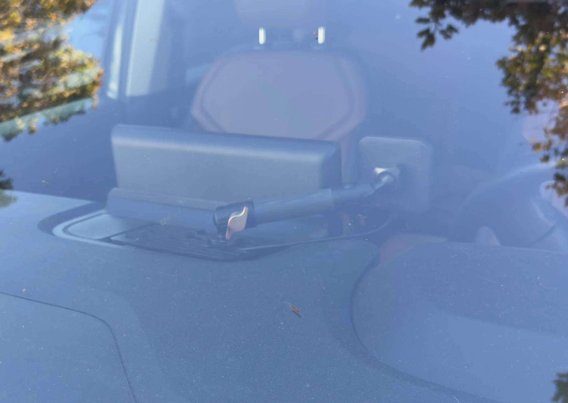

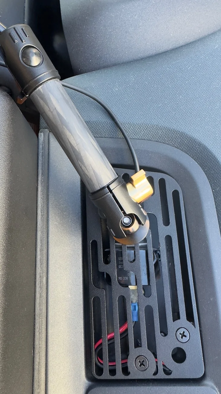

My phone mount is similar to yours. I swapped the included mag mount for an ESR MagSafe charger. Wireless charging and it’s a very strong magnet. That’s why I’m thinking the sideways mount inside the tray should work. It’s only 1” wide (tall when sideways)

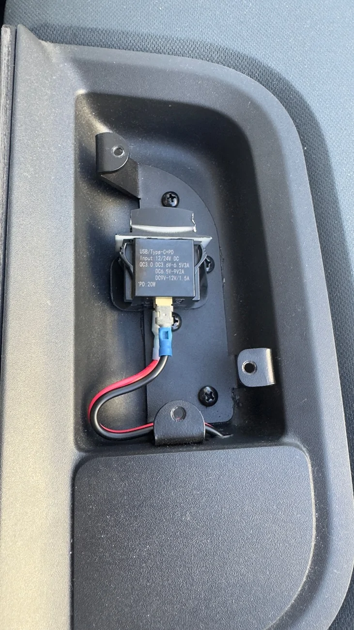

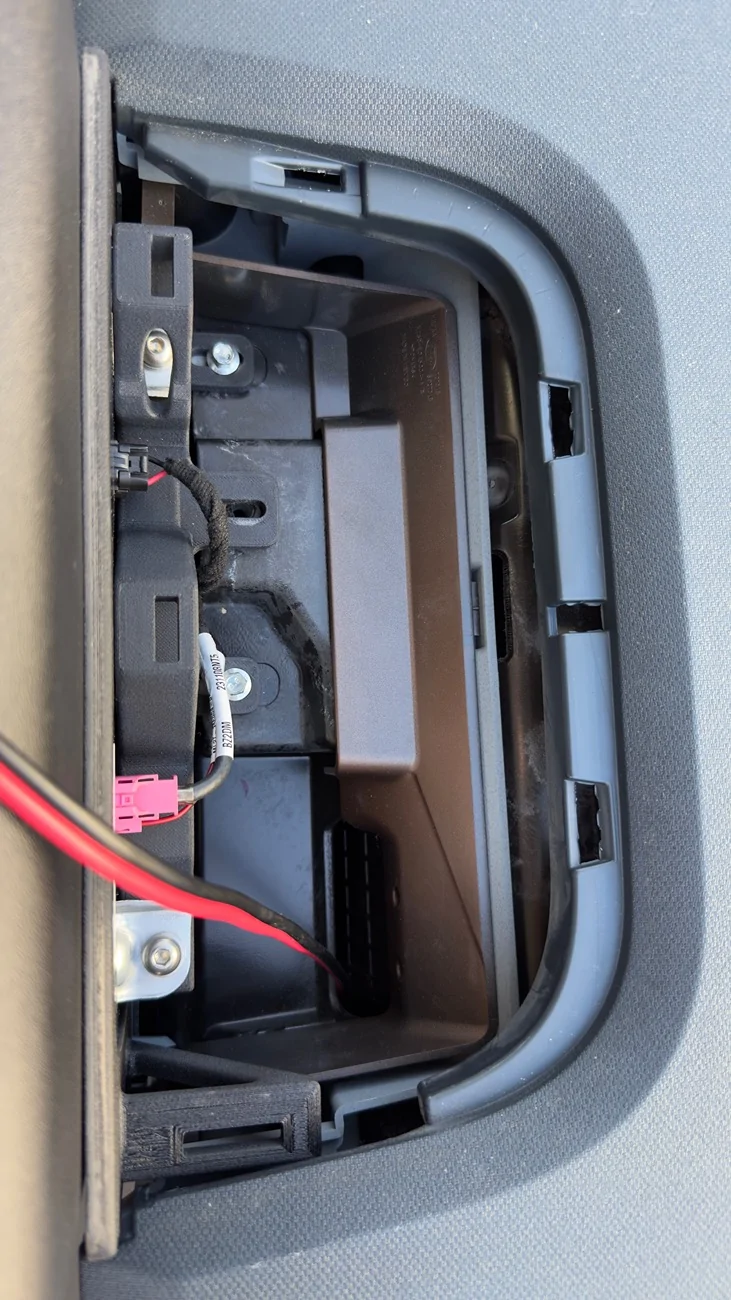

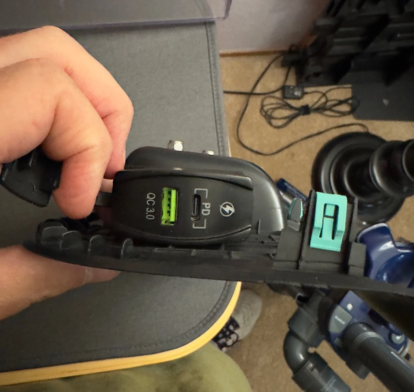

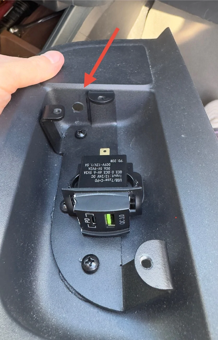

@Mavreezy Here’s how I ended up doing the USB charger up top. My bracing was in the way too - once I took the top off, I had to think of other ways. I trimmed the cosmetic edges of the charger and it still wouldn’t fit, so it became a surface mount inside the tray. Lol
Ford Maverick 8" screen (Sync 3) upgraded to 12" screen (Sync 4) IMG_3330
It'll totally fit...
Ford Maverick 8" screen (Sync 3) upgraded to 12" screen (Sync 4) IMG_3335
Nope. Even with trimming the mounting brace is in the way. So, I just ran a hole for the wire (straight drop to the fuse box)
Ford Maverick 8" screen (Sync 3) upgraded to 12" screen (Sync 4) IMG_3336
Ford Maverick 8" screen (Sync 3) upgraded to 12" screen (Sync 4) IMG_3337
If you know it's there and are looking for it, you see it. Otherwise, invisible.

Oh nice! You did a great job installing the USB connector with minimal space 👍🏻.
I'm looking into doing something similar. I need to find a good location to install a USB-C connector.
You're getting power from the fuse box, correct?
Yup. Dropped the 18AWG straight down to the fuse box, gave it some extra in case I need some flex to remove the top tray again, but otherwise tied it all up and did a fuse tap on Fuse 3 (for mine, just the auto-dimming mirror).

I will still keep an out for a smaller USB form mount. This was a std switch size and still too big. It does have both USB-C and USB-A with PD, so it fits my needs. I'd be OK with a small extension mount for just USB-C in the tray and this or another charger double side taped to the empty cubby space too. That would be tiny

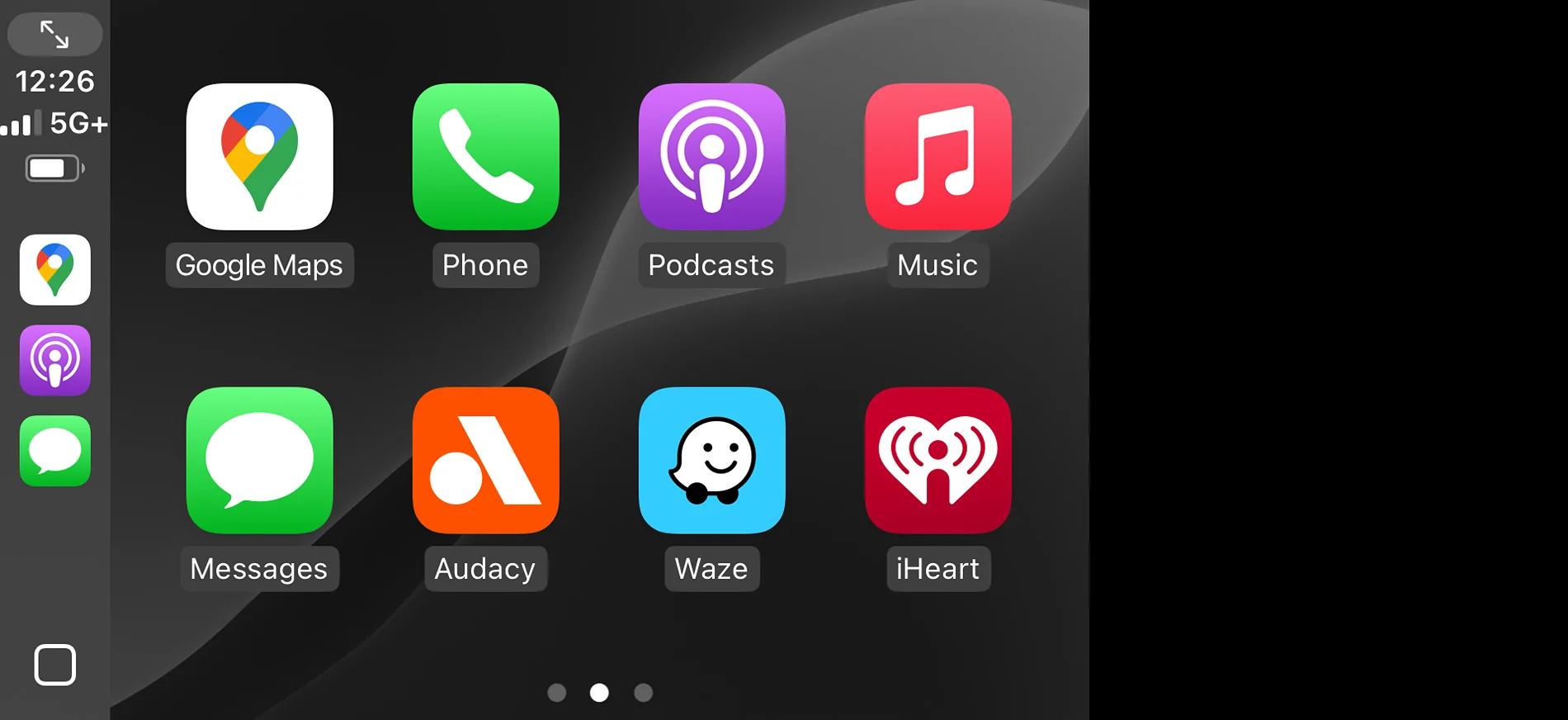

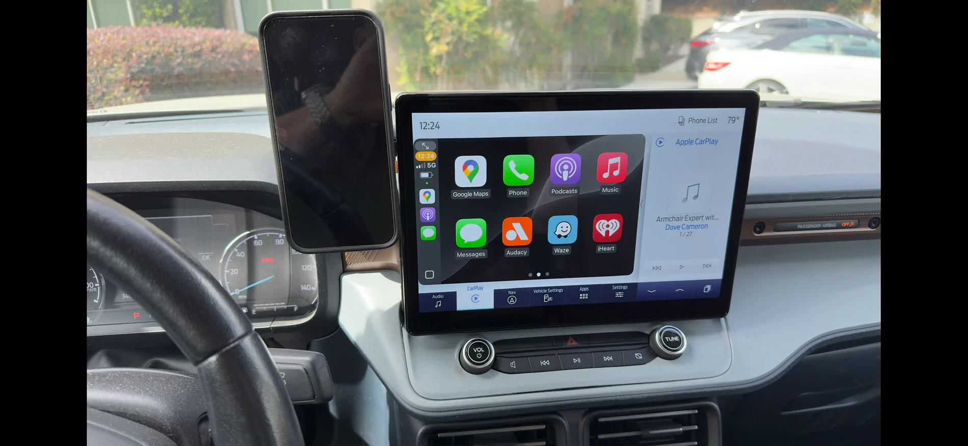

Anybody that has done the mod conversion update have you tried your CarPlay to see if it updated to the new widgets.
I just bought the Ottocast to do CarPlay and TV, etc. however when it links up it doesn’t give you a full screen CarPlay, and there’s no way to full screen and widgets don’t show.
Not sure about new icons. Here are pics of mine in full and shared screen mode
