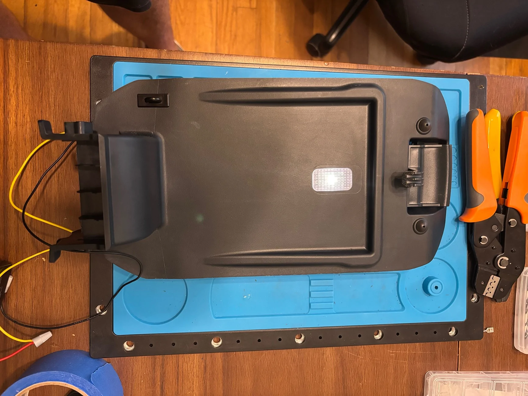

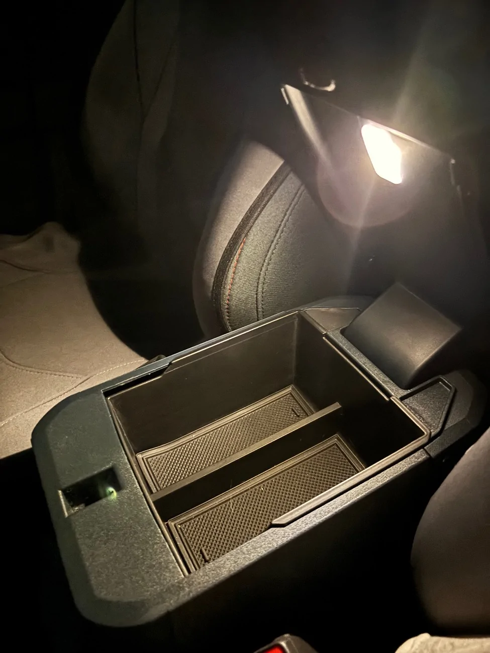

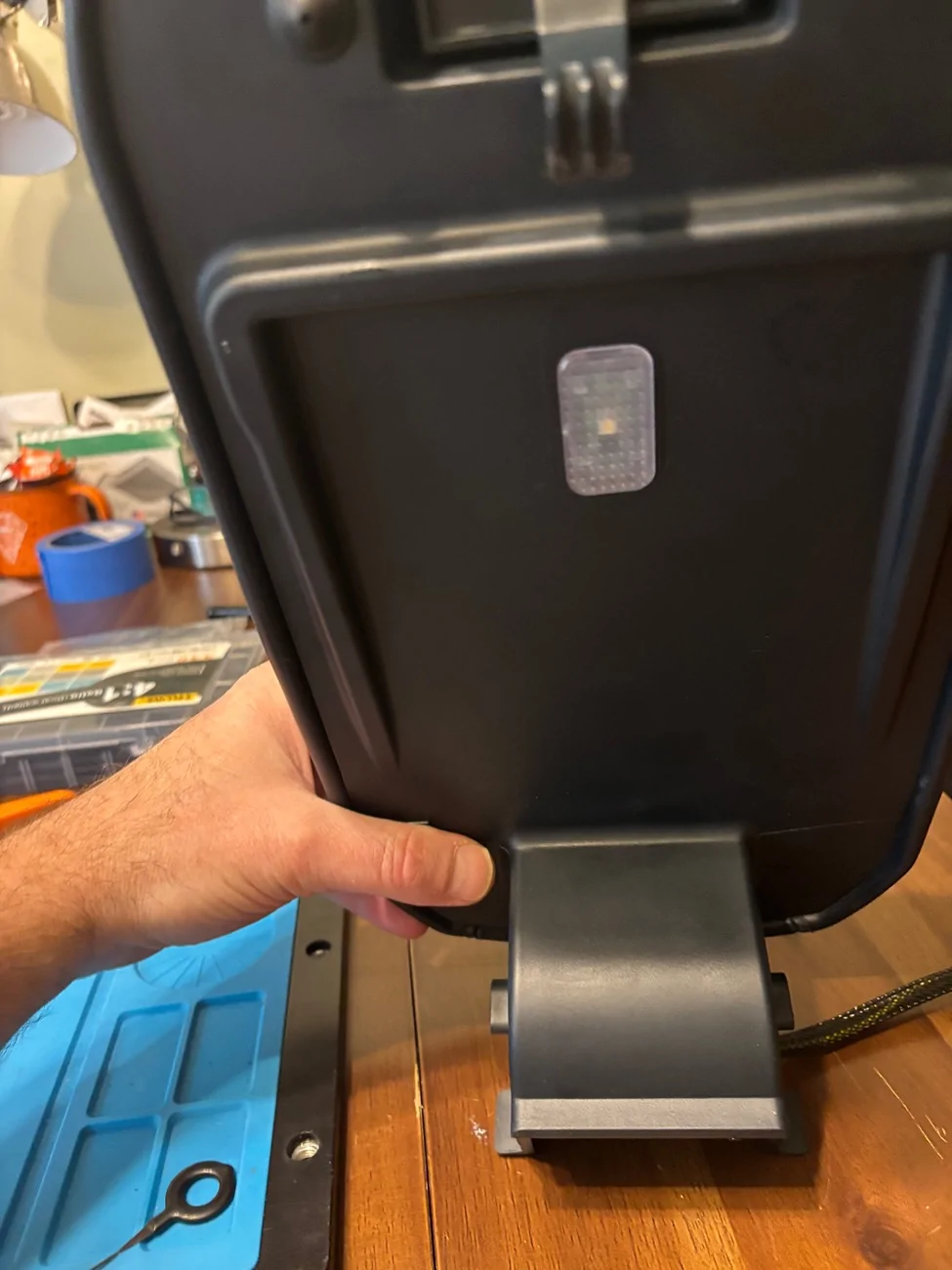

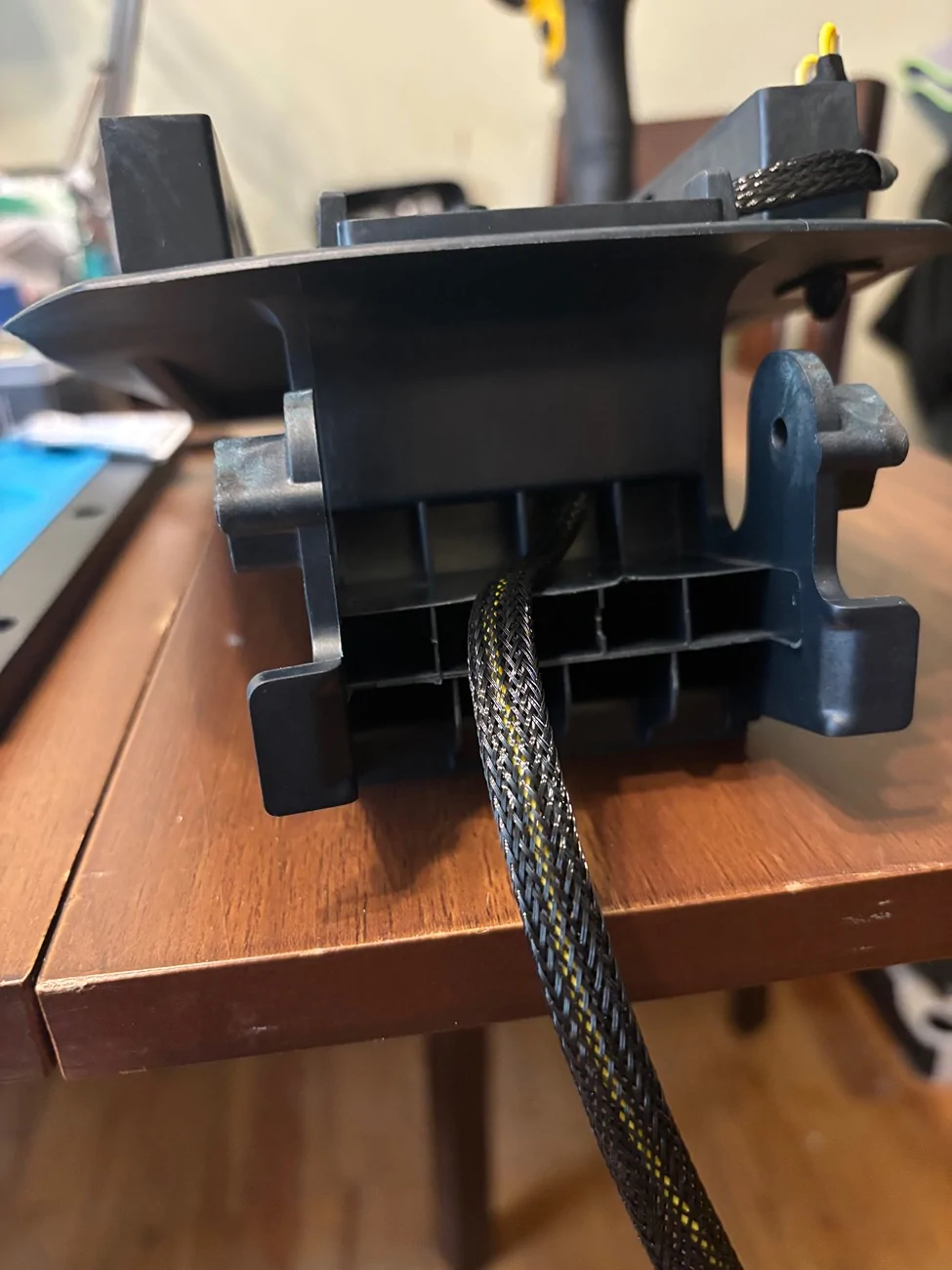

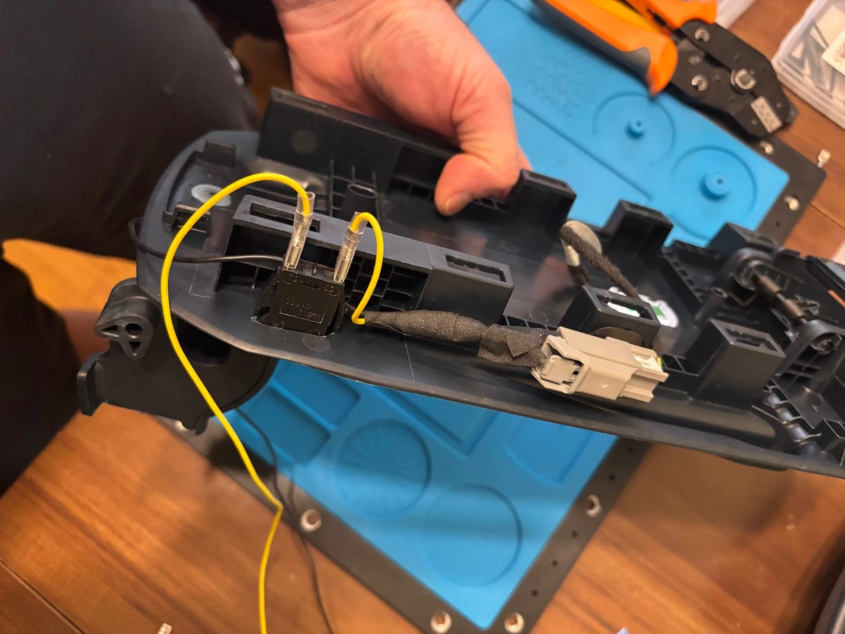

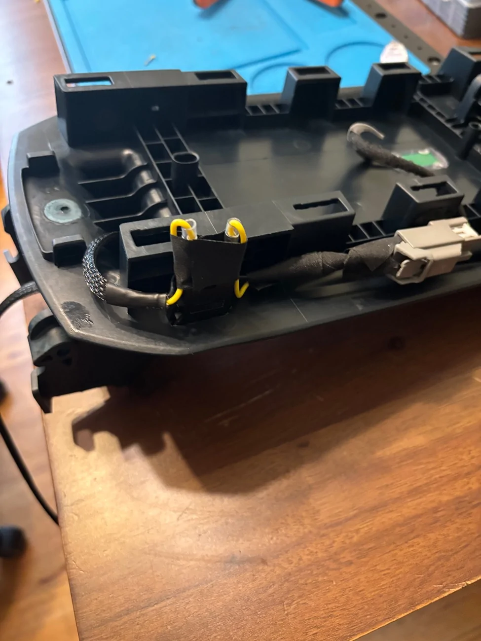

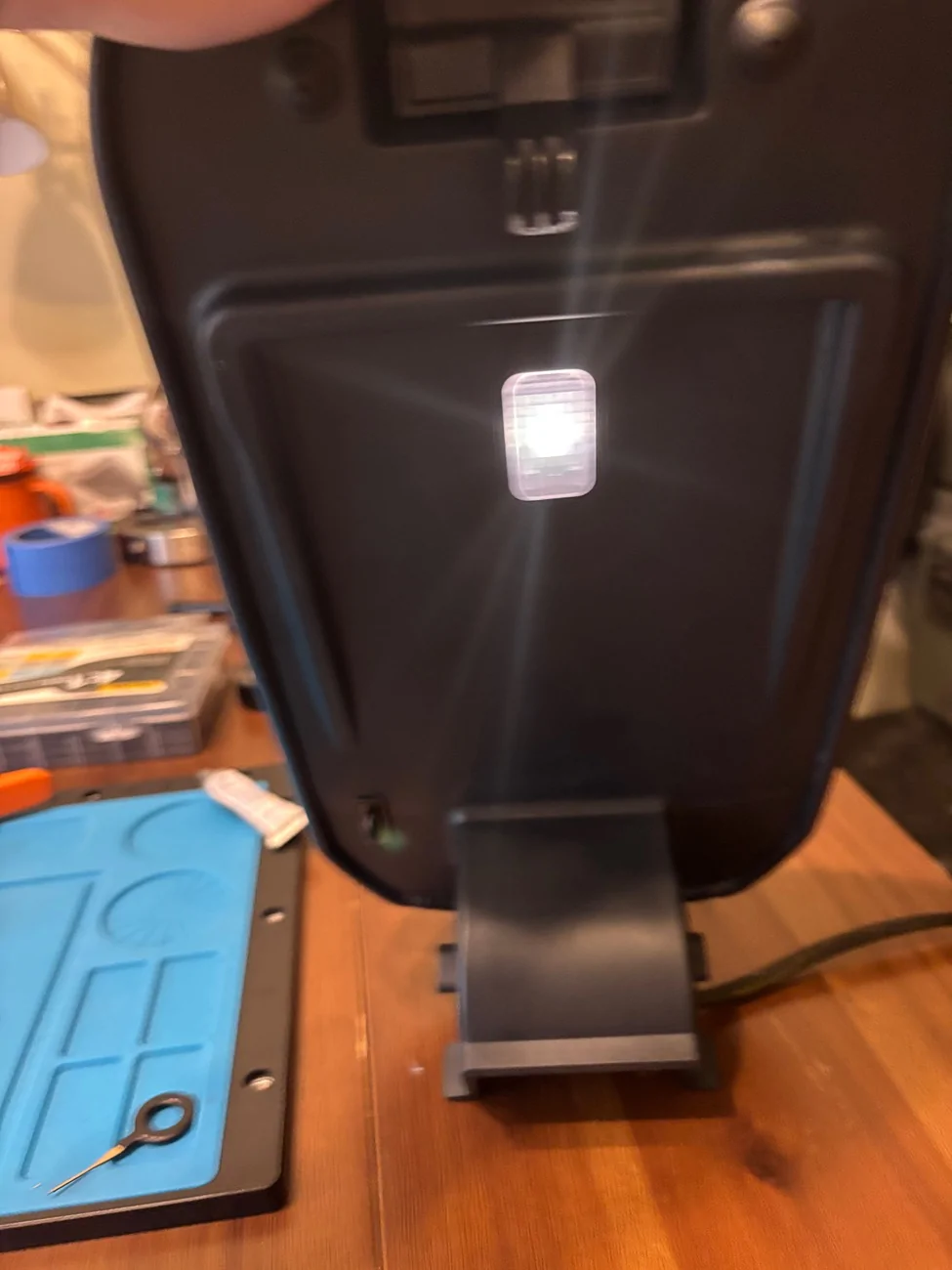

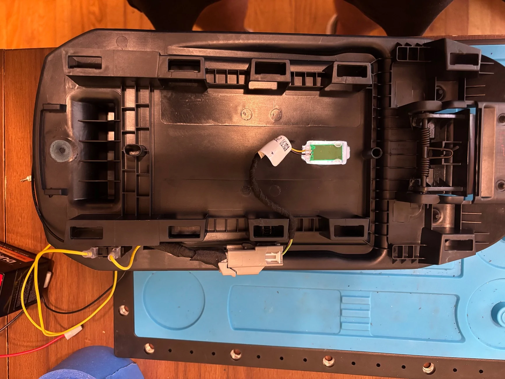

Basically copy / pasted the DIY glove box light to my center console lid. Lincoln glove box light and a KIA switch. Under seat storage is next using Ford luggage lights and KIA switch. Tapped F20 in the BCM to power glove box light, center console and under-seat.

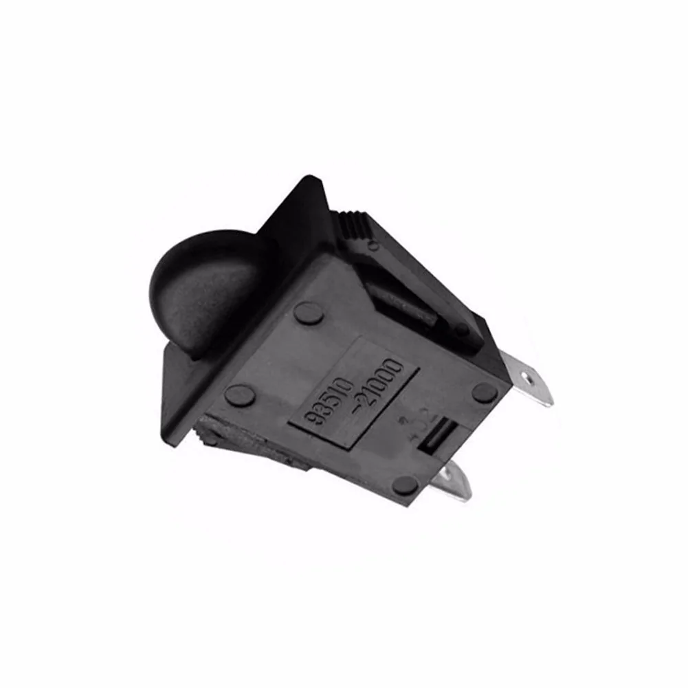

The crucial part is the KIA/Hyundai switch that works really well as a open/close on/off switch:
Part# 98510-21000
Ford Maverick Center Console Lid Light (DIY Install) 51xGLaLyv9L._SL1001_
After that you can use any 12v glove box light that will fit. I went with Ford OEM just because I like to pay a premium for Ford parts.
I used LC5Z-14A411-C for the center console and LC5Z-14A411-B for the glove box.
If you buy a Ford lamp just make sure it is a 2 wire lamp and not a 3 wire lamp. 3 wire lamps are controlled by data from the BCM.

LOL, Yeah, I put my cell phone inside the center console and recorded a video to make sure it was turning off. I also added a 3M rubber pad where the switch contacts the console base. The KIA switch is pretty great it opens the circuit with just the slightest of pressure. I could have tapped fuse 1+2 which are hot only in Run/Start but decided to use F20 hot at all times. I should be okay power wise unless I forget to close my glove box for a week.
