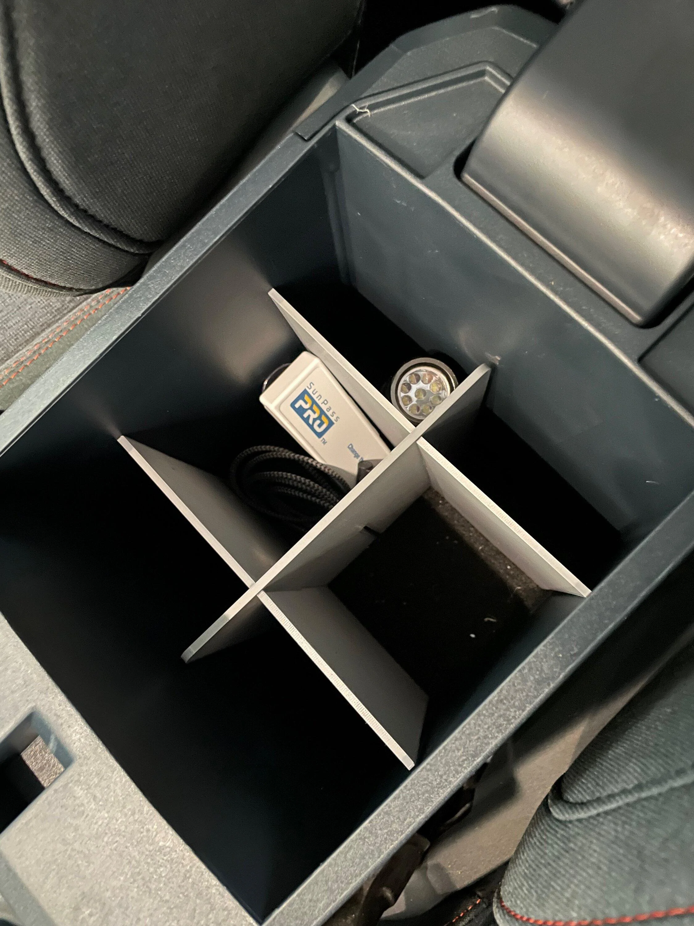

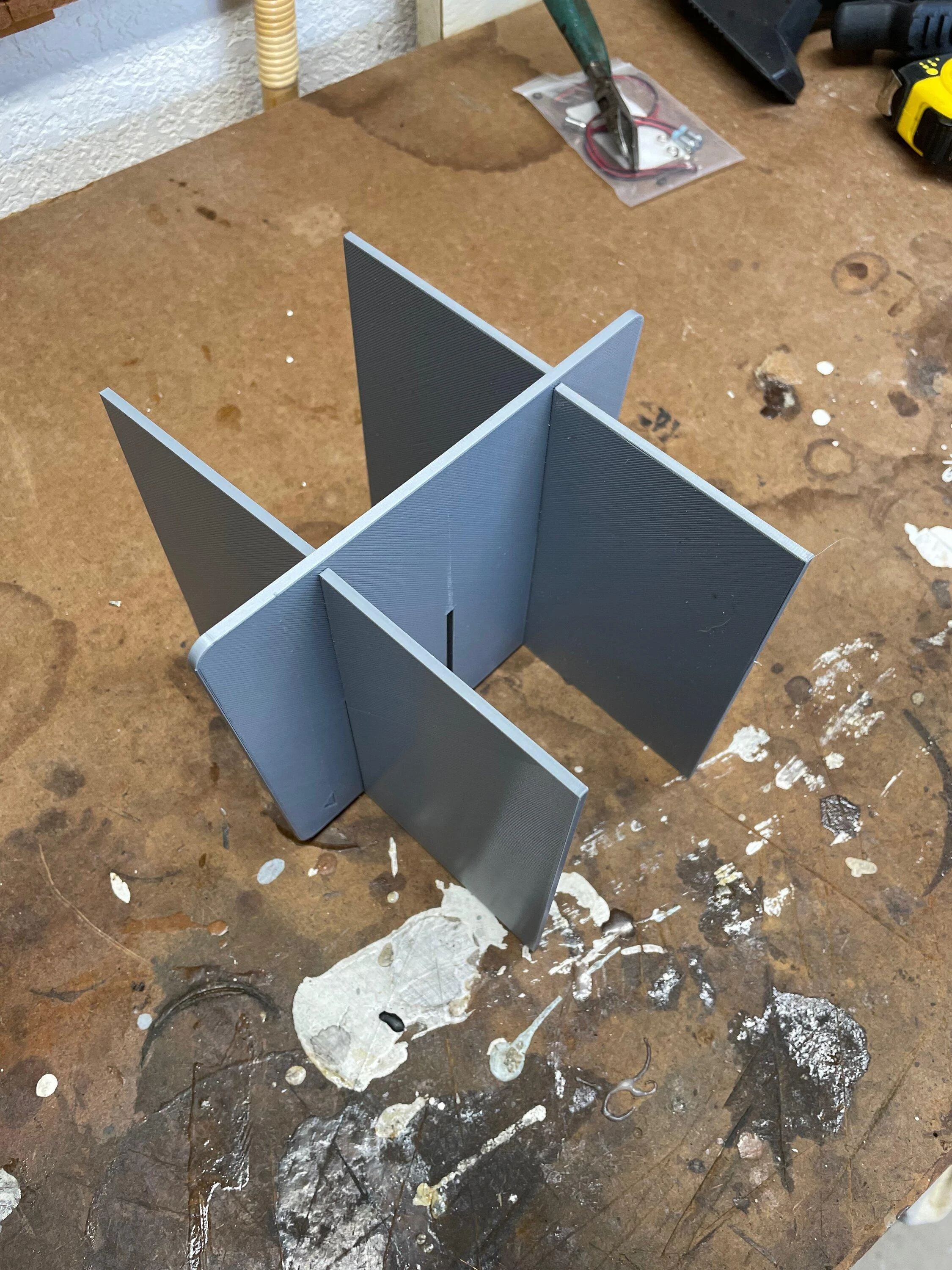

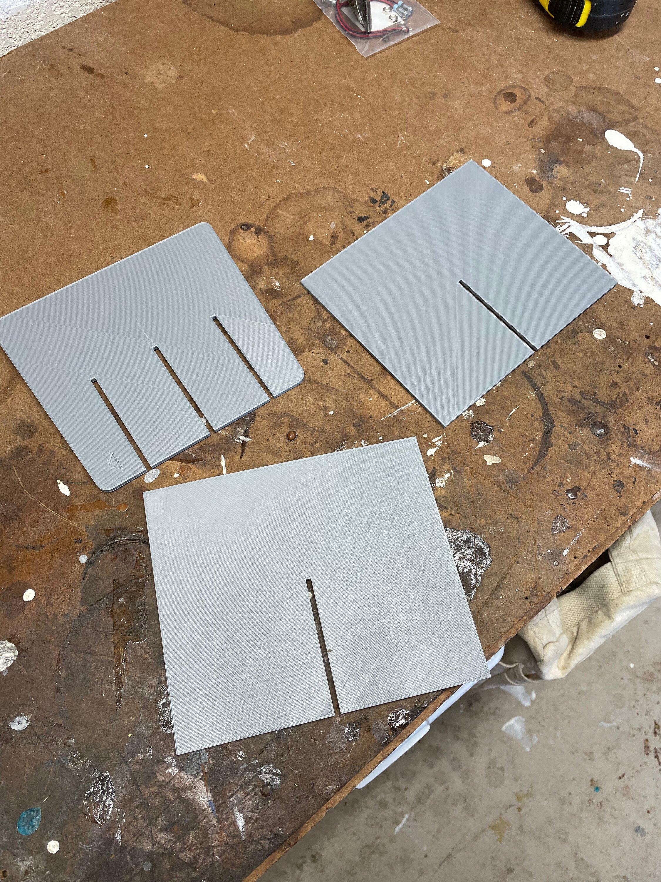

So I made this 3D-printed divider system to help bring order to the vast pit that is the Mav's center console. I printed this first version in PLA+ but it remains to be seen if it can hold up to the Florida heat. I'm probably going to re-print it in PTEG, too, just to be safe.
The files are attached for anyone that wants to print their own. Because the two side pieces are wider than the opening at the top, the three pieces must be assembled in place in the console. Simply put the side pieces in with the slots facing up and then ease the center piece down into the matching slots to lock it all into place. The center piece has a third slot so you can vary the size of the cubbies to your own needs (or even print a third side piece to make a total of 8 skinny cubbies.
There's a little arrow embossed on the center piece to point forward. It fits just a bit better that way.
Needless to say I'm happy to share this with the community but I retain all rights -- I grant you all personal use of this but don't be a jerk and try to profit off of it. If anyone wants one but doesn't have a 3D printer give me a shout and I could probably make and mail you one for a nominal fee.

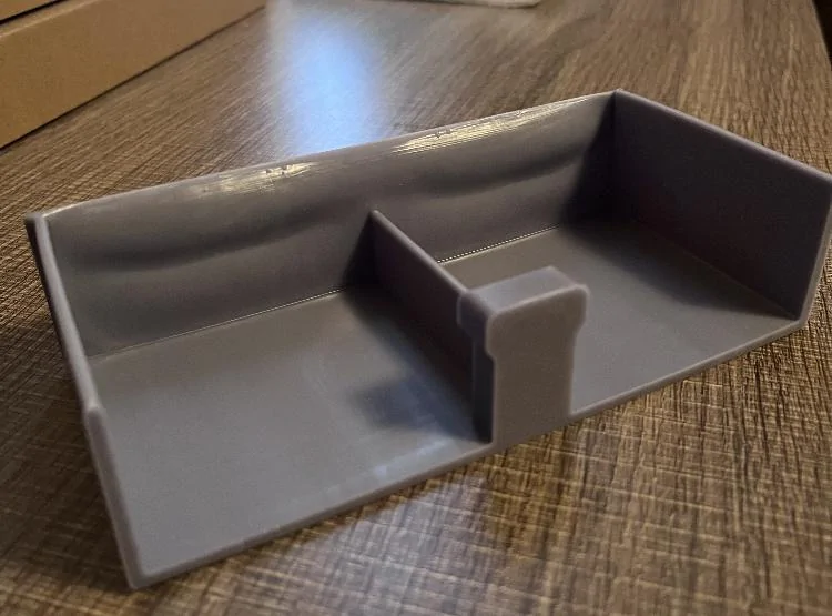

Sent me pic of half the tray (will take two prints and then glued together?)
