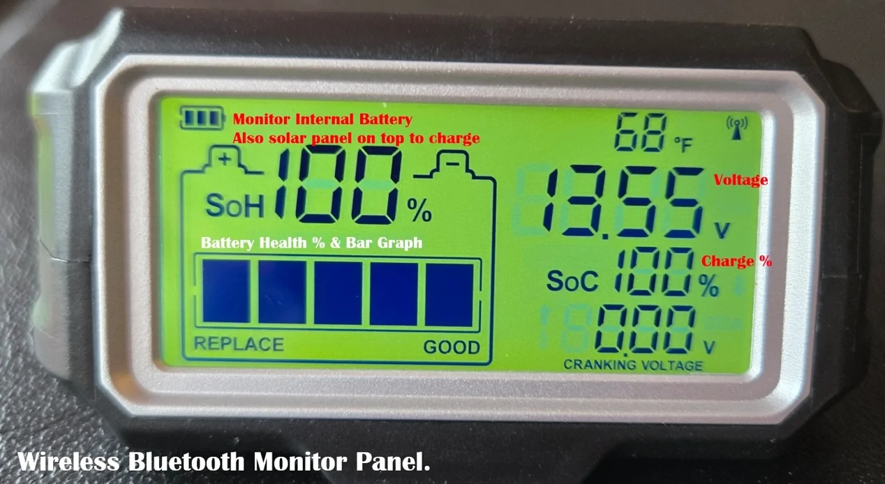

Bought a battery monitor set that has a remote BT monitoring panel. Easy attachment to the battery in 2 minutes. Monitor panel can go anywhere within 30'.

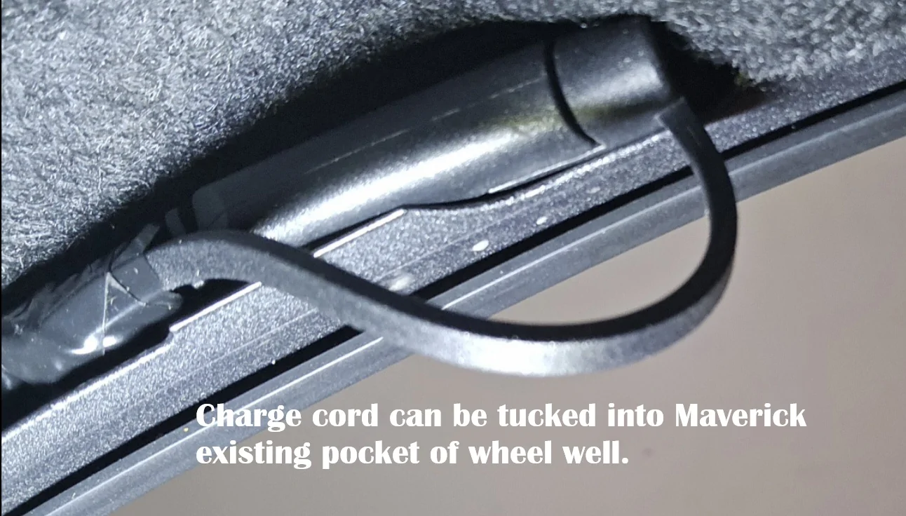

Photos are below on complete easy installation which took 20 minutes to figure out best way to install. I used the plug-in connector and attached to the primary battery terminal under the hood. Was also able to route the connector out the left front fender well for charging when needed. There is also a little pocket in the fender well around 10 o'clock that allows the cord to be perfectly tucked in for storage.

1. Yes,I keep the display on the tonneau back corner so I can view the voltage before opening doors or the key getting triggered. When driving I put in the console to monitor the battery. Will continue to keep external until I know the trending and behavior of the truck charging/rundown. My thoughts are to eventually just put the remote battery display on the garage wall by the driver's door to check before getting in, and after getting out and all lights go out. That will let me know if I need to plug in the battery tender.
2. The primary battery starts getting charged after 3 seconds from turning on the truck and still in Electric mode. Even with no gas engine sound, the EV battery starts charging the primary while driving away from home slowly in Electric mode. The voltage goes up to ~14.5V right away after vehicle is turned on.
3. This monitor does NO LOGGING, only realtime. There may be more expensive units to chart the variances.
4. The ultimate goal is to only plug in the battery tender when I expect the truck to sit for 2+ days.
Note - The CRANKING VOLTAGE on the display still reads Zero after driving 6 times, probably because the voltage level doesn't drop enough yet with a new battery to be recognized as a start event. Also, the truck always goes into electric mode after turning on (and starts charging the primary battery). The gas engine rarely runs initially after vehicle turn-on.

CRANKING VOLTAGE will not show as the 12v battery is not used to crank the engine, it uses the HVB for that. Also the ICE charges the HVB, not the 12v. The HVB charges the 12v via a DC-DC inverter.

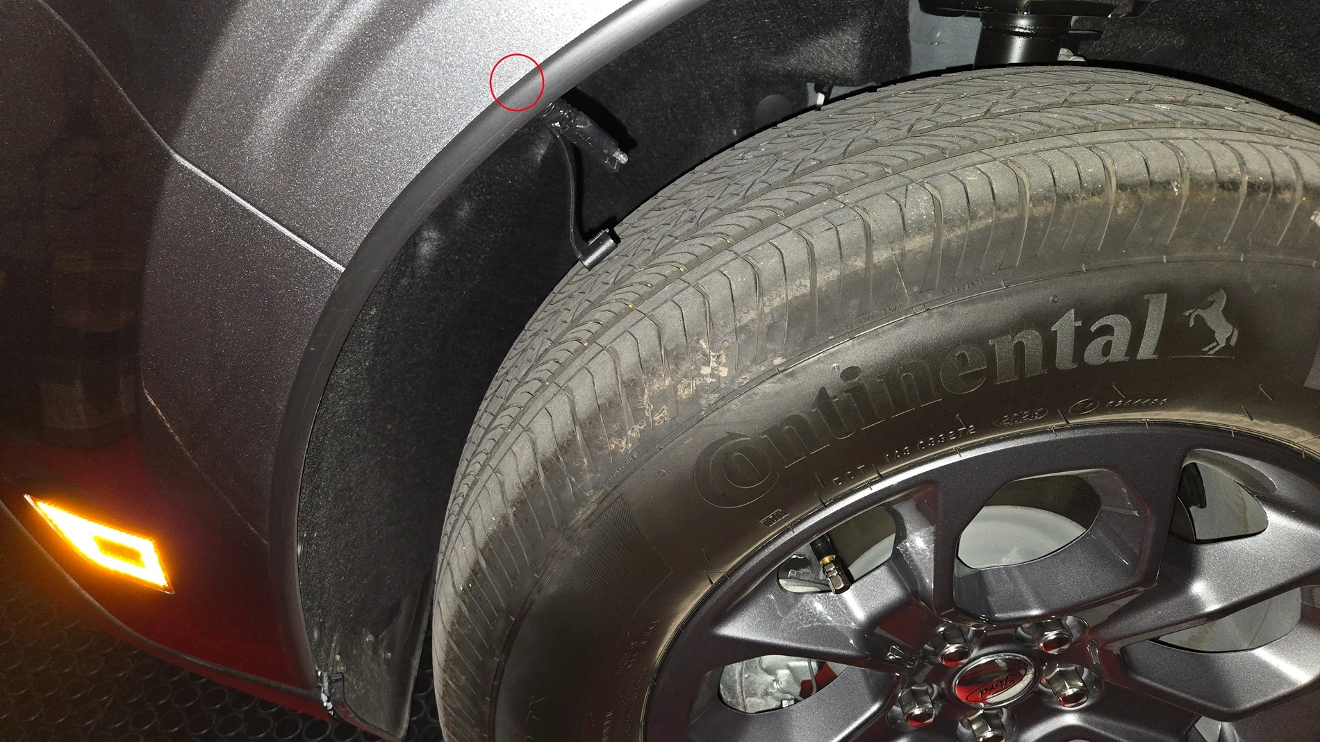

Can you take a better shot of where the charging cable exits into the wheel well from the wheel side? I can likely poke around and find it but a picture is worth many words. You have a shot from the inside where the cable goes under some insulation - was there just a hole there you used?

From what I have read, the connection you have made to the negative post needs to be moved to the other side of the bms so the bms can measure any current the monitor uses. To prevent the bus from miscalculating. The bms should see all of the current you add while charging but the current used by the monitor will disappear and (possibly be considered internal shorting in 12v?).

This remote/BT added only uses 2mAh (48mAh per day), so I don't have much concern of current draw from the monitor device tainting the BMS calculation.
If Ford were more precise on their battery usage and charging calculations we wouldn't be dealing with any of these battery replacement concerns.

1. On my 2025 there was a small 3/16" gap in the inner felt fender well that I could see light through. (See photo). I fished the charging wire through this gap. The end connector tucks quite nicely into the indentation of fender well at that location. If you run your finger along the inner fender well you'll find the indentation when the wire can be routed through.
2. The lead wires on my tender were also short. I spliced in another 5 feet of wire so no extension cord is needed.
Thanks for that - I'll poke around and see if my 24 has a similar opening!
Correct, the 12V battery can be charged, jumped or replaced. The concern is the HVB, it will self discharge. Ford recommend running the engine for 15 minutes every 14 days if the vehicle is not being used. Not practical if you are out of the country for months at a time!
