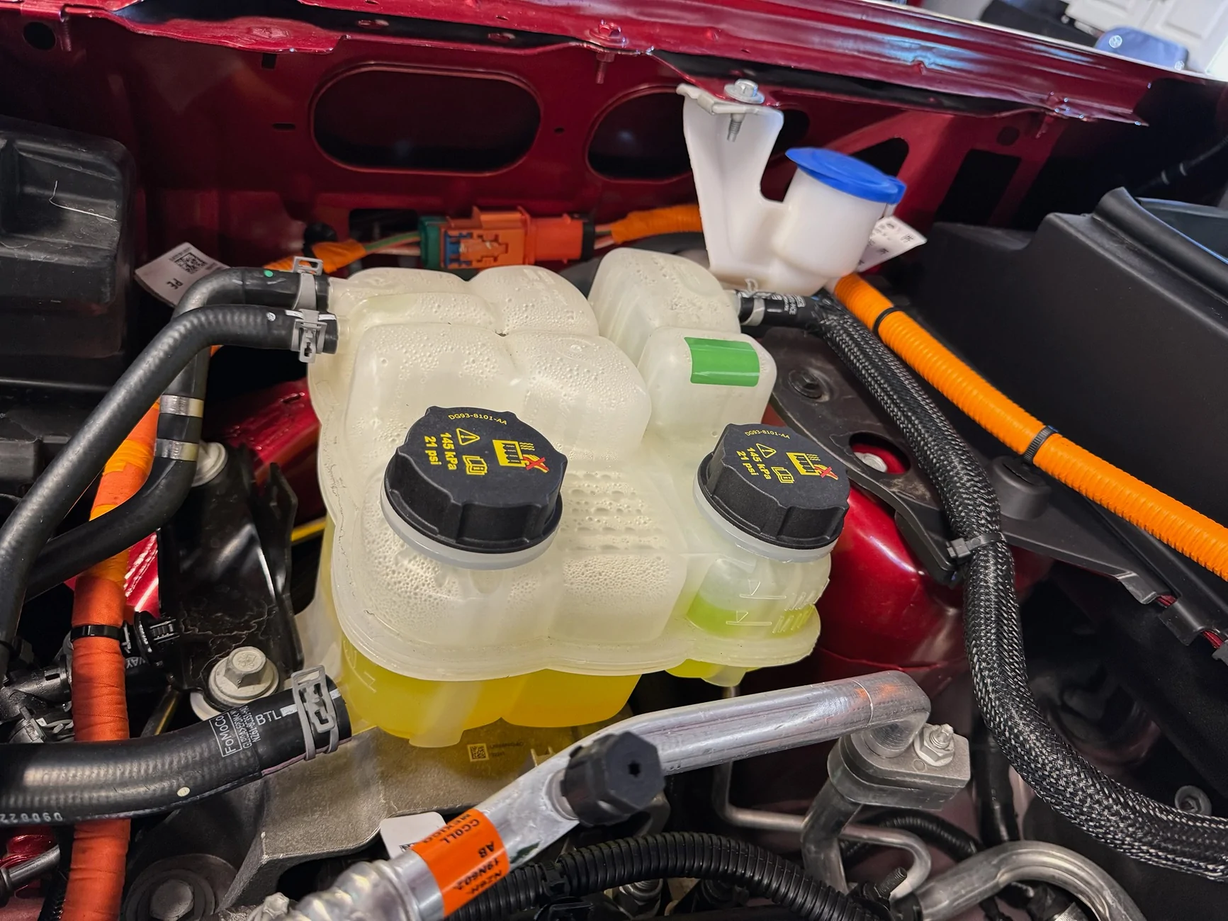

My FORD dealer refilled both cooling systems on my hybrid with green coolant. It's not yellow.
That could be a problem or undesired - as the 25MY is the same coolant spec'd.
Is it a problem? Depends if that was Ford green

Glancing at the chart you get a quick sense regarding the Ford green - if that's what it was.
25MY spec.

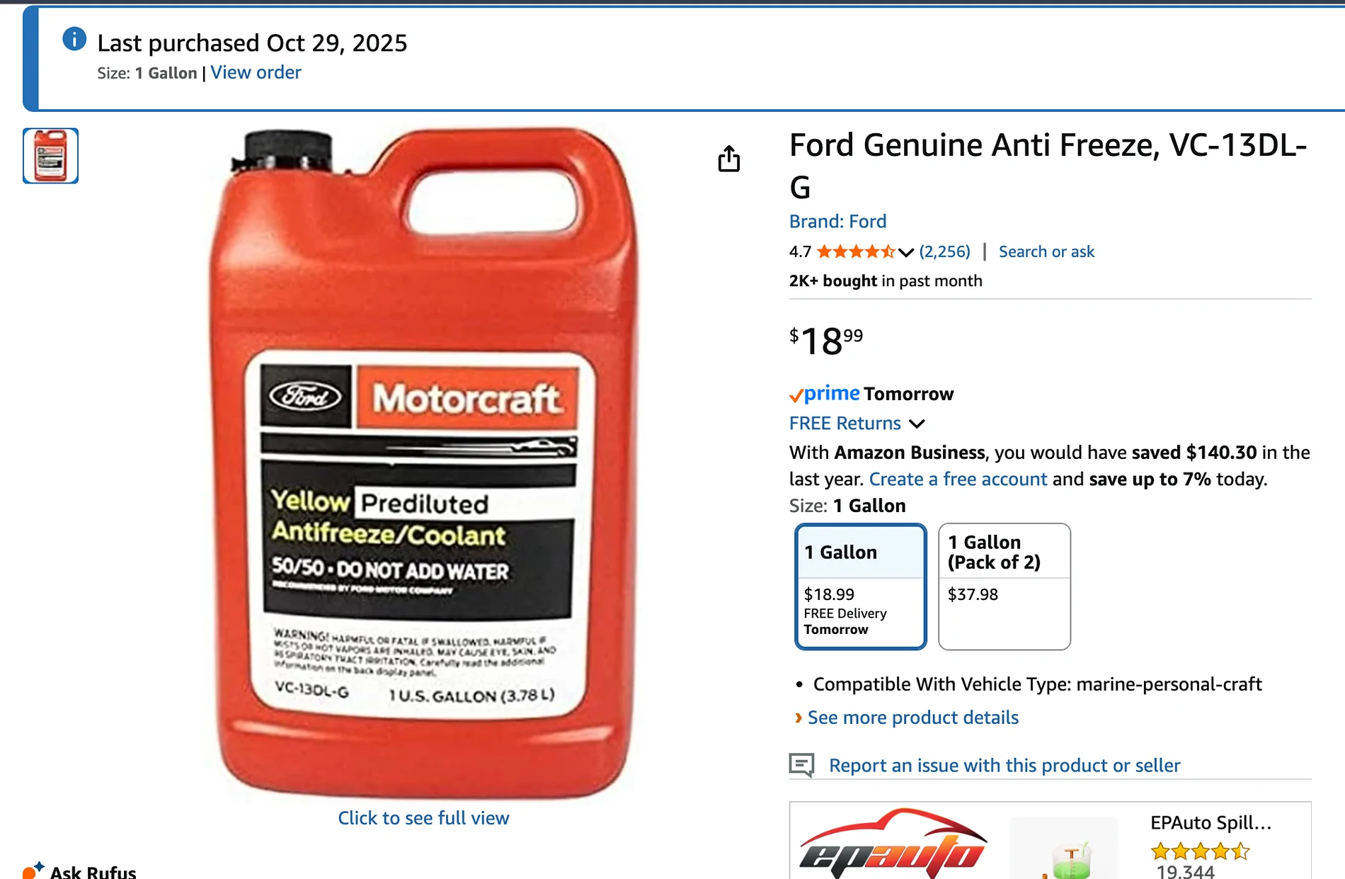

Motorcraft® Yellow Prediluted Antifreeze/Coolant
VC-13DL-G
WSS-M97B57-A2
Note: Yellow coolant may become darker over time. This is normal.
