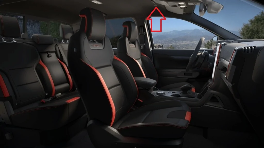

I just came across the Ranger Upfitter Switches for what I believe will replace the sunglasses cover in the overhead console. I know the Ranger has the same overhead console as the Maverick and Mustang. Just wondering if anyone else has installed these. I just ordered mine for my tremor. I was originally going with GM switches, but I prefer the stock OEM look.
UPDATE: The kit does fit the Maverick. Just need to accommodate for the illumination wire tap.
Ford Maverick Upfitter AUX Switch Kit for Ranger fits the Maverick 1760707902437-d
Ford Accessories - Ranger Switches
Updated with installed look:
Very happy with the kit. The gray is only a very slight shade darker than the Maverick. The kit is great. Includes everything you need. Just have to accommodate for the switch illumination tap.

Do you have to fish the wires though the headliner or a pillar?
It's really not difficult. When you pull the A-pillar cover, remove the sunvisor, it's really no issue. What is also thoughtful of Ford is that there is a second AUX 1 lead that is available near the switches in the headliner if you want to power something like a radar detector, dash cam, radio, etc. AUX 1 also has a lead with the other AUX 2-4 bundle terminating in the engine compartment.
