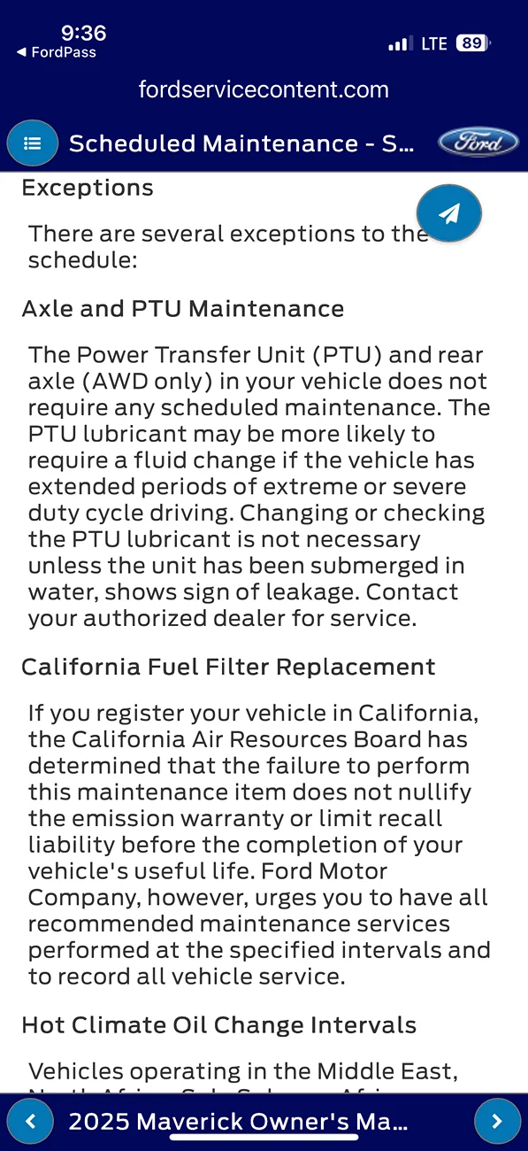

Ford recommends this be done at 60,000 miles if not regularly towing, which i will be doing. 40,000 miles on our 23 mav so far.
Actually the manual says you do not have to change it under normal conditions.
