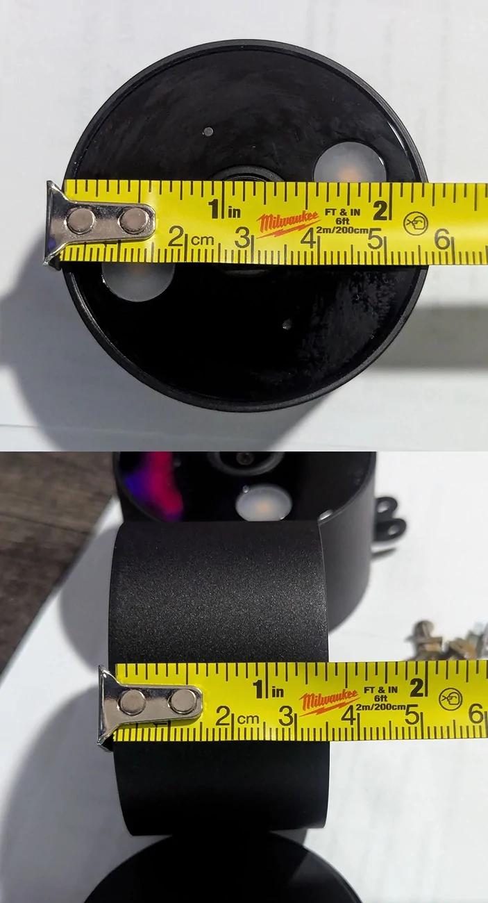

I spent a lot of time searching for the right cameras which has been the biggest challenge. I wanted to do this on the smallest budget possible and there are very few small WIFI cameras that are outdoor rated, support RTSP / ONVIF (necessary for using 3rd party IP camera / NVR software), and are affordable. If I was going to spend $200+ I'd just get an RV / Big Rig camera kit that works out of the box (spoiler: probably will eventually get one of those kits). Anyway, the smallest camera I found that checked all the boxes is the TP-Link Tapo C121 which costs only about $30.
Ford Maverick Installed outdoor WIFI cameras to front grille and truck bed and... 614kwT7k5IL._AC_SL1500_
Ford Maverick Installed outdoor WIFI cameras to front grille and truck bed and... PXL_20250819_202726448
While they are fairly small, they aren't as small as I'd hoped to find which did prove to be a minor issue in the front. There's actually an older model that has a slightly lower resolution and costs about $10 less, but the two main things that drew me to the C121 were the flat magnetic base and the older model is only available in white. The older camera has a domed base that requires screws to mount and I was hopeful I could use the magnetic base and metal plate to attach these, at least in the bed. That did end up working well enough in the bed, and while I was able to get the metal plate in a spot behind the fit is very tight and there is uneven pressure on the magnet base and camera so it doesn't hold as well as I'd like it, and I ended up using some zip ties to secure it (which was my backup plan and would have been a lot harder with the dome shaped base on the older camera).

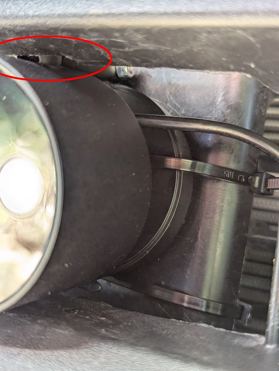

Ford Maverick Installed outdoor WIFI cameras to front grille and truck bed and... PXL_20250830_183305596
The camera literally only just fits in the gap between the two lower parts of the grille: the top and bottom of the camera are pushing against the grille and if it wasn't plastic with a little bit of flex, I'm not sure the camera would have fit. The one part that didn't fit was the mount / screw on the camera, the camera would fit sideways but that piece on the camera added too much height. I didn't want a vertical image so made a small cut in the second to lowest grille plastic, on the bottom so that it isn't visible unless you're under the truck. It's still a snug fit but wedges in there nicely.
