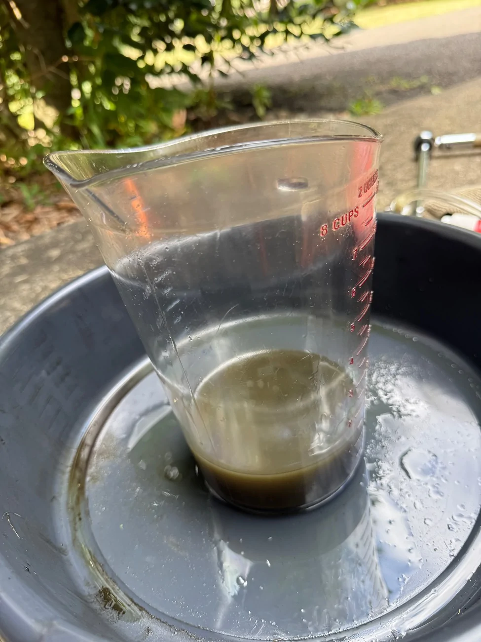

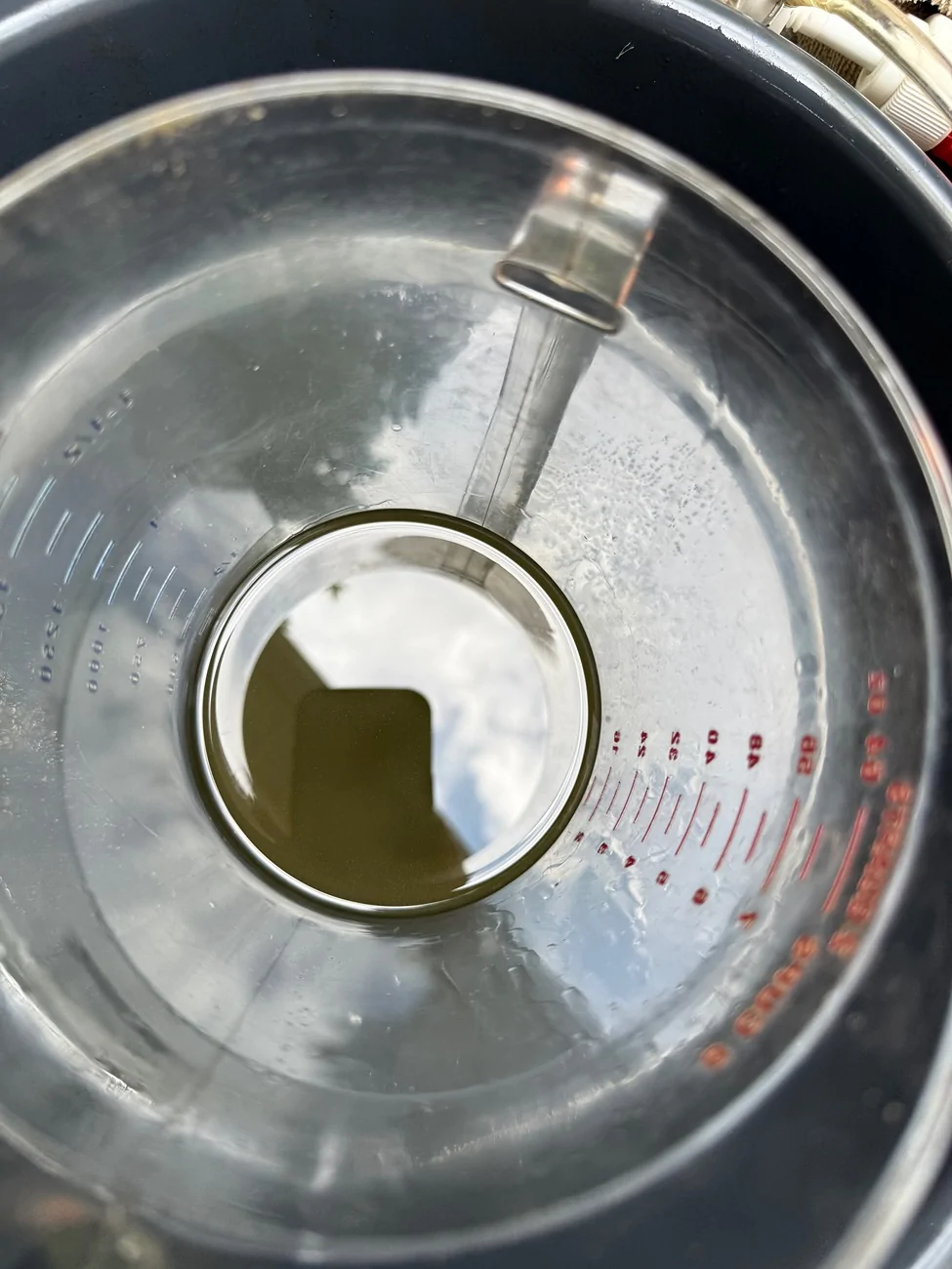

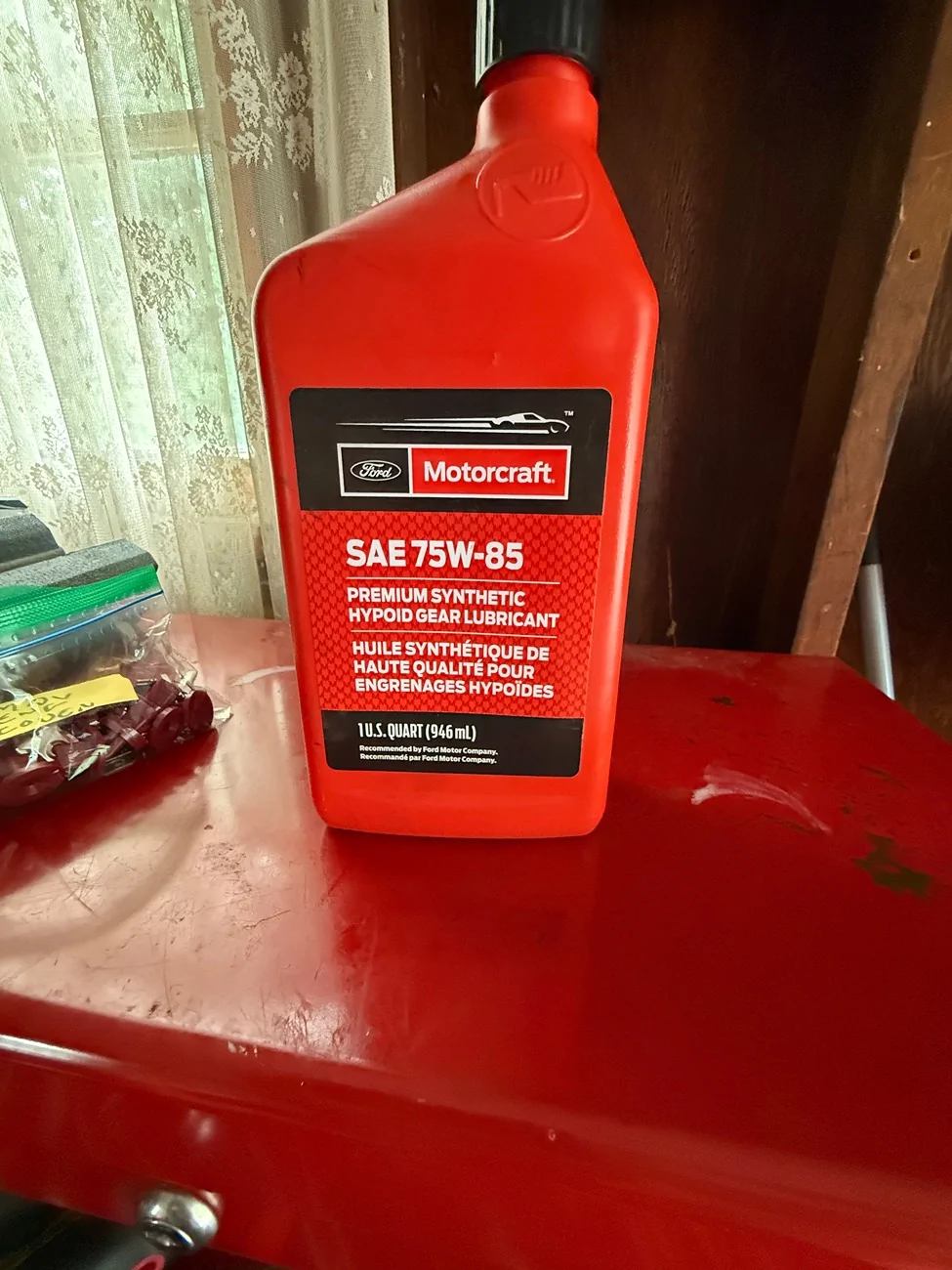

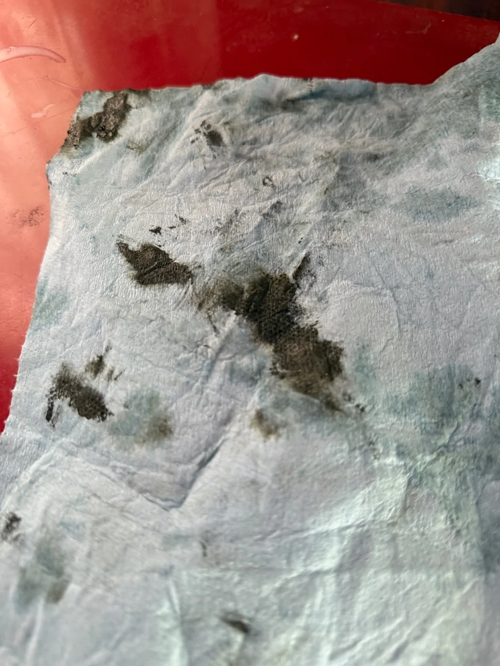

I just changed the PTU oil at 1800 miles. I know a lot of people reported that it was under filled but mine was perfect from factory: about 13 ounces drained and the same amounted added. The fluid was cloudy but I didn't see any particles like others have. The magnet on the drain plug had the same "sludge" as others. Very simple maintenance. It took about 45 minutes if you include getting it on stands. (The sludge from the magnet is what is on the shop rag.)
Booyah 👊🏽 😁 👍🏽 🇺🇸
Doesn't look so hot
