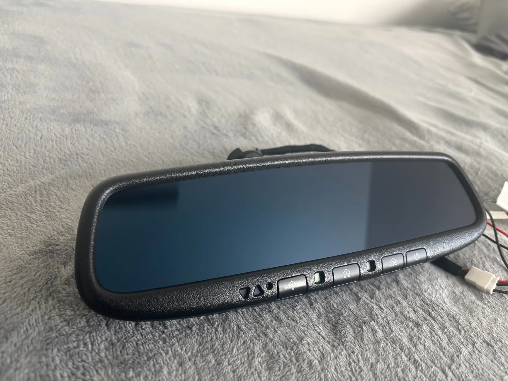

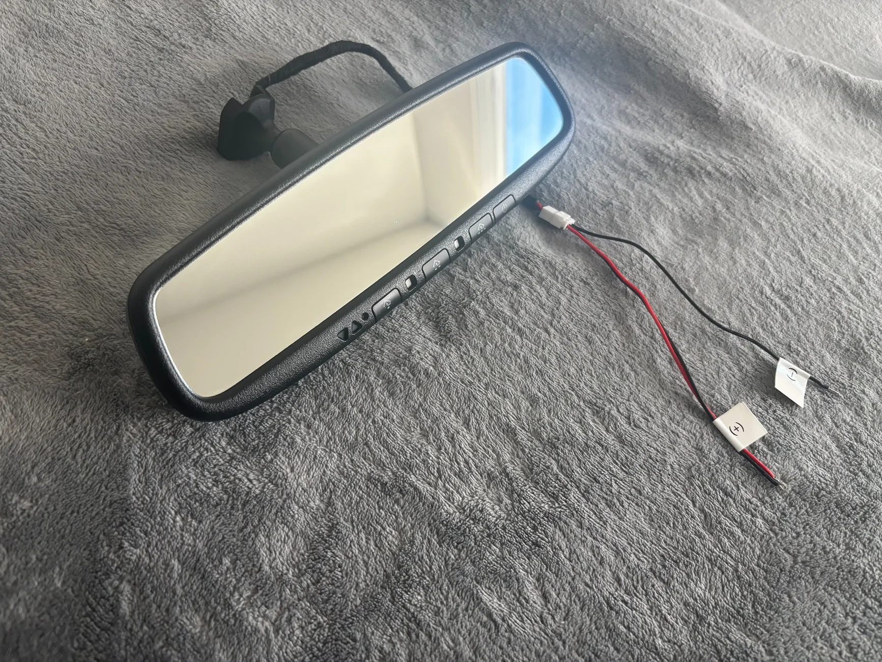

I also have one for sale if anyone wants it (I decided to go frameless but its way more expensive) and I'm trying to break even on this one ($80 shipped). I have a wiring harness made up and labeled and included... It's homelink v5, which is the latest version of homelink, no compass.
I fried the first mirror trying to get the correct pinout :facepalm: and had to buy a new one so avoid my mistake.
