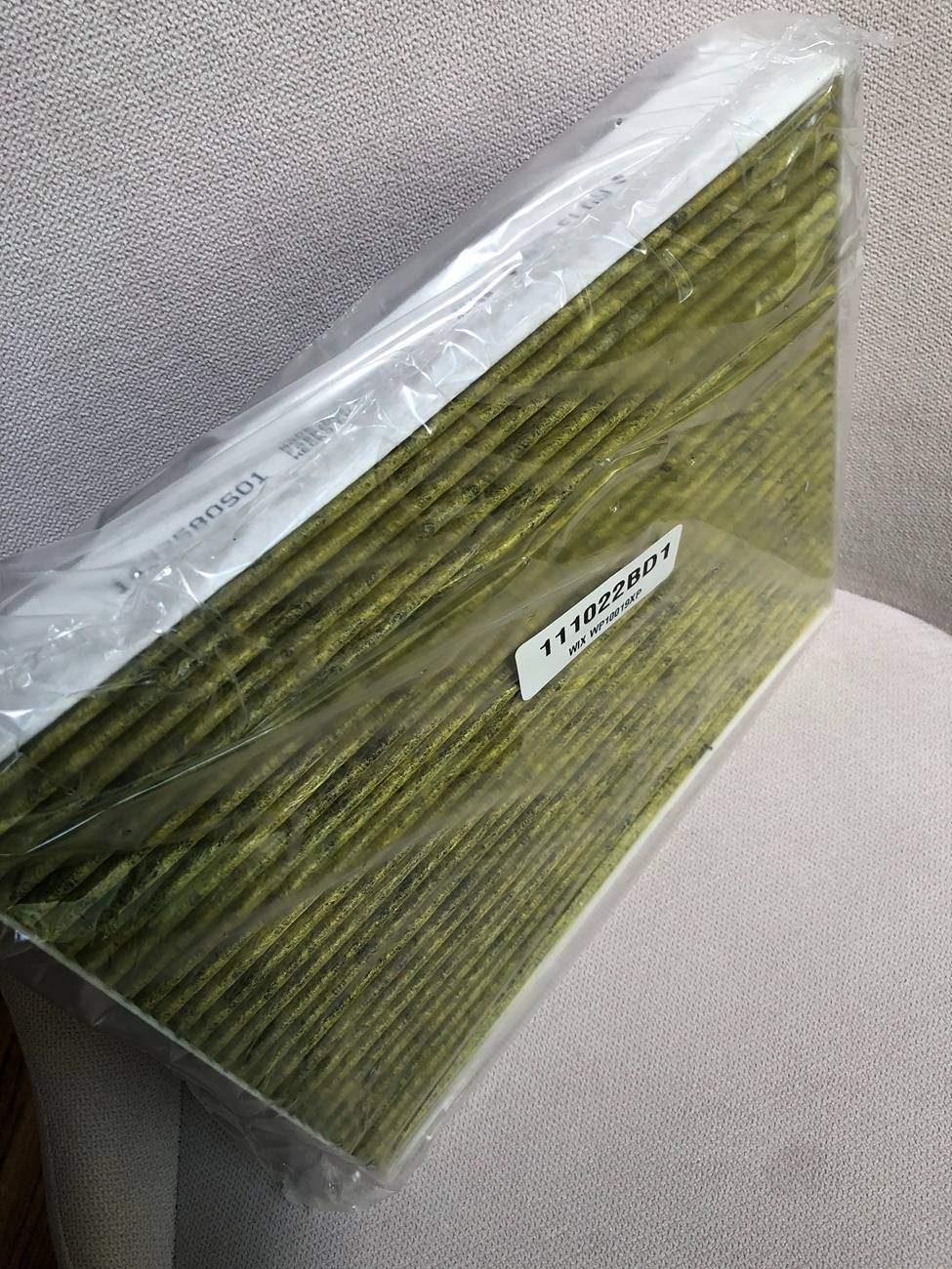

Hey everyone —
Just wanted to share a quick update from my 13,000-mile oil service on my 2025 Maverick EcoBoost (MPC engine).
I do about 60–70% highway driving on NY/CT roads, so I wasn’t expecting much when I popped open the air filter box…
But surprise — the engine air filter was filthy.
Way dirtier than I anticipated, especially for mostly highway miles. Definitely not something I would’ve thought needed attention this early.
So I went to my local Ford dealer to grab a replacement… and guess what?
They still don’t have the 2025 MFC engine listed correctly in their parts system. They were trying to pull older numbers from the previous engine.
Ford OEM Part Price: $43.04 (AIR FILTER only…)
Cash Price I Paid: $28.98 + tax
(Still no cabin filters in stock at this dealer)
OE/OEM Replacement Option: WIX Filters

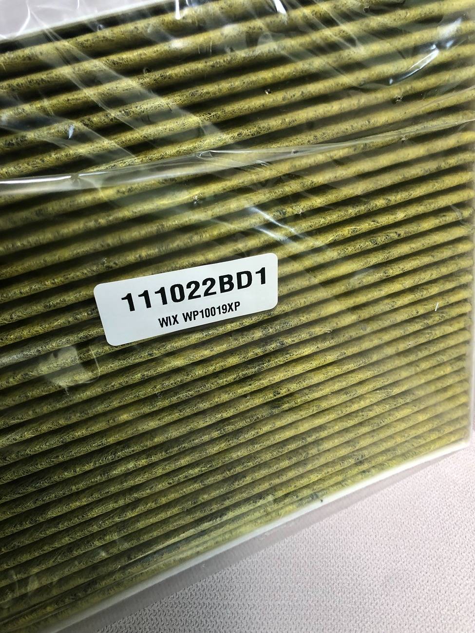

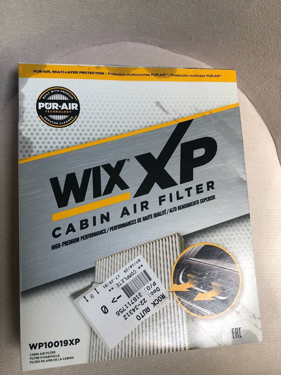

Thanks to a tip from AMSOIL and a quick check with WIX, I ordered both from RockAuto:
Engine Air Filter: WIX WA11346 — $11.34
Cabin Air Filter: WIX WP10019XP — $14.89
Shipping: $7.99 (2-day delivery)
Going forward, I plan to replace both filters every 10K–15K miles, based on how bad that air filter looked.
One more issue solved — hope this helps another 2025 EcoBoost owner scratching their head at the dealership counter.

Would that cabin filter fit a ‘23?
happyfer22
happyfer22
Fernando
Jun 23, 2024
103
254
Carmel NY
2025 Maverick XLT (no GPF....)
Yes — the WIX WP10019 and WP10019XP (the version with Febreze) will fit both the 2023 and 2025 EcoBoost 2.0 Mavericks for the cabin air filter.
However, the engine air filter is different between the model years:
2023 EcoBoost: WIX WA10981
2025 EcoBoost (MPC engine): WIX WA11346
