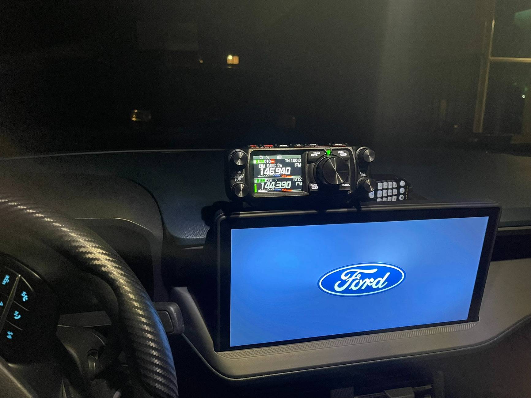

I finished installing my VHF/UHF rig, and I think it turned out pretty clean looking overall. I'll post a list of what I used down below.
Equipment:
  • Rig is a Yaesu FTM-500
  • Mount is the Lido 2.75" Yaesu drill mount. I decided not to wait for the Rubigrid; they don't ship to Canada and also I wanted to store my microphone in the tray
  • I fabricated the steeel plate that acts as an adapter between the factory subwoofer mount and the radio. The holes were not tapped; I tapped them to 5mm.
  • The small box below the transceiver body is a Powerwerx ITS-12 ignition timer/low voltage cutoff module. Don't want to end up in deep sleep if I forget to turn off the radio

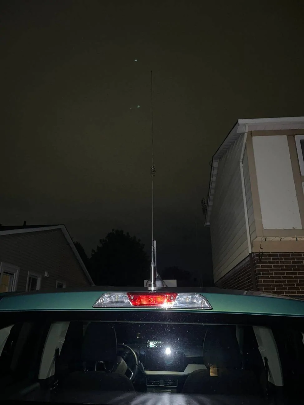

  • Antenna mount is the third brake light single NMO mount from Bulletproof Diesel. It was about the same price as the transceiver. Incredibly expensive but the result speaks for itself
  • Antenna is a Comet SBB-5NMO ground plane independent dual-bander.

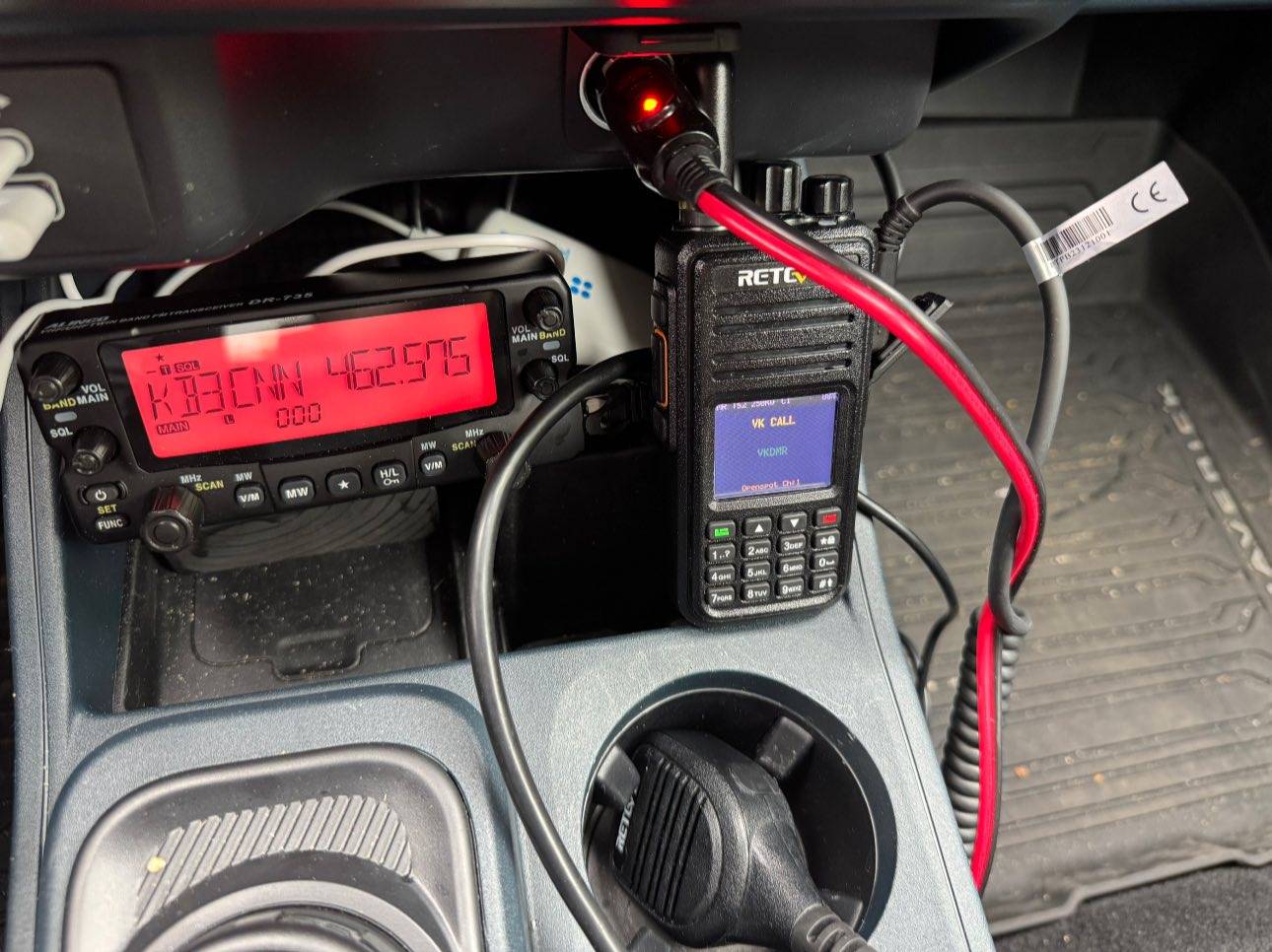

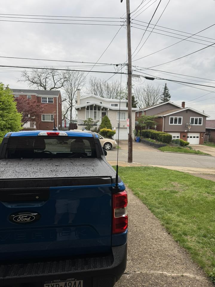

Here's a few of mine (it's a constant work-in-progress)

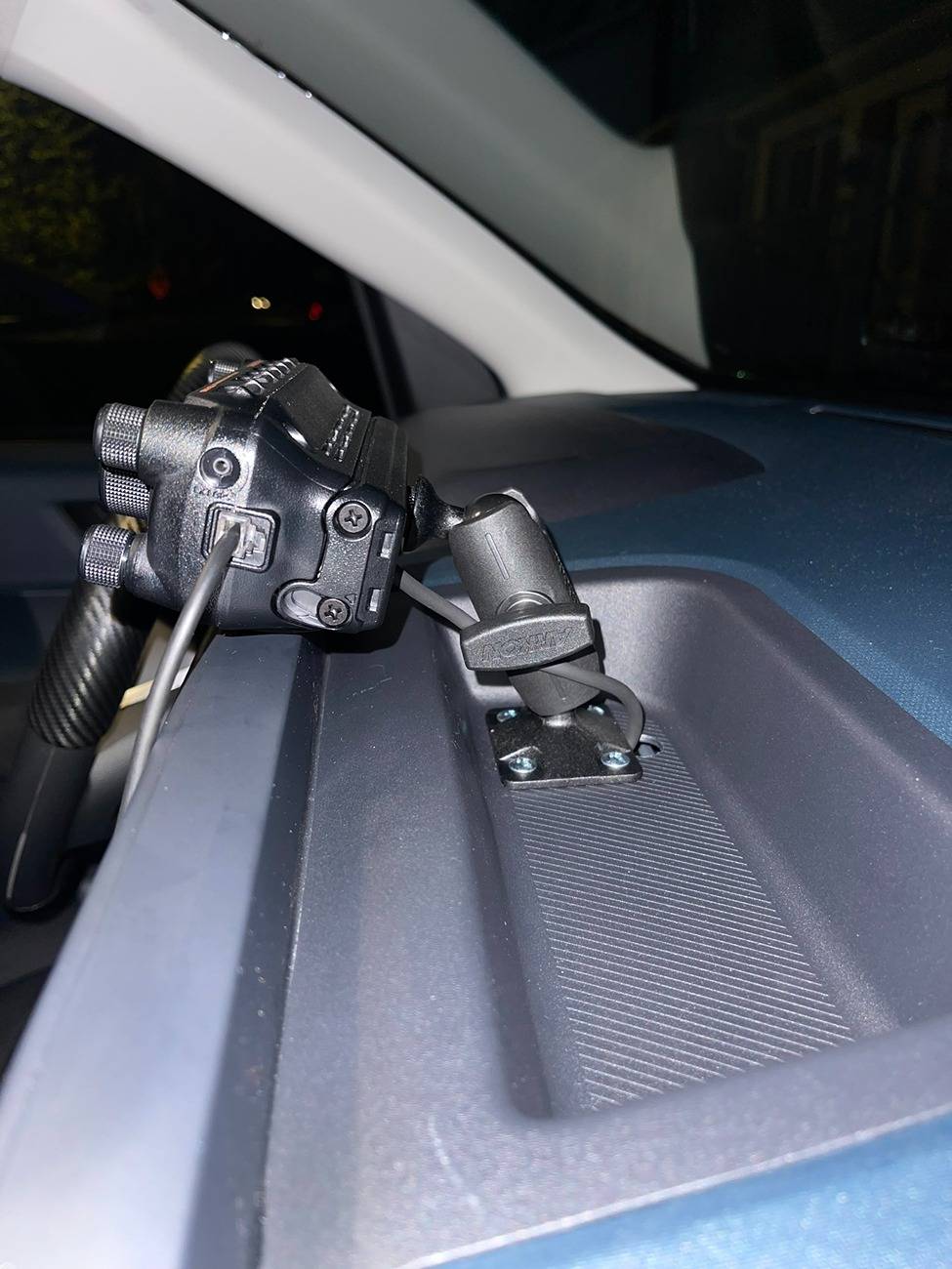

Ford Maverick Completed ham radio installation, 2025 XL 496488955_3214770462004159_8078871507373289042_n
I am running an Alinco DR-735T dual bander, hooked up to a Comet SBB5. The difference is I chose to (for now) mount the antenna on the tailgate using a mount I found on Amazon.
Ford Maverick Completed ham radio installation, 2025 XL 495226781_3215046745309864_8779941365926185938_n

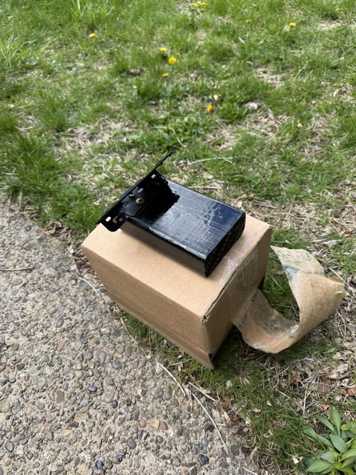

The Alinco head is mounted on a block of 2x4, which I spray painted black. It's like Ford intended a block of 2x4 to sit in there. I chose to attach the head using velcro rather than screws - the Alinco separation kits are a bit different to Yaesu and Icom, it seems, requiring a screwdriver to remove the head from whatever it's mounted to.

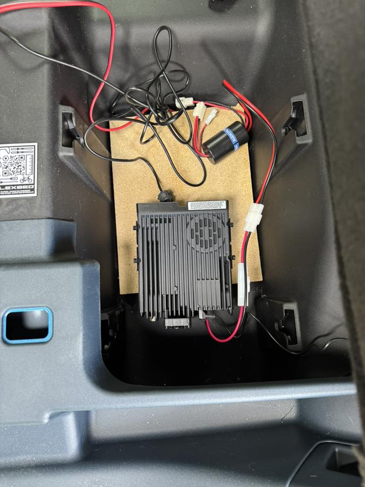

Ford Maverick Completed ham radio installation, 2025 XL 494107805_3215047535309785_8817748101031413290_n

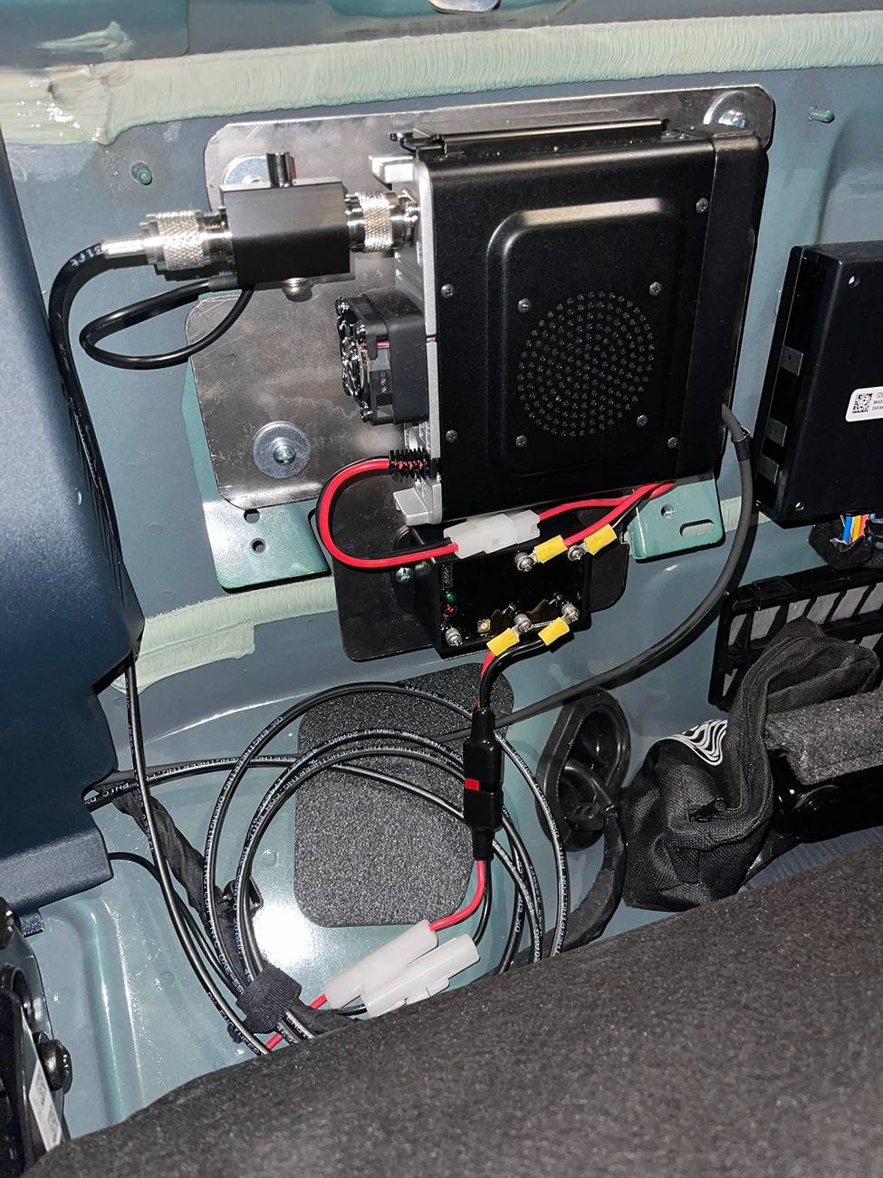

The radio itself is under the rear seat. This is a somewhat out of date photo, it's since been tidied up a bit. For now it's screwed down onto a block of MDF I had laying around. I dont' have a picture of it but I ran audio up to a speaker (some cheap DX Engineering one) that's velcroed next to one of the rear head-rests. I have a little passive mixer that I'll use to mix audio from multiple radios onto that one speaker. But, since it's passive it's not loud enough. So it'll need a little amplifier as well.
Ford Maverick Completed ham radio installation, 2025 XL 497890916_3215046945309844_2173768774956508450_n
The next step is to run power from the engine bay rather than through the accessory port.
