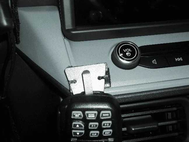

I used the standard microphone hanger for my mike and stuck it to an area where I could reach it easily. The tape is strong enough to hold the weight of the mike. Future use will tell me if it will hold up.

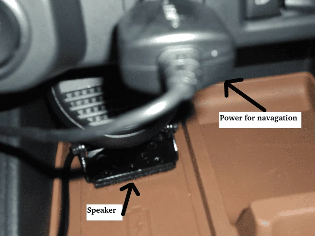

The speaker has a mount designed to be screwed on to a flat surface. I just put one side of the Velcro on the speaker mount and the other side of the surface just about where the recharging area is at the bottom of the dash area. I don’t need the recharging function for my phone. So, the speaker is facing forward and is in the back in the bottom dash area.

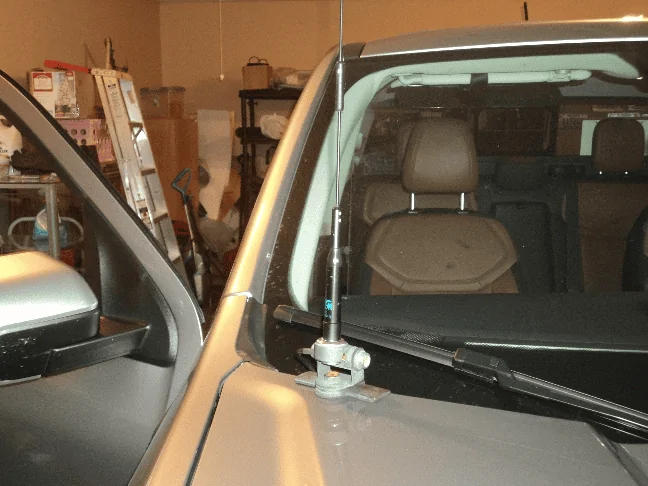

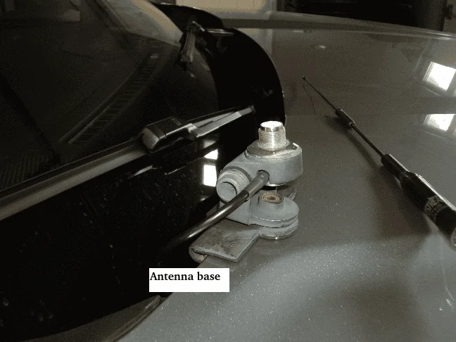

When I was looking over the truck to find a good place to mount the antenna instead of the best place, which is in the center of the roof, I was standing on the passenger side by the front wheel and noticed the hood near the windshield. There was a spot on the hood where the mount would fit, just like on the trunk! There is probably one of the same on the driver’s side but Ford says to keep RF away from the area due to the computer locations, so the passenger side it is.
After putting some oil on the set screws to attach the mount to the hood, it went on with no problem after I found the correct Allen wrench. I screwed the antenna on and opened and closed the hood to make sure everything fit and there were no conflicts.

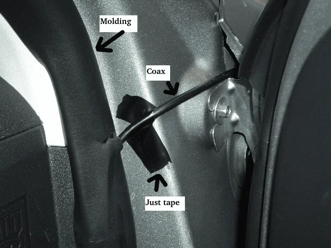

The coax ran under the hood OK but I could not find any holes or potential holes in the firewall to get the coax inside to the rig. I ended up running it to the passenger door molding and made a slice across it to insert the coax. I planned to snake the coax through the inside of the molding and run it down to the area of the passenger seat. I had to remove the connector on the coax so it would fit through the molding. When I tried to push the coax through the molding, it was not stiff enough to push it through. So, I had a “snake” used to pull electrical wire through conduit but it was a bit too big on the end for the molding. I looked around and found an old antenna rod to use to pull the coax through. Since it was stiff, when I got the coax down to the bottom where it curves, I couldn’t get it around the curve, so I had to make another cut in the molding and untape the rod from the coax and do it over again until I got it to the rear of the seat where I ran it under the seat mounts to directly under the seat, where I have the rig. I put on a new PL-259 and the antenna was ready to go.
As a bonus, I will mention my navigation system. Unlike those of you that are getting a 23 model year, those of us with the 22 model year had to do without or get our own. I had previously installed one on a motorcycle, so I had no problem with this one. It is the cheapest one Garmin has. I ordered one without the traffic option but did order the extra memory and the vehicle power cable that is long enough to reach from the windshield mount to the lighter outlet in the lower dash area. Since I no longer live in major metro areas, I don’t have to worry about traffic.
