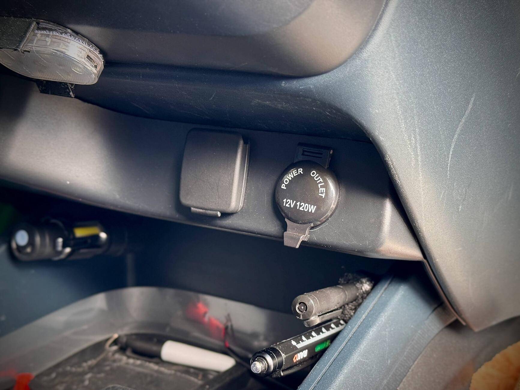

I've been incredibly excited to get the parts in and do this mod. I made a splice-in harness that sits between the OEM cigarette socket connectors and so I can tap the circuit for relayed (and fused) power at the front of the cab. I use the cigarette socket for the light bar on top of the truck, dash cam, and to charge my various flashlights/electronics. Since I have an XL, I had plenty of space to install a second cigarette socket (for ease of use). Next steps, I'm going to install a basic USB charger in the glove box to keep my jumper and headlamp topped up, then maybe a switch panel in the cubby for the light bar and light pods.
Note: I'm not worried about melting the wires or blowing a fuse because I almost never use the rear media cigarette socket (no power draw) and most of the accessories I'm connecting are low current (15-30W). When I use something that uses more power (light pods/bar), there's almost never an occasion where I'm doing it at the same time.

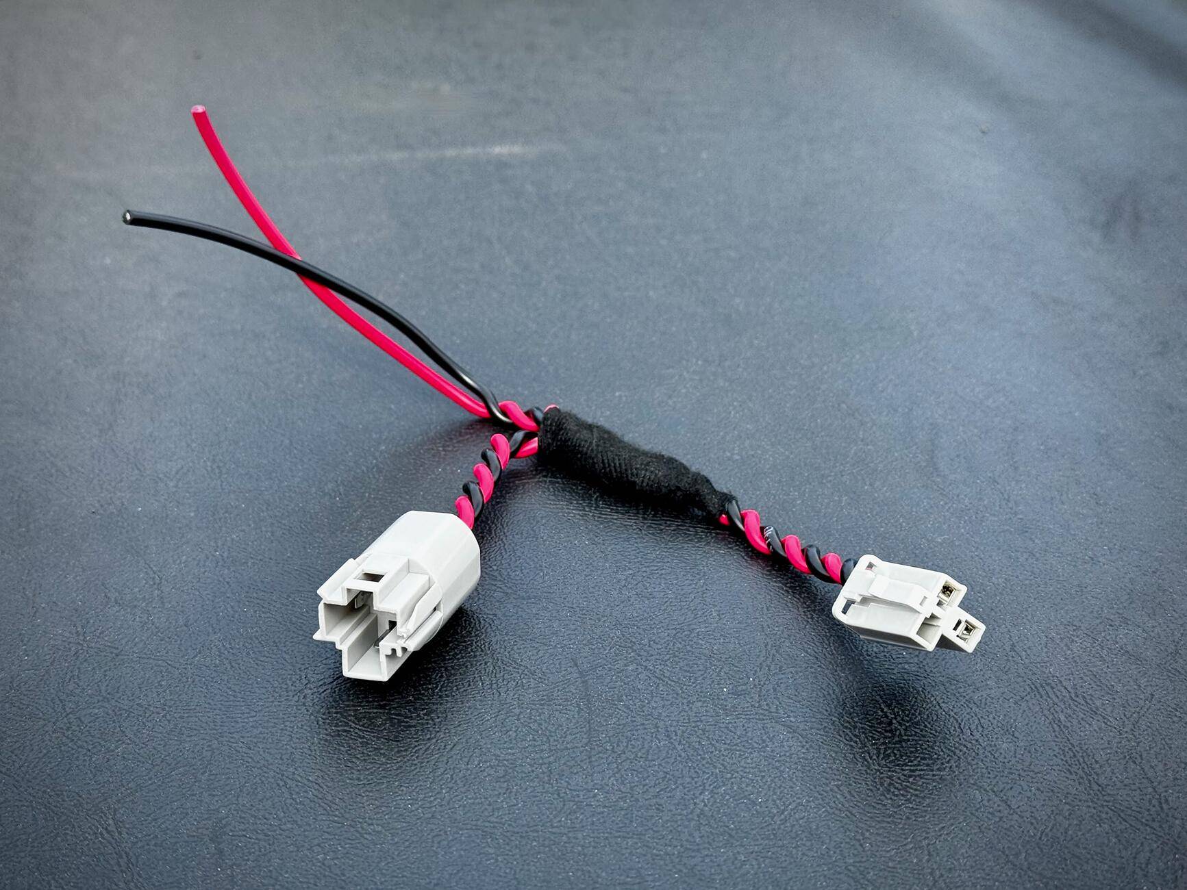

Splicing harness: Male/female cigarette socket connectors with 6" free wire leads.

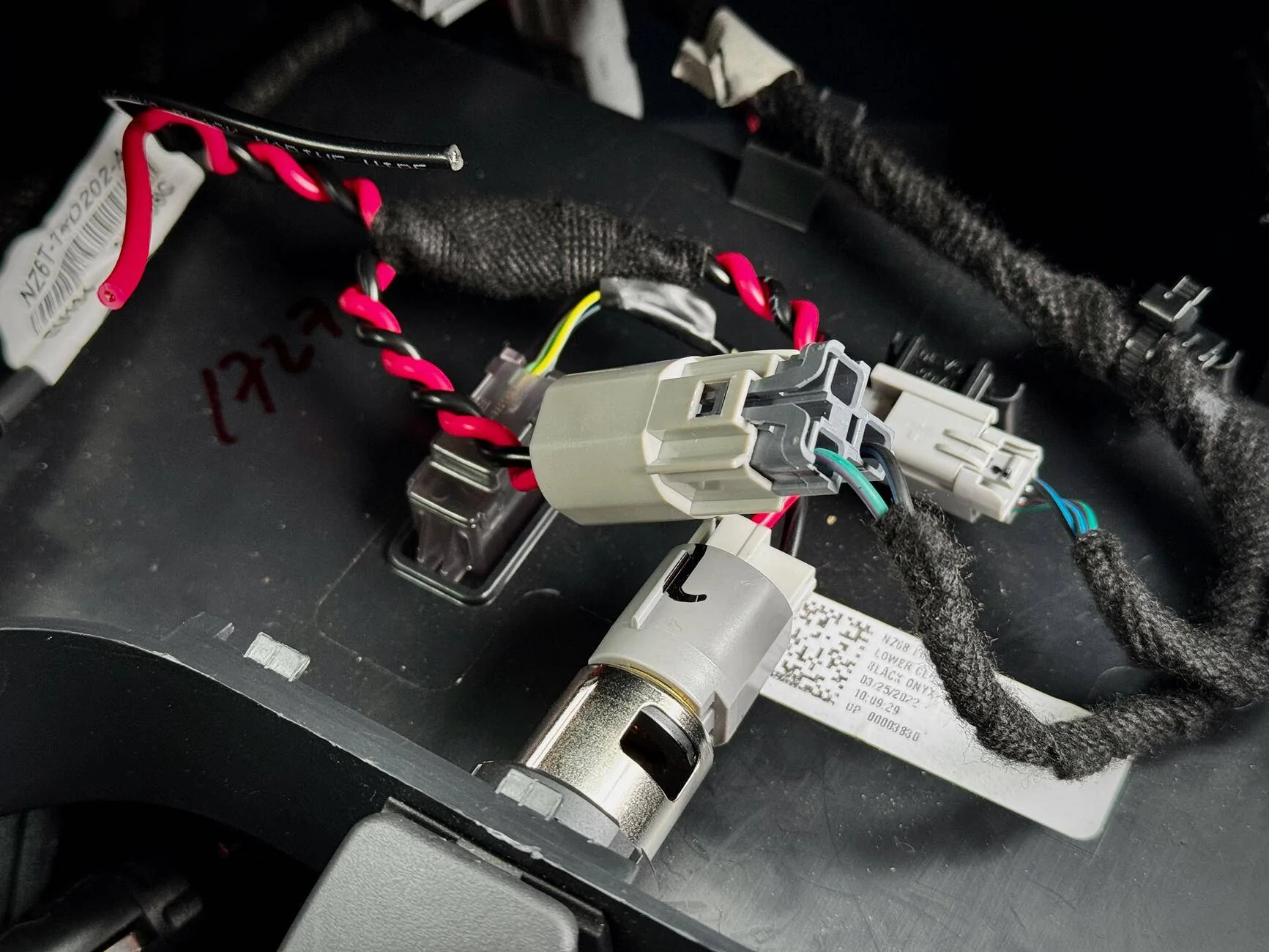

Added the splicing harness between the OEM connectors (splice = light grey, OEM = darker grey)

Added the new cigarette socket then connected everything up to lever terminals (for ease of use). Tucked away the wires then installed the panel back.
Ford Maverick Added second socket using Cigarette Socket Splice-In Tap Kit (with photos) IMG_1372
Works perfectly now.

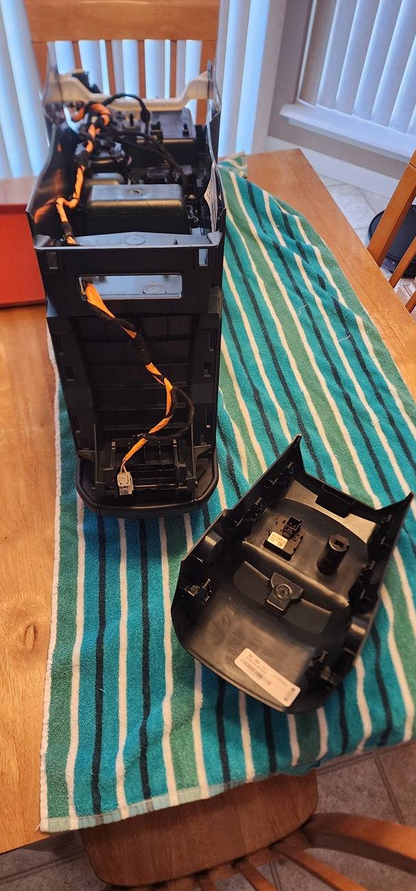

I tapped the 12 volt plug for my ambient lighting.

Yeah it comes out pretty easy there's just four plastic clips that hold it in you can use a towel on the HVAC control panel and gently get a plastic trim panel removal tool to get your fingers in there and pull that panel straight out towards you, it just snaps in and snaps out.
Nice to know that's what it looks like from underneath!

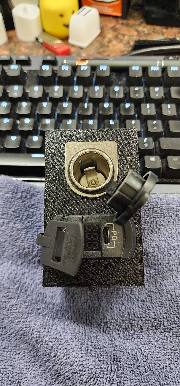

Ford Maverick Added second socket using Cigarette Socket Splice-In Tap Kit (with photos) 1741303669326-al
Made this up for the Cubby. Haven't had time to hook it up.
