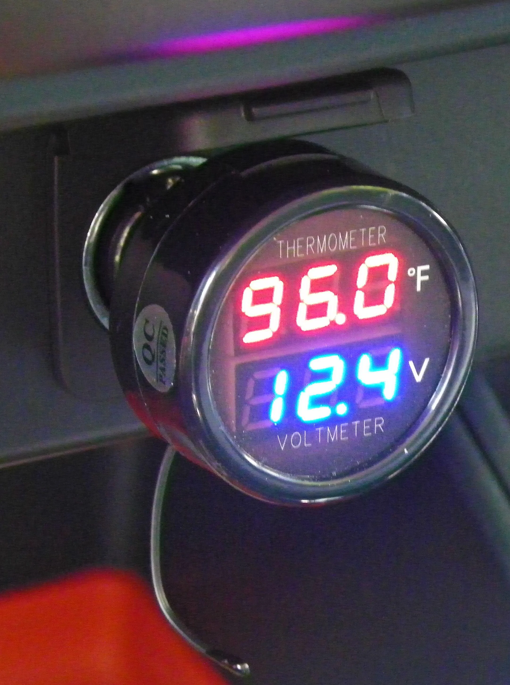

On my previous 2022 Maverick Hybrid and my current 2023 Maverick Hybrid the 12 Volt Socket is NOT HOT All the Time.
With the Hybrid turned off and the key removed on the 2022 it powered off as soon as the driver door opened. On the 2023 it powers off in a short time after I exit.
I have this Battery Voltage/Temperature Gauge plugged into the Socket so I can tell that it does shut off.
Ford Maverick 12v Socket Hot All the Time? 12.4 Volts Overnight First measurement in the morning
