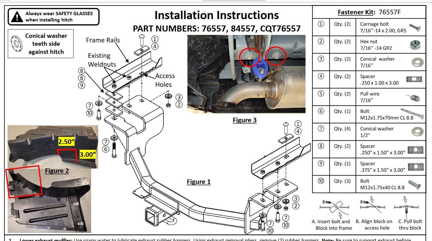

I wonder why they elected to use 7/8" worth of spacers on the drivers-side, rather than just bring the sideplate/flange to the correct level?
HRG
Probably because the side plate is already made for use in another vehicle. BS possibly.

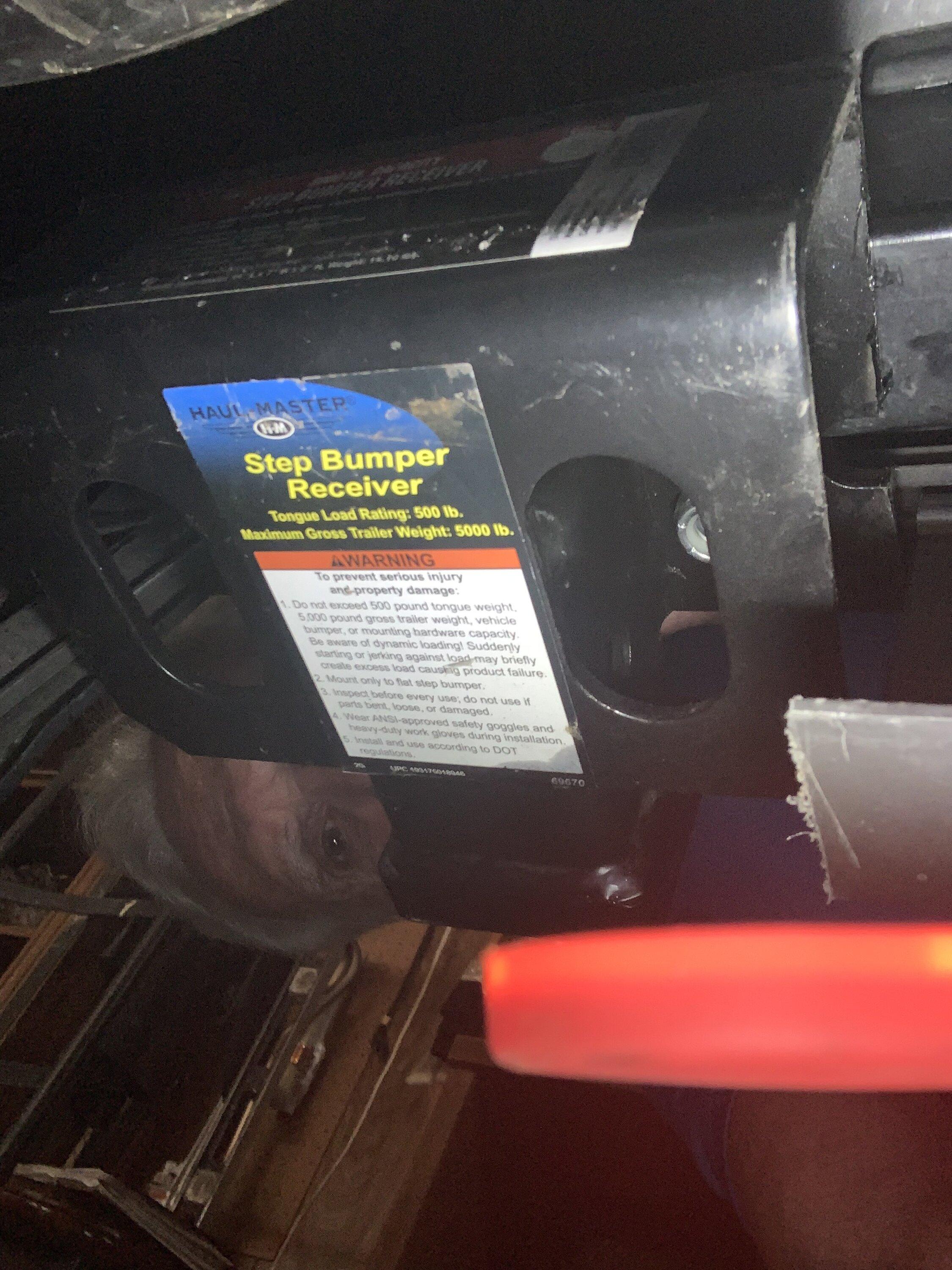

Interesting in that it doesn't use the hitch cutout area that the normal Ford hitch does. It hangs below it.
I cannot like this design with it hanging below the bumper. I will make my own before using that poor design. Weld on a $50 receiver for 2.00'' wide channel onto the original crash bar and add the Curt harness for a BS and you are good to go. As close to OEM as it gets and potentially better than OEM.

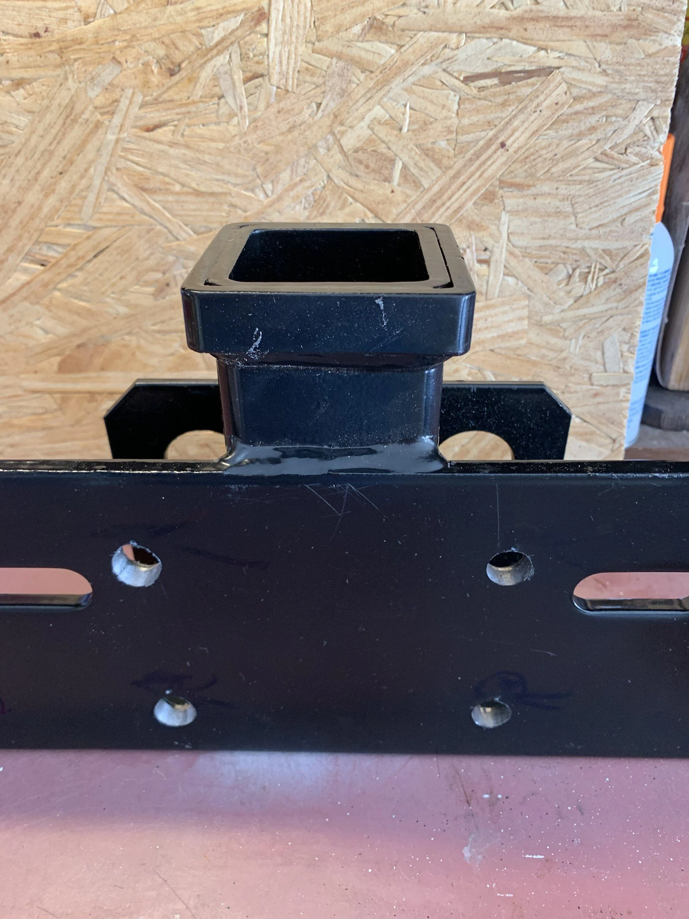

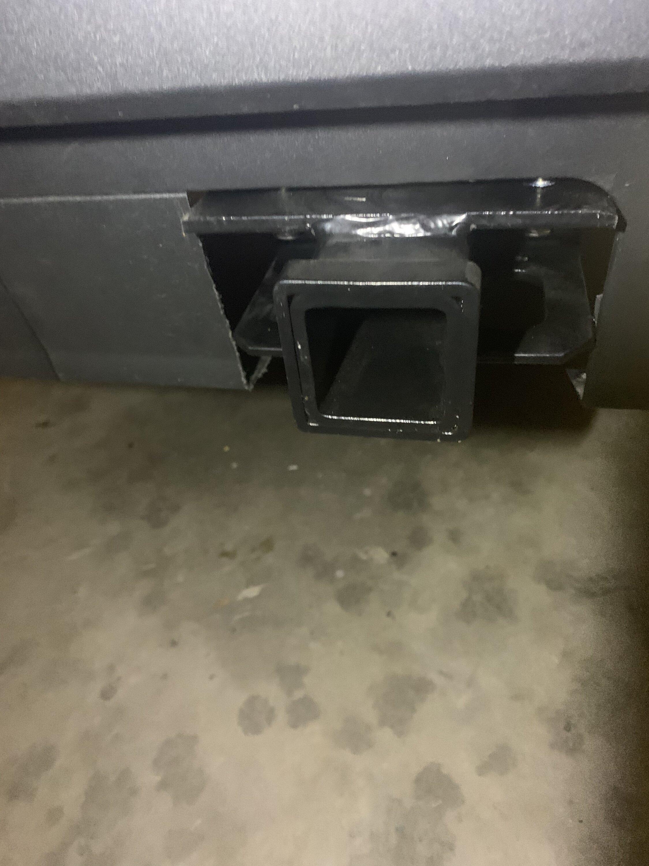

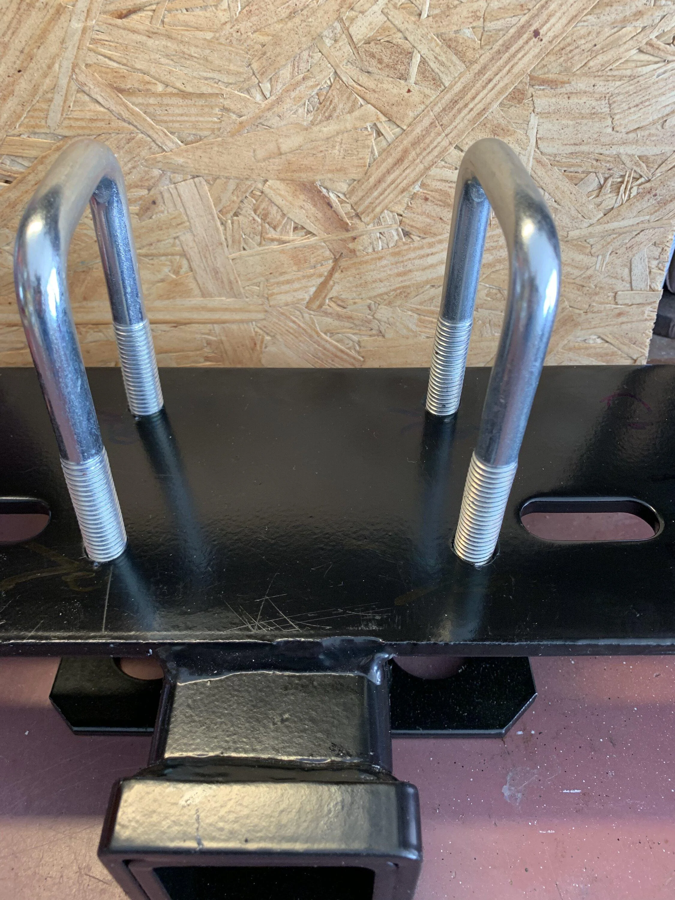

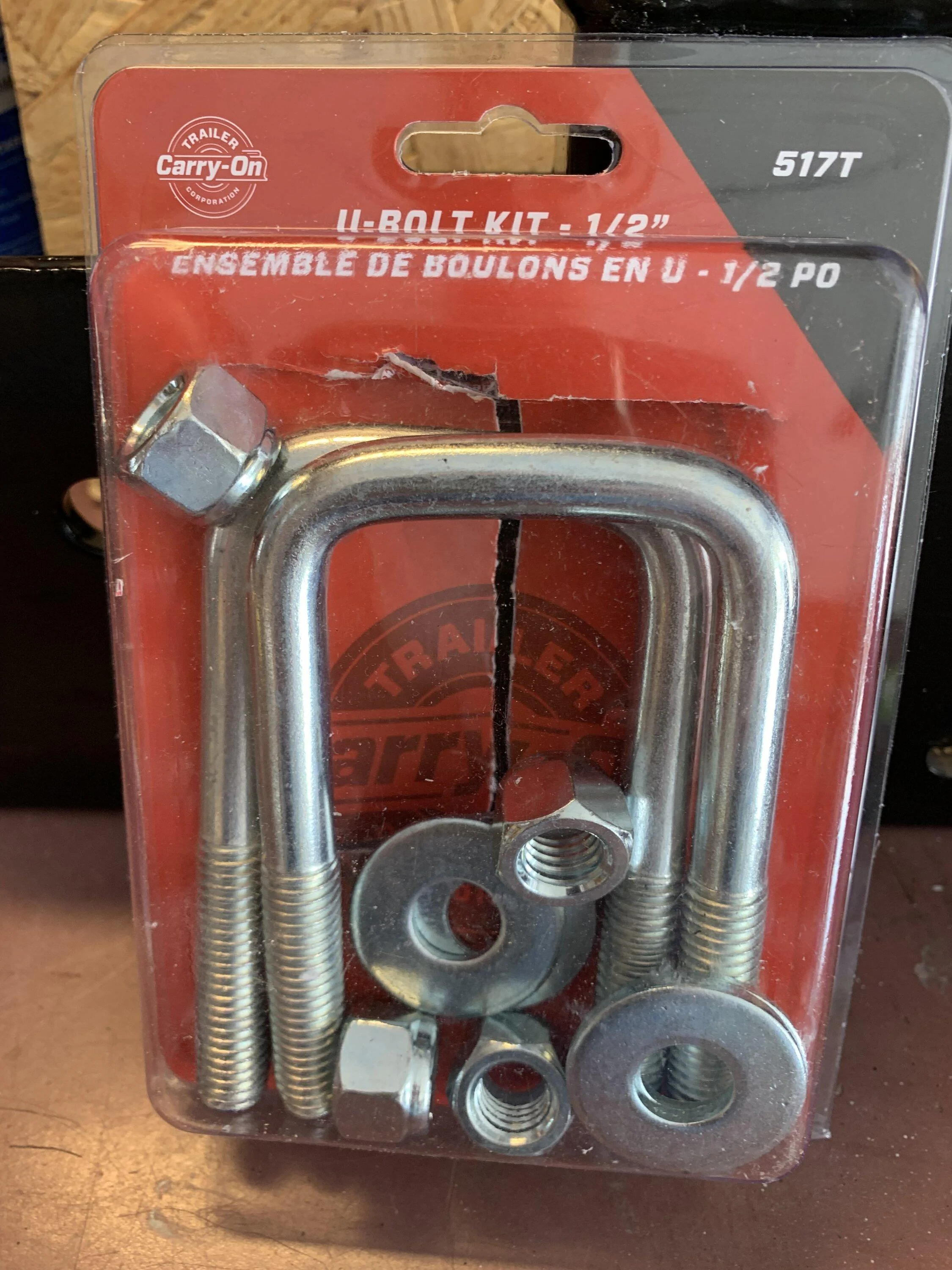

Did you ever upload pics of it? I saw someone was going to do that but they never followed up so I didn’t know if it fit. All I saw was that online they said they didn’t fit.
Ford Maverick 3rd party Towing Hitch FINALLY - from Draw-Tite 89944E68-18F0-4396-8F20-486FA52C7217
I did get this mounted. I modified to fit U bolts and opening. To fit opening I cut off side plates flush with the body of the hitch.
Ford Maverick 3rd party Towing Hitch FINALLY - from Draw-Tite D1B9FD50-F73C-44A8-AA48-382BD8799C55
Ford Maverick 3rd party Towing Hitch FINALLY - from Draw-Tite 9BD685B2-DF7E-48B8-92E0-F53F01A948CE
Ron#Maverick
Ron
Apr 14, 2022
Duncan, OK
After mounting a step bumper hitch, I think a receiver tube mounted with a single U bolt would work for a 2000 lb hitch. Safety hooks would need a place to attach to the truck. That should be straight forward.
