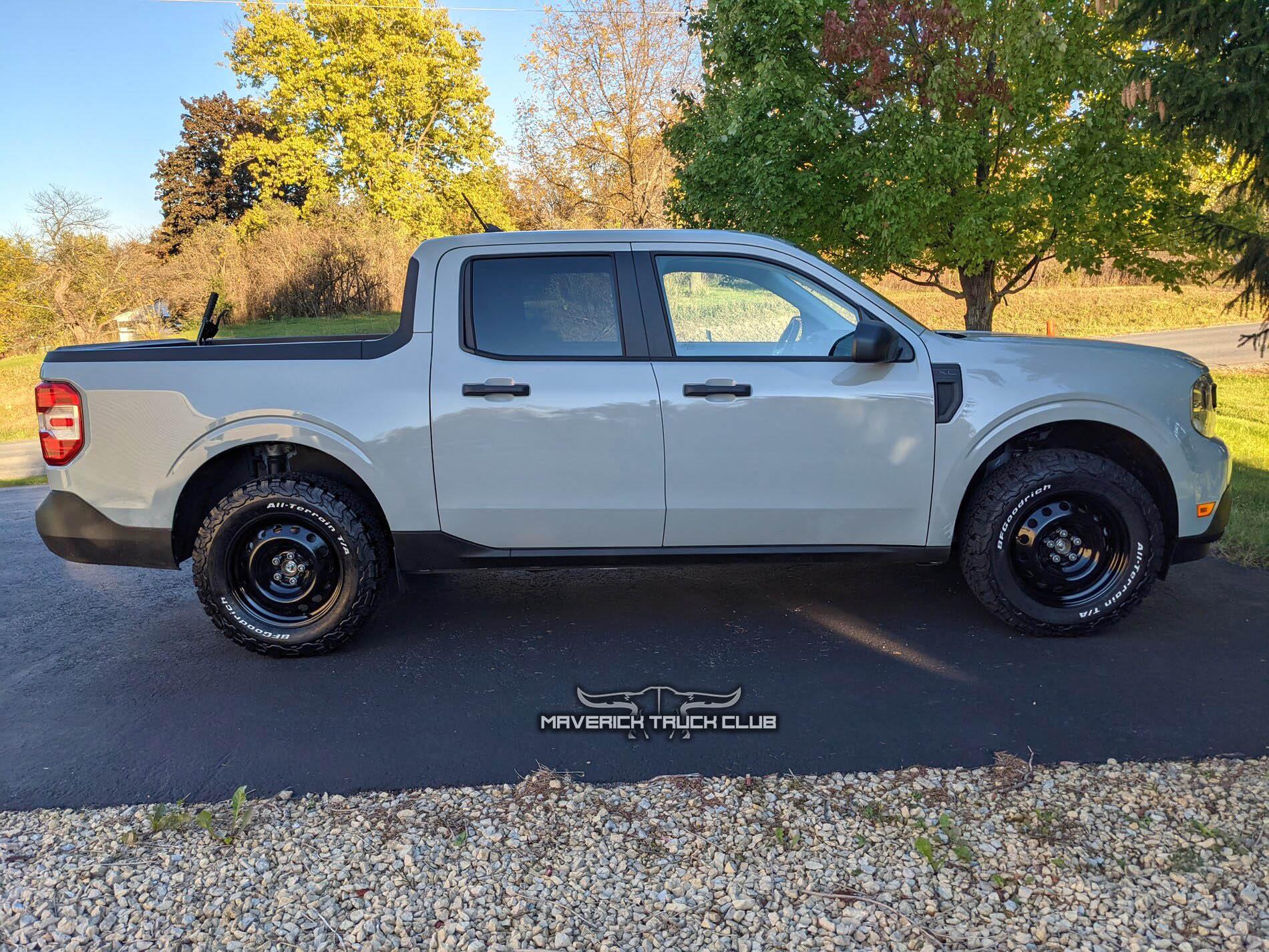

Directions on painting the XL steel wheels:
You want to pressure wash the rims first to get any debris off then sand it with 600-800 grit sandpaper and the factory silver color comes off very easy.
Then pressure wash again and wipe clean.
Let it dry then place index cards in-between the rim and tire to protect the tires from over spray.
Then just use a rim specific spray paint and put 3-4 coats of paint on.

Dang, that looks awesome!! Nicely done!!

Go big or go home!

Looks nice. Some silver Ford center caps would really set it off though.

looks great!! I think that’s a smart approach/set up w/hybrid When you want a great look trying to spend as little as possible, looks better than half the people spending a fortune on wheels and rims, congrats
