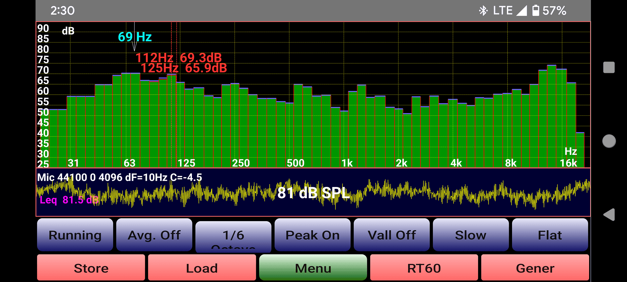

Setting the EQ to "flat" removes the haystack boost at 65Hz or so, and removes the rapid rolloff below 55 Hz (see atatched). The haystack makes for a very "one note" thumpy aftermarket subwoofer, with little very low frequency (25 to 50 Hz) content. Setting the ssytem for "flat" removes the haystack and also the rolloff, yielding a flatter LF response with extension down to 25Hz or so. The sub is MUCH easier to optimize after making that change.

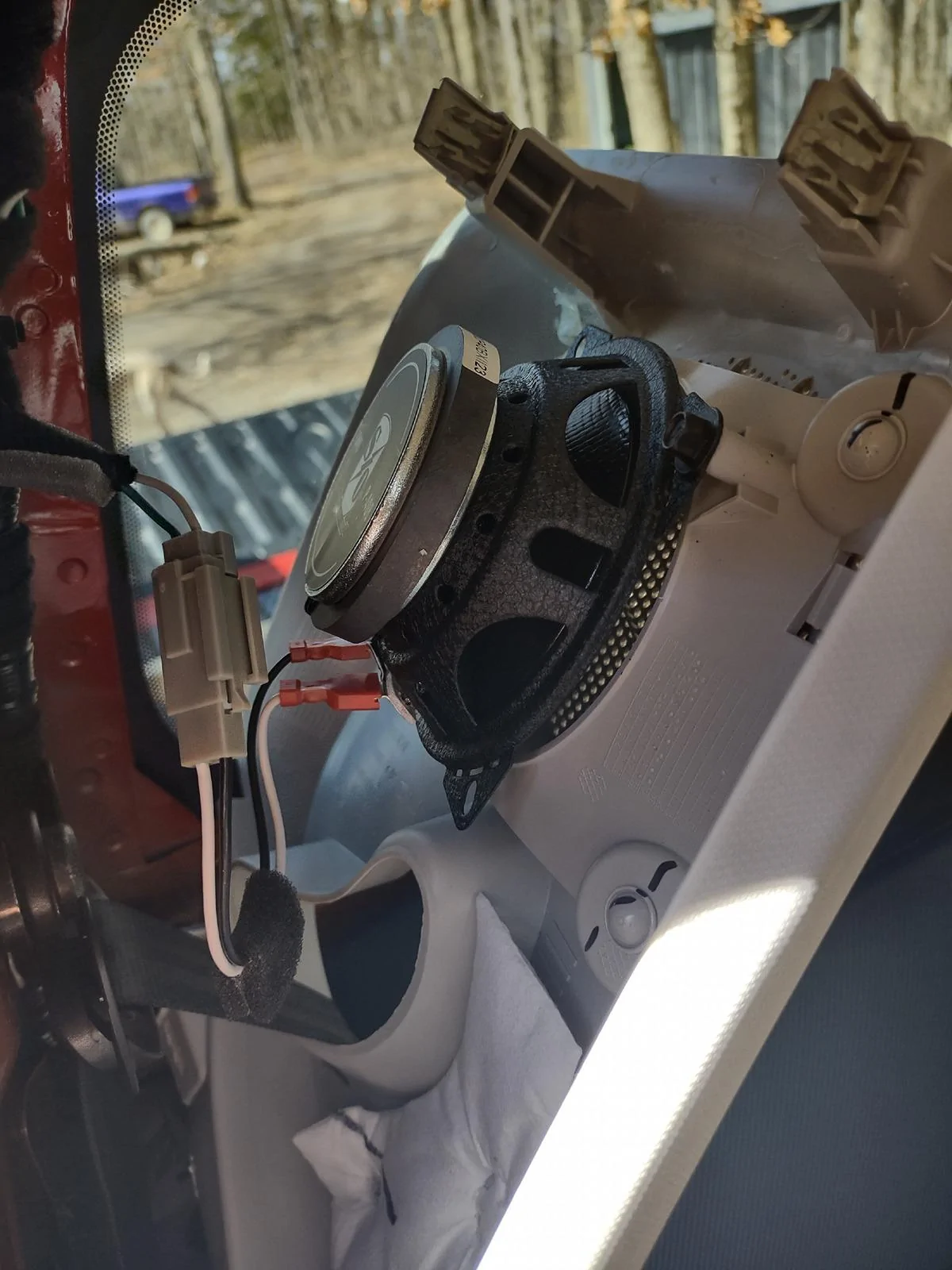

For the rears, which I probably wouldn't have done except I needed to tap the line(s) for the subwoofer, were a little more difficult than the fronts. Again, there's lots of videos showing how to remove the rear trim pieces and it's not that hard, but it's a lot of back and forth to each side of the truck while the seat is up, and down and up again. Plus you have to battle the long rear window piece which is awkward and has the middle seat belt running through it. The best way to deal with it is to pull it off and then move it up and over the rear seat so its out of the way. The only difficult piece is the top most grill where the speakers are mounted, because the mount on the rear most corner is woefully weak. Even with care, plan on breaking this mount -- but a little plastic weld or epoxy will fix it right up. You'll see when its off, that this is a poorly designed mount that was probably never intended to be removed. And by the time you get to this point, you'll need a break anyway - so leave the epoxy to set up and just walk away. Fortunately, these top most pieces are held on with a 7mm bolt, so they'll still be plenty secure no matter what you do.
The rear speakers bolt right in like the fronts with no clearance issues using two 7mm screws. But before you install the speakers, push on the Metra harnesses. Then tap the wires in the harness(es) so you don't have to alter the factory wires. I only tapped the left rear speakers, but there's inputs on the subwoofer for both left and right speakers if you want to tap both sides. IMO it sounds just fine with only the left (or right) tapped. Run lengths of primary wire to the butterfly bracket (or wherever you decide to mount the subwoofer). I used 16 ga. wire. Then test the rear speakers and reinstall the trim pieces. I'd say the rear speakers are only a 10% improvement over stock, but I like having 2-way speakers with tweeters in rear too versus just the 4" factory cone.

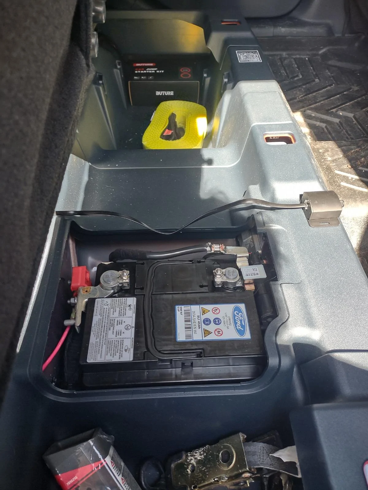

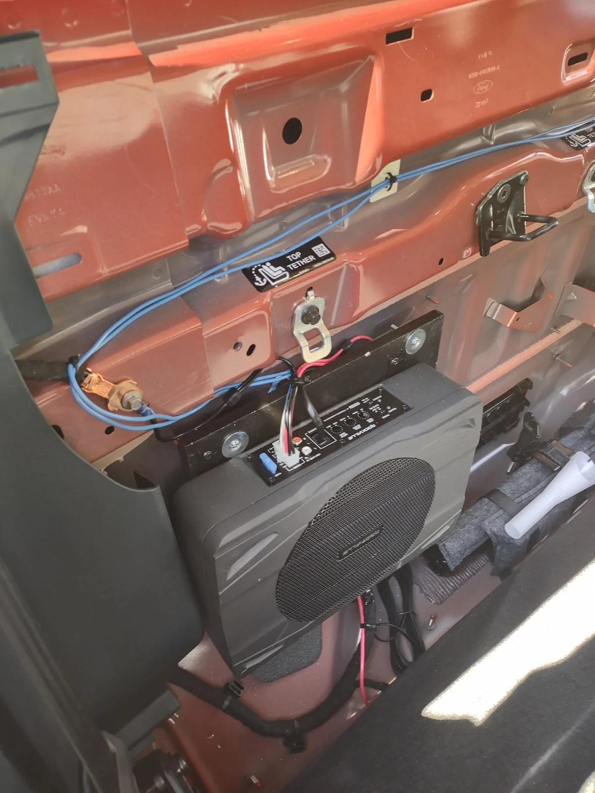

Finally, wire the subwoofer. It's pretty easy in the XL hybrid because there's an unused butterfly bracket already mounted on the rear of the cab behind the seat and because the battery box is right there. I mounted my subwoofer to an 11" x 11" piece of 3/8" plywood. I made a cardboard template and transferred and drilled the holes on the plywood, and then mounted the plywood to the butterfly bracket with #8 bolts and washers. The subwoofer comes with mounting screws and I used those to attach the subwoofer to the plywood. I ran the tap wires from the rear speaker(s) to the subwoofer plug and connected the wires together using 12-24 ga. Wago Lever Nuts (from Menards). These connectors are nice because they hold well even using different sized wires and can be removed and refastened as needed. The ground wire is long enough to attach to the grounding point right above the butterfly bracket. And I added about a 12" length of 10 ga. wire to the power lead to reach the positive terminal on the battery. Finally, I mounted the subwoofer control box to the trim under the front of the rear seat (just foward of the battery box) so I can adjust the bass from the driver's seat by reaching back to turn the knob. Others found the SS8P to fit nicely behind the seat, and it works just fine in my Maverick as well.

How do you like the output on the 8" sub? Looking at the same sub but in 10", but wondering if space will be an issue. Looks like the 8" fit great on the existing mount (I think I'd have to cut it out for the 10" and find some way to mount), maybe that's the way to go if you're getting solid sound? Not looking to shake things, just a good sound to round out the system.

8" is really plenty IMO, especially with upgraded door speakers.
