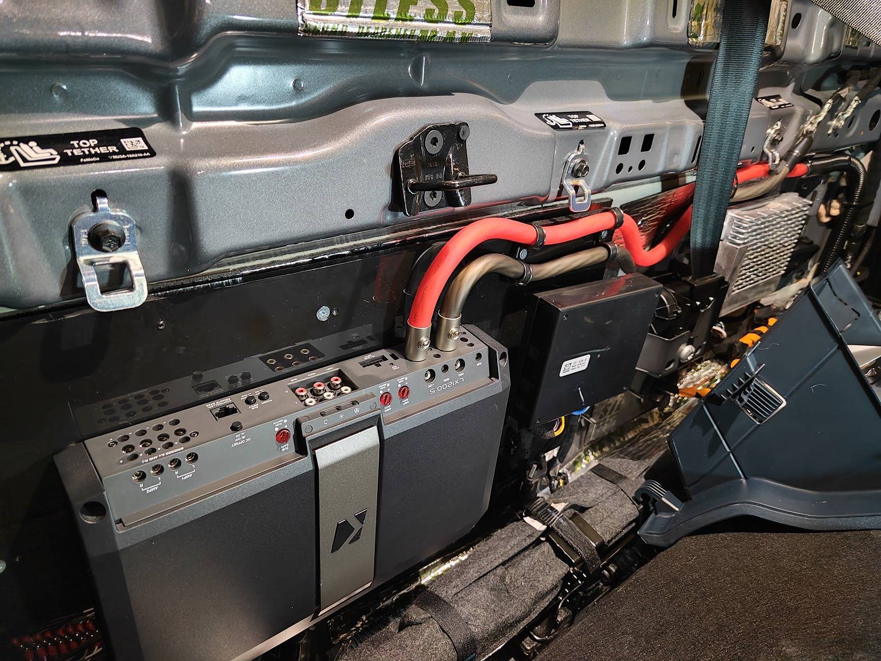

I'm installing a Kicker LX1200.5 along with all kicker speakers, running new 16 gauge wire everywhere (125w rms in the front), and a pioneer sub. Just using the DSP inside the amp. Sounds great and I'll post the build soon, but I'm having issues.
After 5-20 minutes (depending on the volume I set from the head unit), just the driver side cuts out.
If I swap the front left/right speakers at the amp, it's still the left channel that cuts. It's front and back as well. The right side and sub keep going. I still need to test at lower volumes for much longer. If I have it at 30 (max volume), it makes it about 5 minutes. I set it at 20 and it ran fine for 18 minutes, then went to 21 and it cut out in about 2 minutes.
Watching the temps on the amp, it's staying below 53c. I've seen it cut out at 50c even (before I added the sub in).
I'm thinking the head unit is overheating.
Anyone had any experience with running new speakers at high volume and having just one side cut out like this? I'm going to try to run it at like 15 with higher gains on the amp to see how that goes.
A mid-build pic for dramatic effect..
