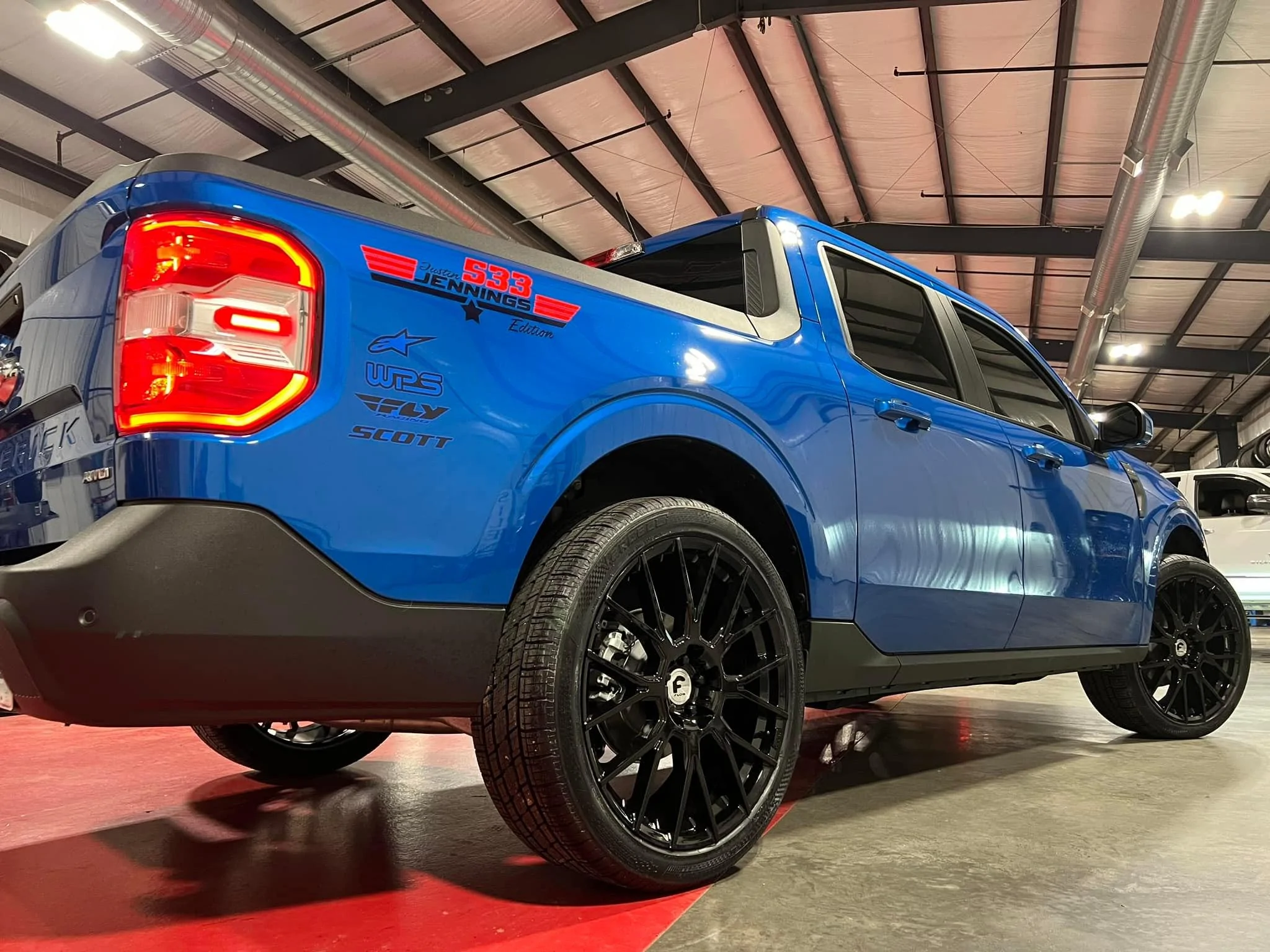

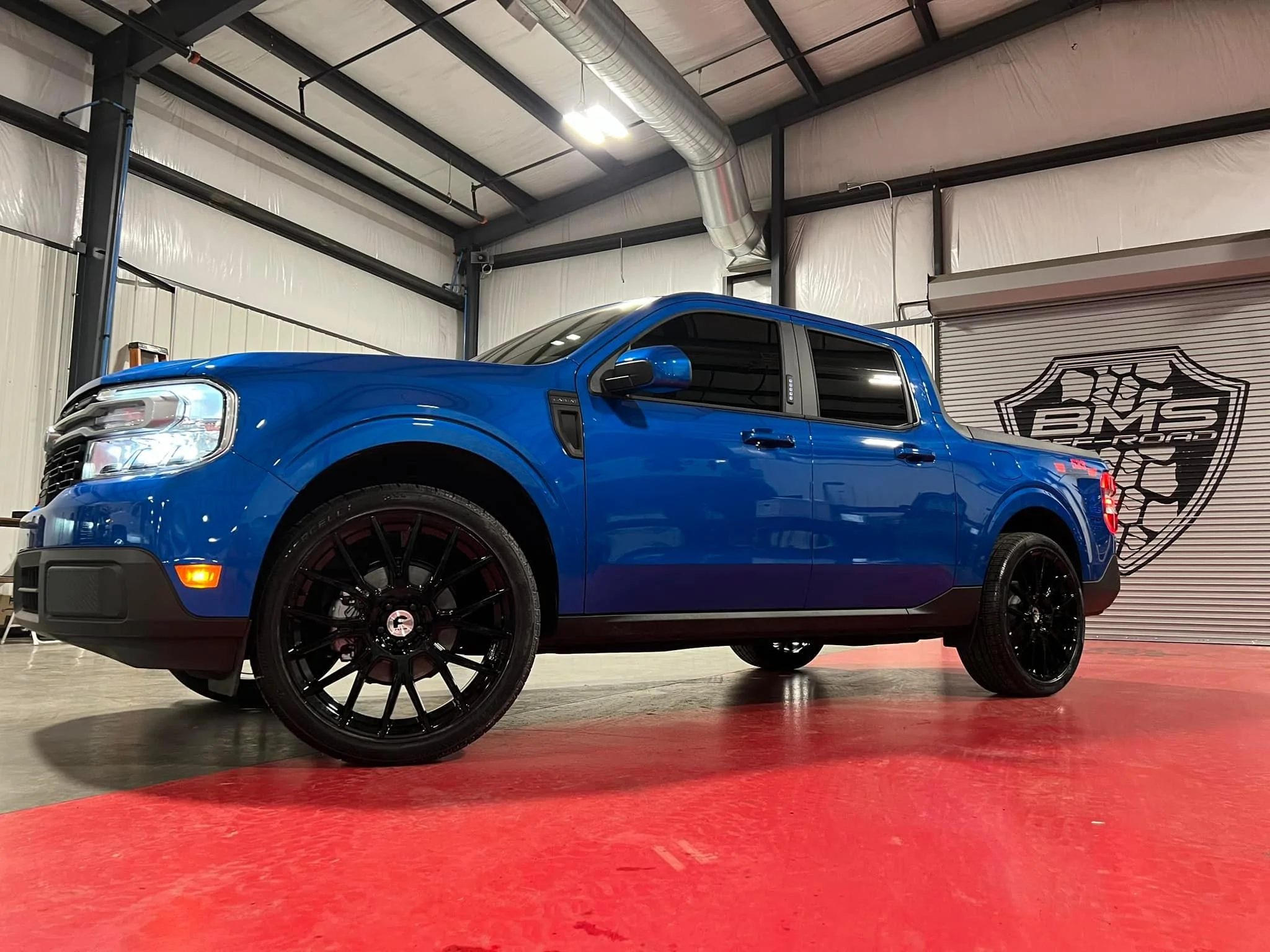

22's on Maverick Lariat.
Wheels: 22x9 Forgiato Flow 001
Tires: 265/40/22
Owner says there's a little rubbing (no surprise).

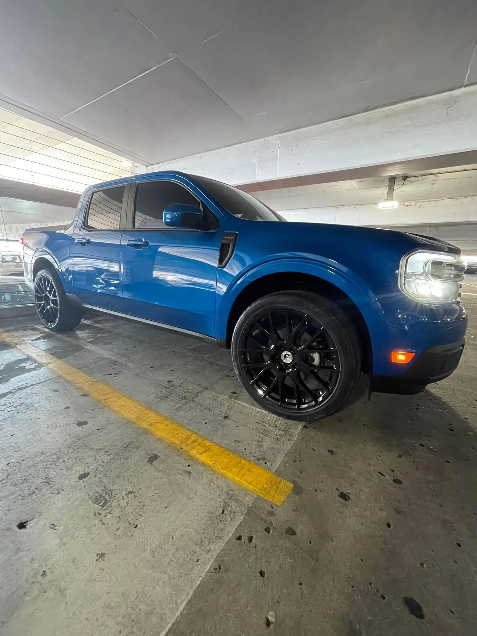

Imho.... 22" wheels are not to big. The width and aspect ratio of the tire as well as the offset is why he is "rubbing".
I'm on 22" wheels but measured everything prior to selecting wheels and tires and no rubbing anywhere. Diameter of my tires are the same as my stock 18" wheels are. The Maverick is quite shallow in the rear wheel wells so you cannot go too wide without rubbing the inner plastic fender wells. I went with 255/30/22 for a more sports look rather than rugged (hey its unibody construction anyway). I know its not for everyone and that's ok... we each have different tastes. I also have a 2016 F150 crew cab as well as a 2021 F150 single cab, both lowered and on 24" and 22" wheels respectively. It's just my style...but I will be special ordering a 2024 Ranger that I plan to build as my 1st slightly lifted truck. Excited!
This is my Mav on 22" wheels..... go easy

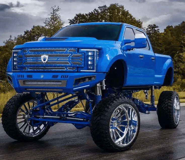

How does the old saying go?
Differnet strokes
Ford Maverick 22" wheels on Maverick... there's such thing as too BIG 1675195684505
For different folks
Ford Maverick 22" wheels on Maverick... there's such thing as too BIG 1675196289530
God bless America!

22x9 255/30/22 +40 et w/Michelin Super Sport S4 tires.

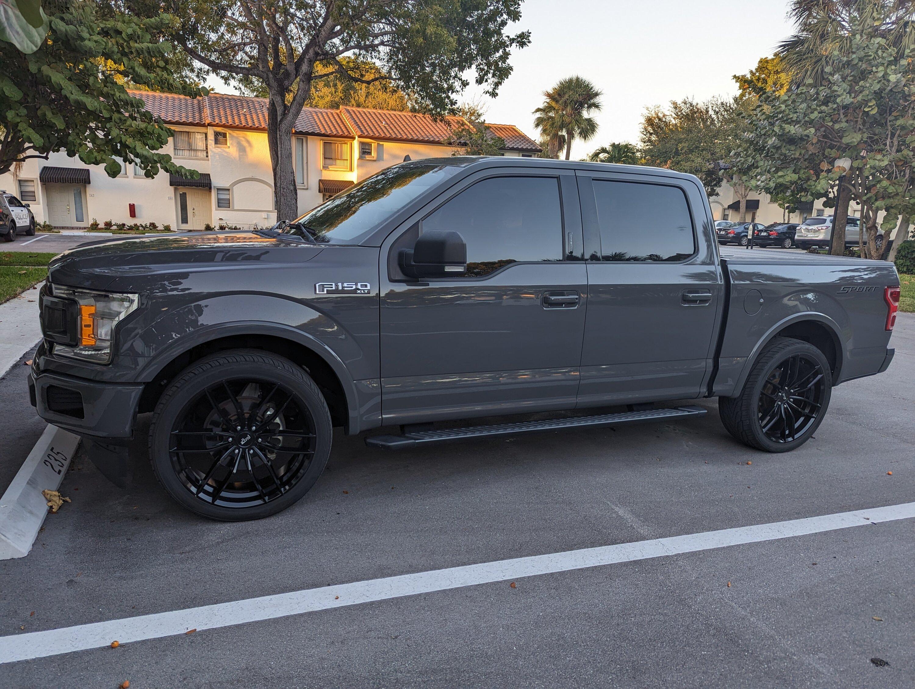

I believe you said they rubbed... Is that due to Wheel, tire or both? I don't want to mod anything I just want biggest wheel tire combo that fits properly. I had 24's on my f150 sport and I loved the look and I got people stopping me all the time about my wheels and how it made the truck look badass. I got some hate too but most comments were extremely positive

Me? I never said my wheels rubbed. I've never had an issue with this setup rubbing. Not even a lil bit.
