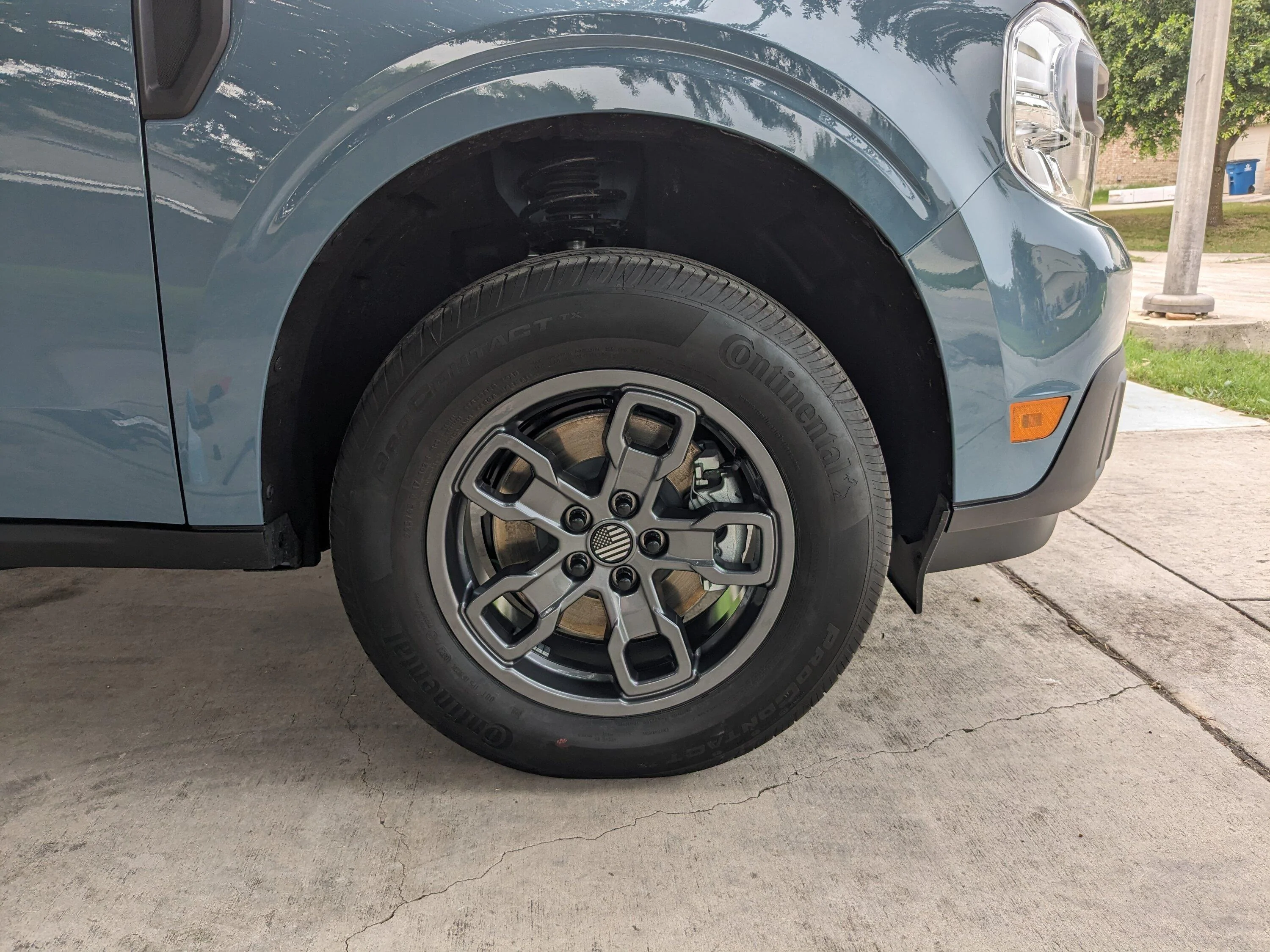

I got my Maverick with steel wheels, but always planned on replacing them (I don't like the look). After watching for a couple weeks, I finally found some Bronco Sport (Big Bend) wheel and tires (new takeoffs) that were local to me and at a good price. I'm very happy with them. Nothing that hasn't been seen before, but I figured I would post what I noticed for anyone going down the same road.

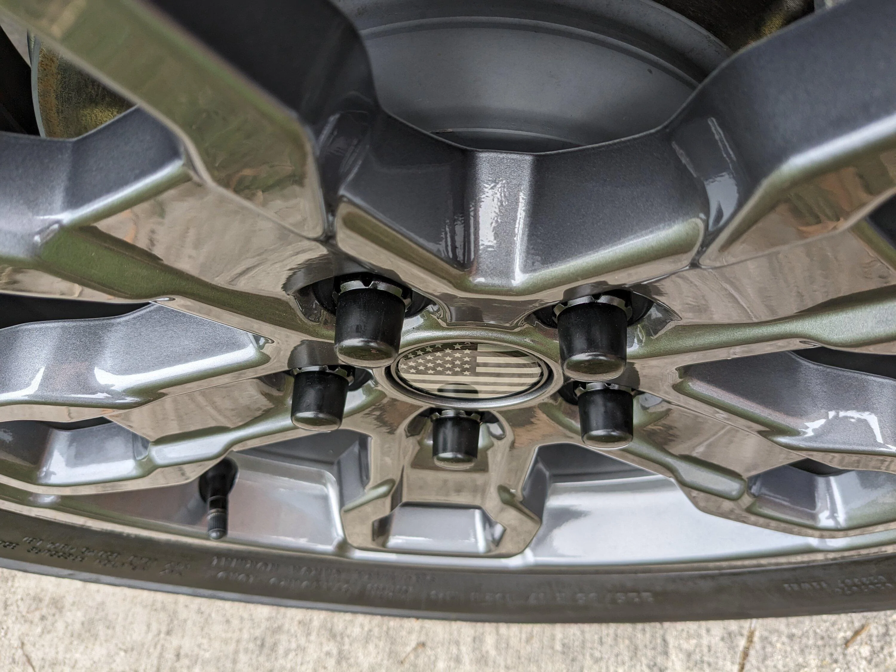

I bought the 1.5" length nuts, because that is what most people seemed to recommend here. I didn't want to risk having to return something that did not work (had also been looking at 1.38"-1.45" closed lug nuts). The 1.5" are more than is needed, and shorter ones would work fine. The open OEM nuts are just over 1.2" long, and the studs do not come out of the open end of the nut when they were used with the Bronco wheels. Aftermarket lug nuts may engage deeper in the wheels than the OEM (the "feeling like they fit better"), but its probably not much. The 1.5" ones I got are longer than needed, but not so much that it bothers me. If I was to order again, II think I'd feel comfortable getting 1.4" or maybe even 1.35" nuts. Here is a picture showing how much the 1.5" nuts extend.
