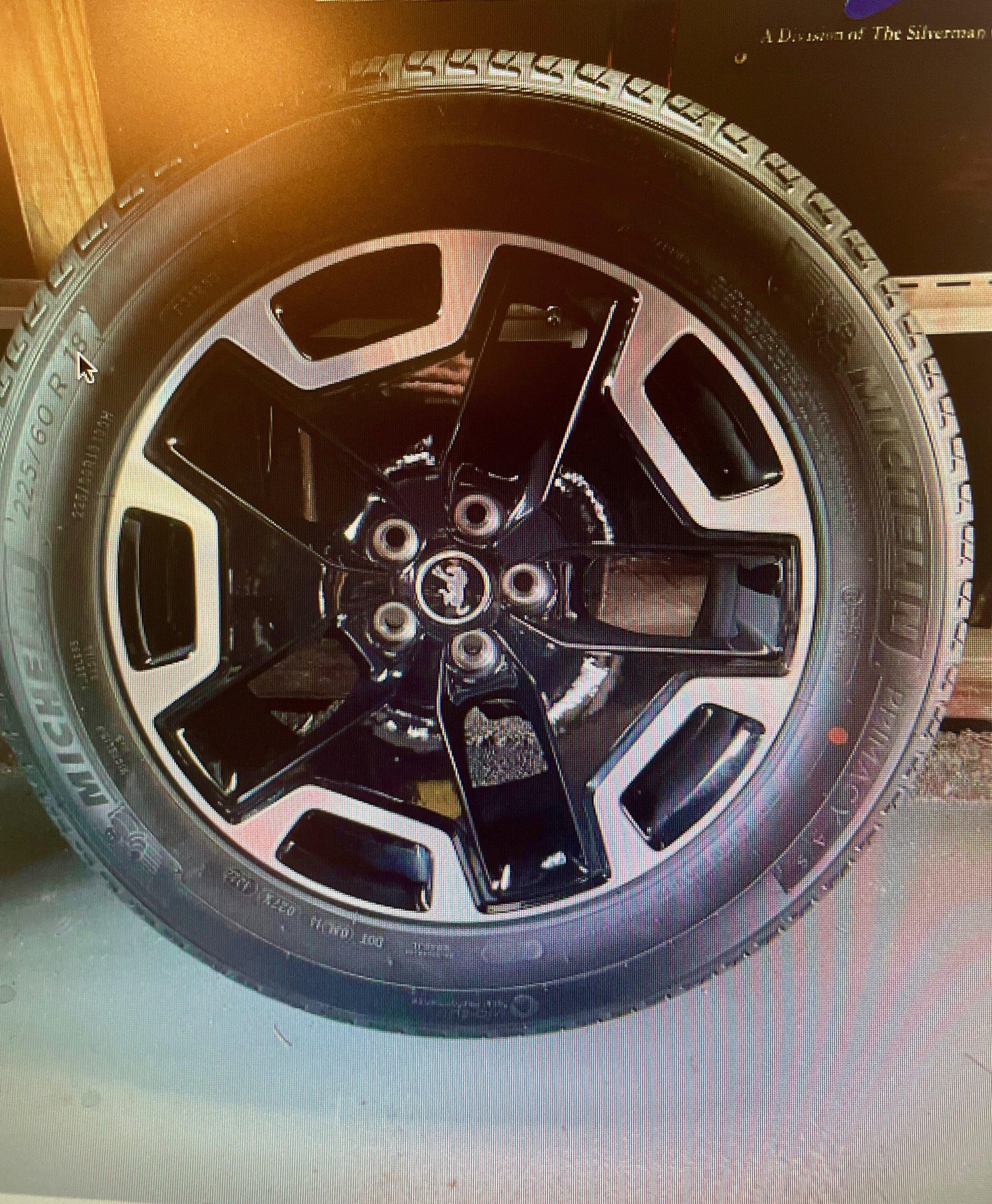

I just purchased a set of new take off 2023 Bronco Outer Banks wheels and they are going on my 2022 Maverick XL with currently steelies. Can anyone direct me to a set of either all black or black with Ford logo center caps that will definitely fit these wheels? I attached a picture of one of the wheels for reference. I ordered a set of Gorilla 71643NBC lug nuts after a little research on here that I am 99 percent sure will work. Seller used the TPMS sensors on his new wheels and I have a set of Motorcraft sensors coming so I can just bolt these on and do the relearn and go. Anything I missed?

6M21-1003-AA should fit perfect, I contacted a seller on ebay and that is what they recommended and they fit perfect. They're what I'm running on my XL with the same wheels:

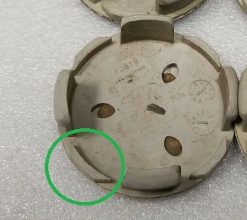

Also, if they look like this on the backside they will not fit:
Ford Maverick Bronco Outer Banks Wheels on 22 XL AWD Wrong centerca
They need to look like this on the back with this little ridge that is flush with the edge of the cap:
Ford Maverick Bronco Outer Banks Wheels on 22 XL AWD Right centerca

Thanks for the help NoVaJimmy, much appreciated!!! I ordered a set caps that look just like you described. Supposedly genuine Ford so hopefully the seller is an honest one. I pasted a link below to what I purchased if you want to take a look. Our trucks will be very similar, Area 51 with a soft tonneau cover. Also plan on the Kia mirror mod and got the Akro cubby phone mount, have the parts but need the motivation. Just a few other things I need, vent visors, hood deflector, wireless carplay adapter and a magsafe mount for the cubby mount.

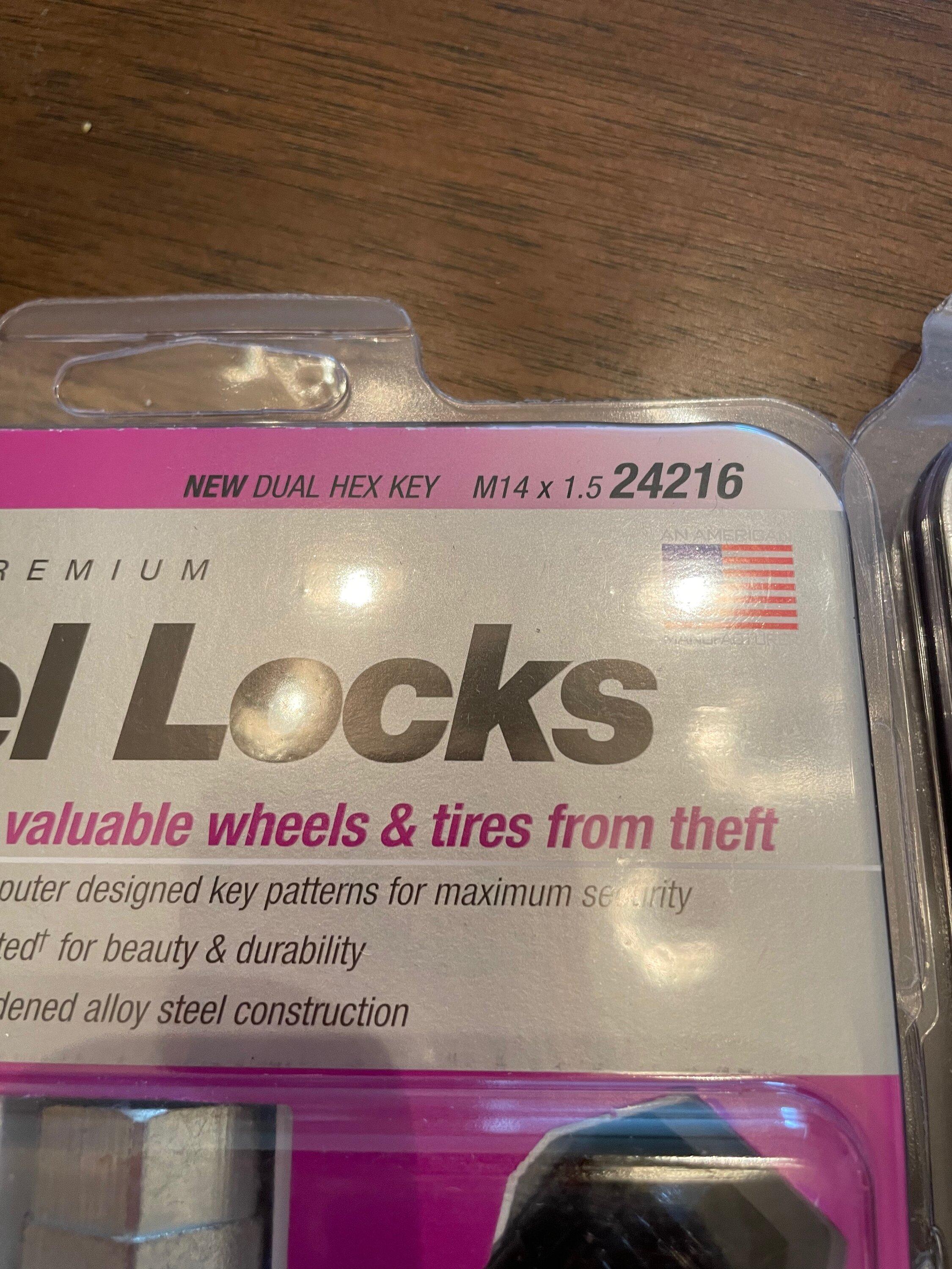

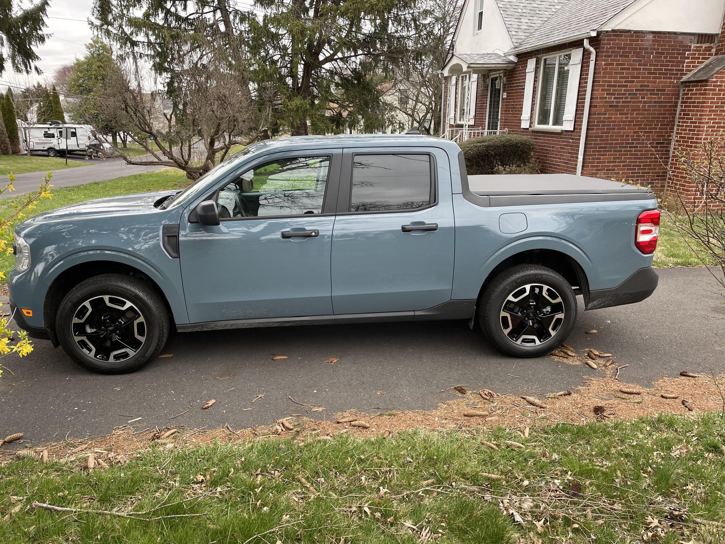

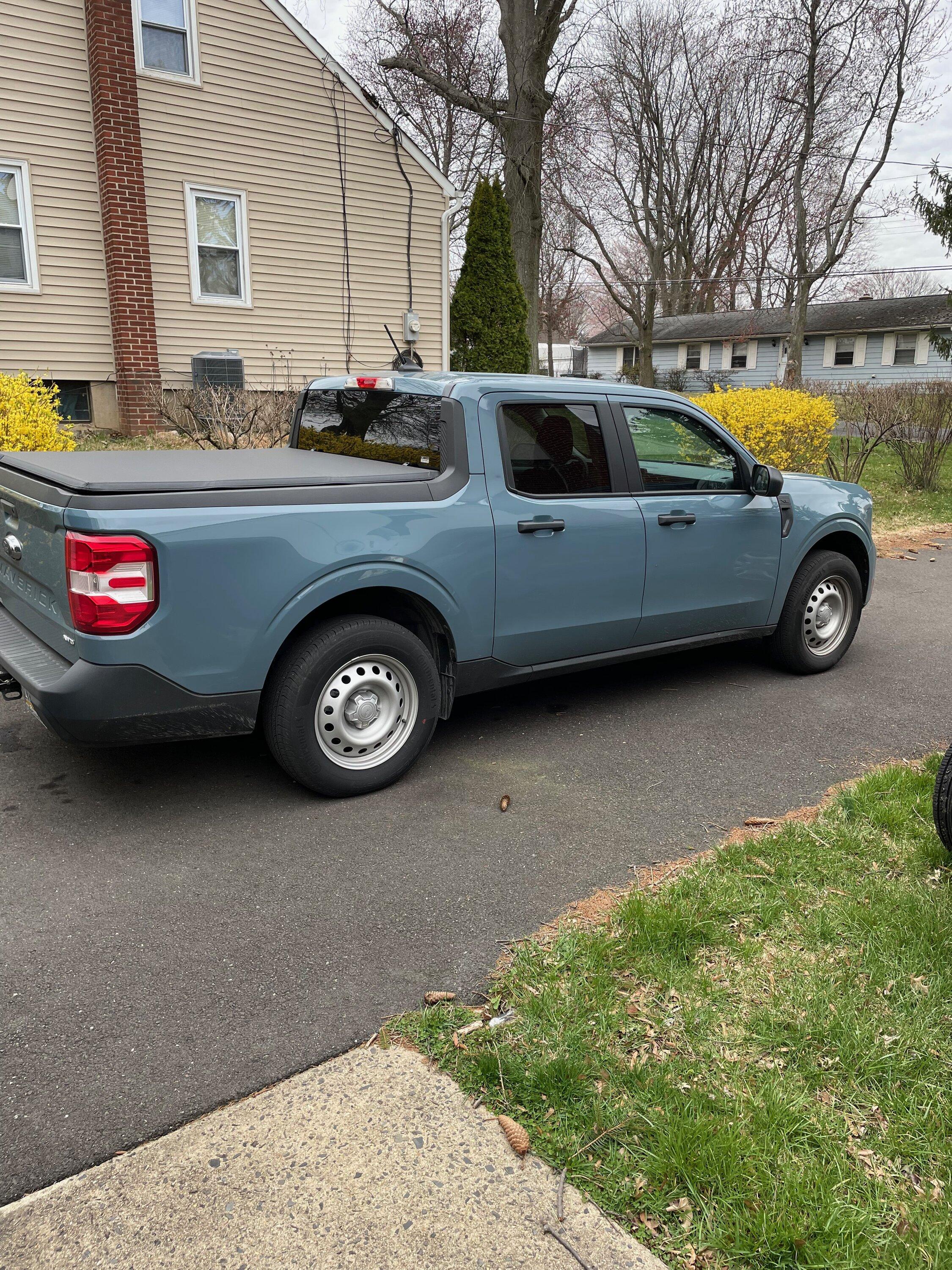

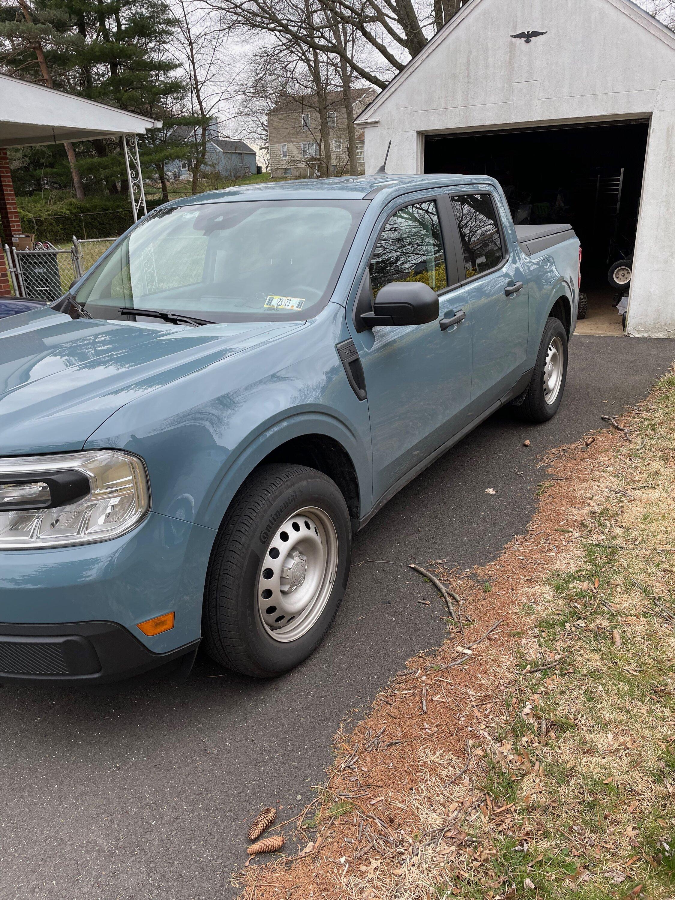

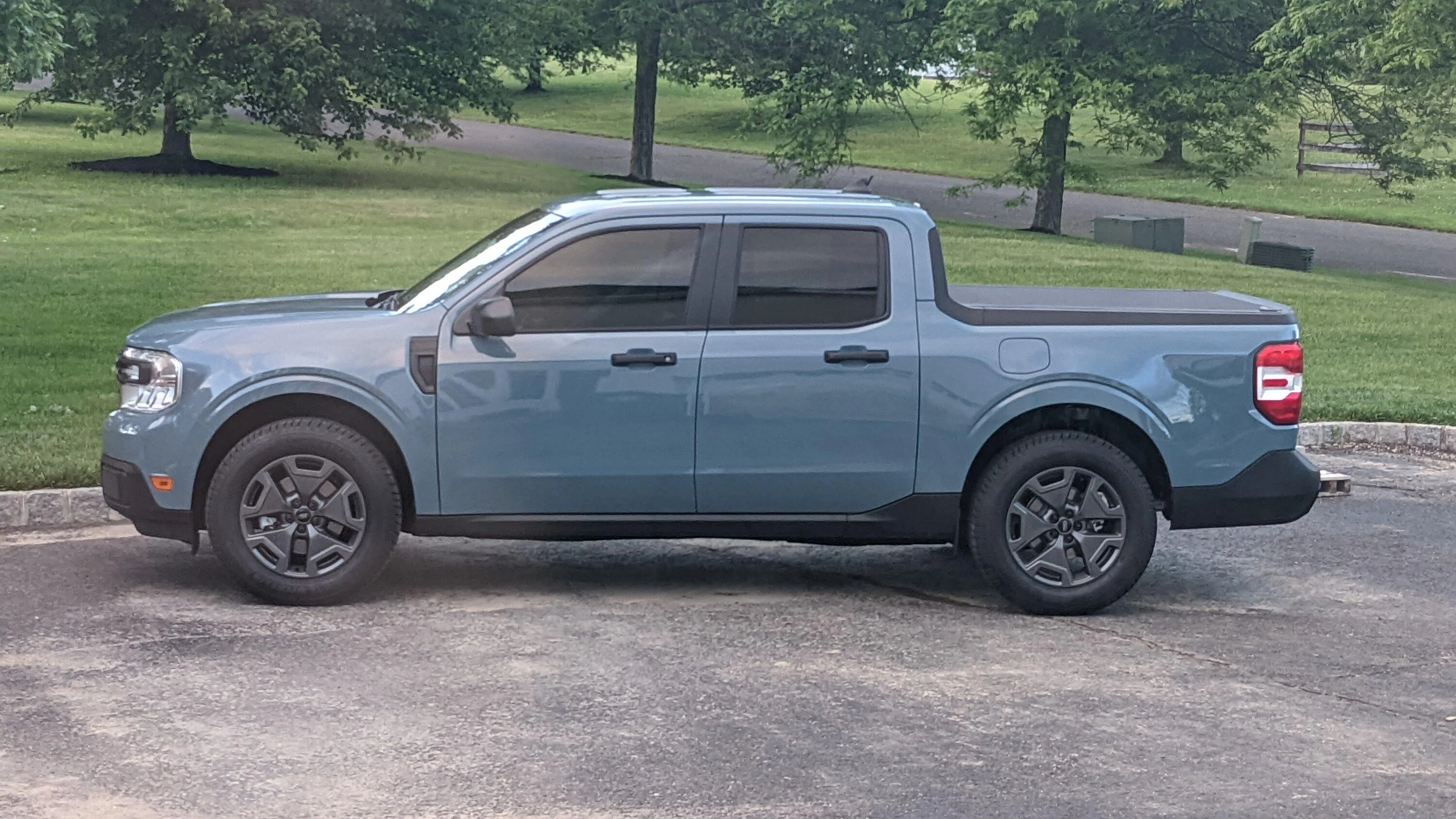

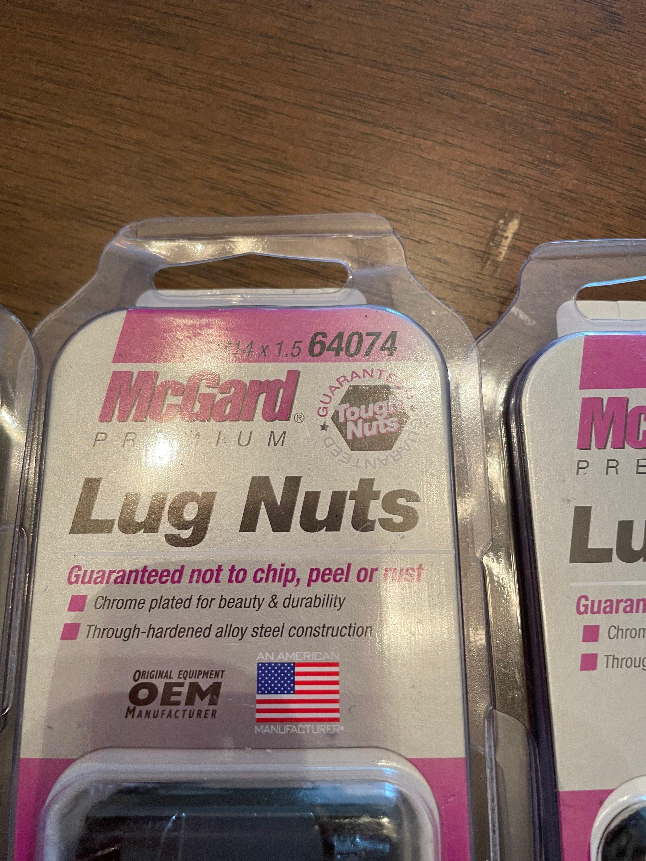

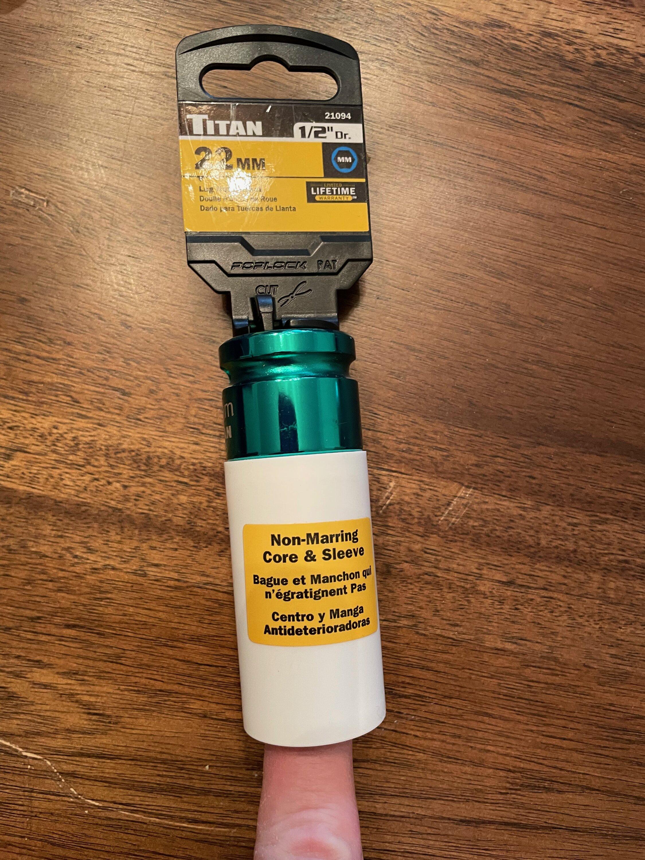

Finally got time to run to the shop and install the TPMS sensors on Wednesday . Had a little motivation this morning and swapped them over to my Maverick. Added pictures of what I used to do so, the TPMS are Ford/Motorcraft OEM I got on Ebay but I didn't save the packages but they are TPMS35. I think the black of the wheels compliments all the other black on the turck really nice.

Your maverick looks great with those wheels! How are the lug nuts holding up for you?

No issues so far. I have used their products in the past and never had any issues. First tire rotation is coming up and I will update if anything pops up.
