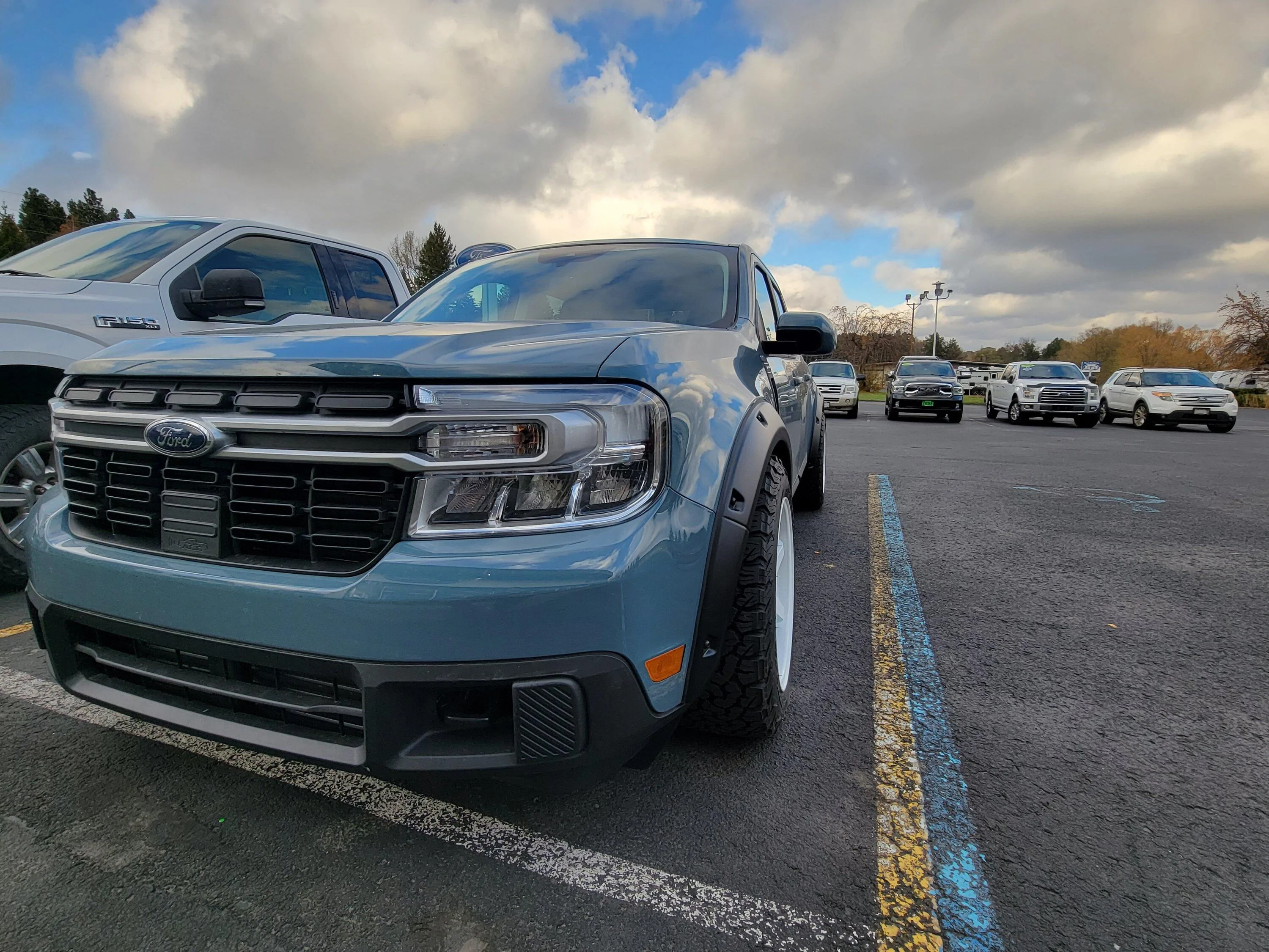

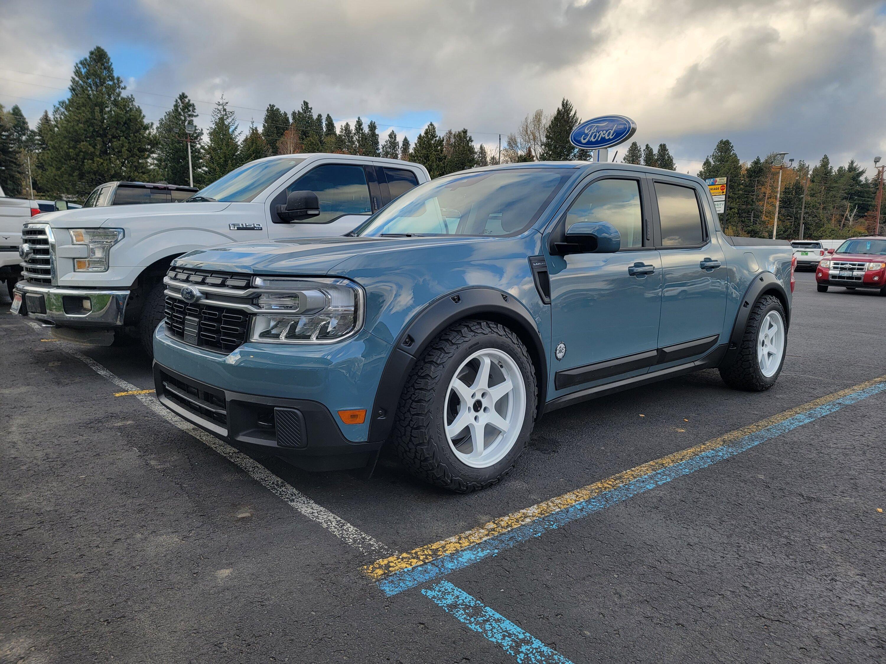

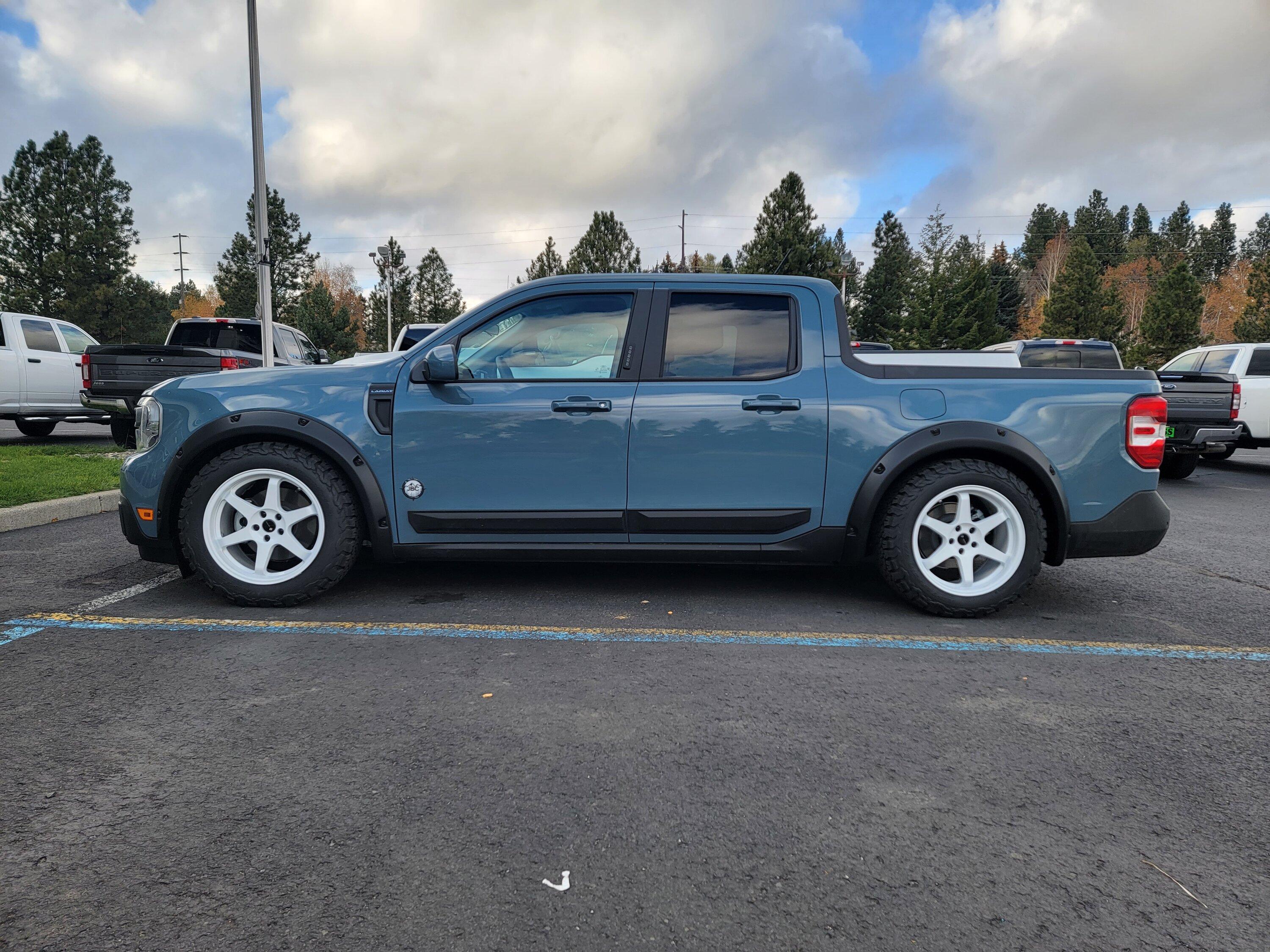

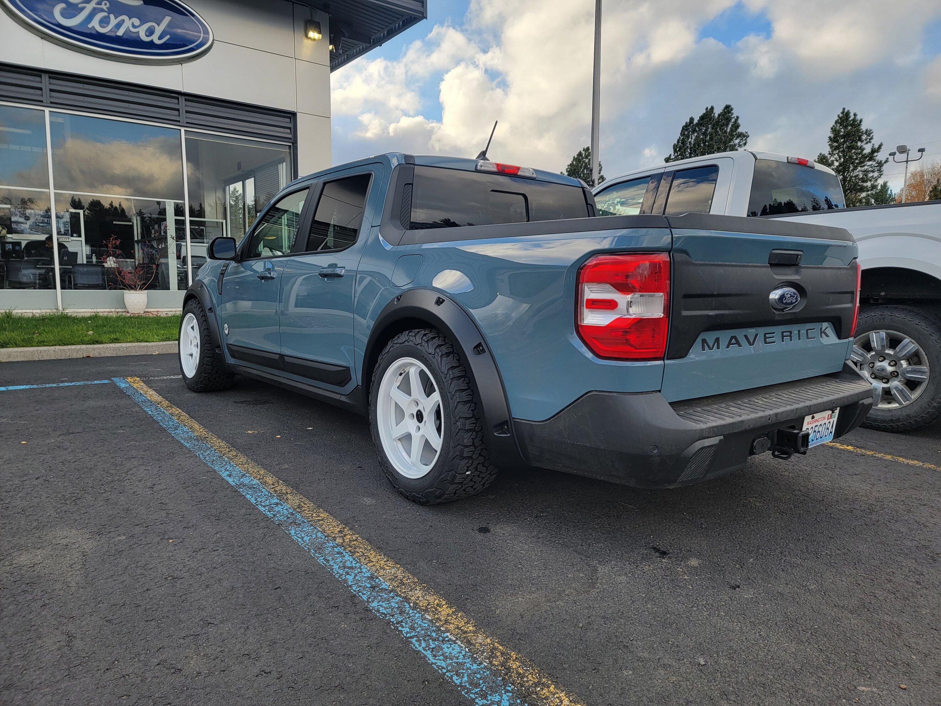

Just installed: Bushwacker fender flares, along with 40mm front and 50mm rear wheel spacers from BORA. A bit of fender liner rubbing on tighter turns, but not terrible. The body shop will do a little trimming to clearance in a couple of weeks. With the wheel offset, track width is now nearly 6 inches wider than stock.
