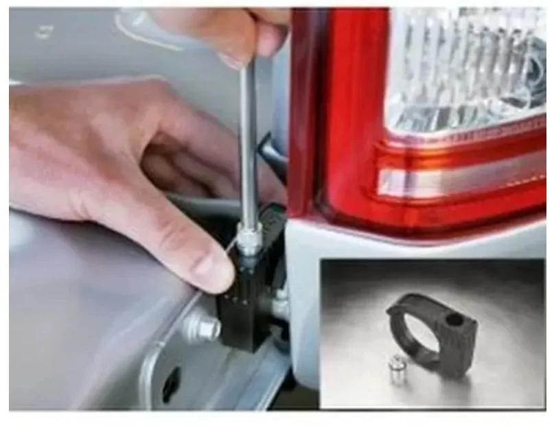

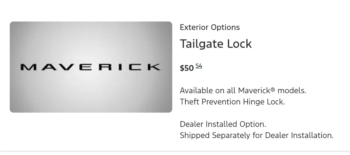

The remote lock (with doors) is standard on your Lariat. I think you may be confusing with the optional "hinge" lock that prevents the tailgate from being removed once open.
HRG
Ford Maverick 2026 tail gate remote lock up grade Screenshot 2026-05-31 172537
Ford Maverick 2026 tail gate remote lock up grade Screenshot 2026-05-31 172759

OK, but there is no remote locking "option" on a Lariat. Can you show what you were looking at?
