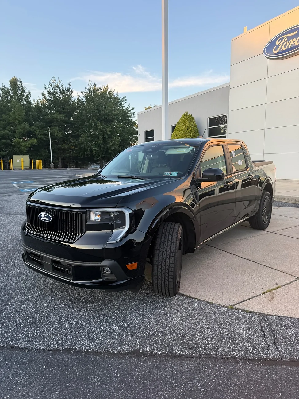

Hey all,
Just purchased a 2026 Maverick Lobo this past week and have just under 300 miles on it. Of course now since joining different online forums Im seeing the trans issues that people are having with the 2022-2025 EB models.
I’m assuming the trans is the same on the non lobo EB models, anyone with a higher mileage 2026 model having a premature signs of issues?
I just need to ease my mind a bit 🤣.
Factory warranty, no extended warranty.
