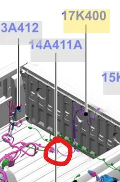

MosesP
Jul 25, 2024
138
202
San Antonio
Lobo
maybe you'll get lucky with disconnecting and swapping at this location
Ford Maverick 2025 XL auto lock tailgate. 1743620722396-l5
MTB916
Sean
Mar 5, 2025
Roseville, CA
2025 XL Hybrid AWD 4k
Unfortunately, I can confirm that the auto lock wires are not present at that location on the XL. Where did you get that diagram? I would be interested to see more of that schematic.
