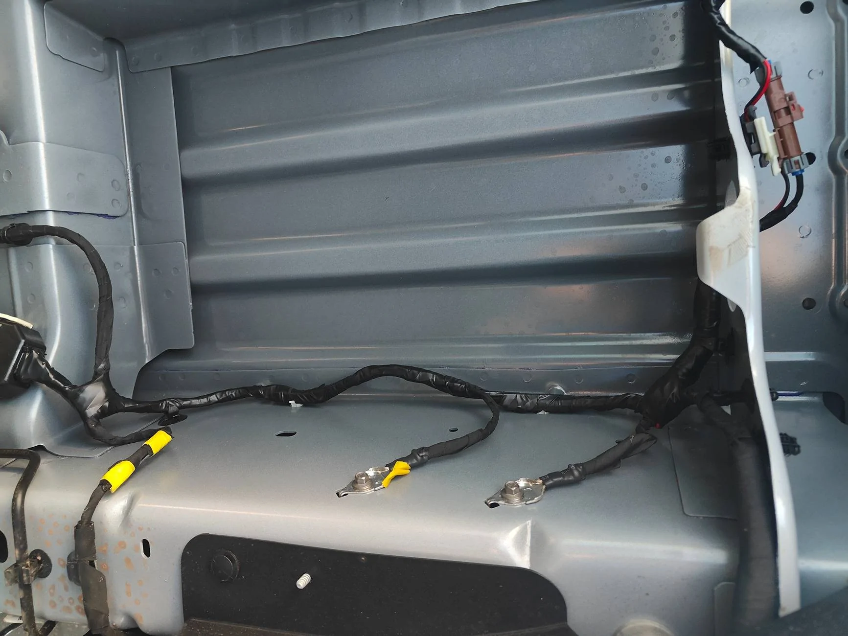

Since 2025 XL wiring completely different from XLT, and cable harness no longer an option after testing with multimeter connectors and cables under the bed.... Running a separate double 20AWG wire is the only option for and to install power tailgate lock. I used standard Ford Ranger/Maverick 22-25 powergate lock, 20feet of 20AWG wire, electric tape, mash fabric tape, a few zip ties, heat shrink cable tubes, electric cable pins, heat gun, soldering gun, glue gun. I had majority of items already in my possetion so minimal cost. Took me about 4 hours from start to fish with clean up. I would say it cost me about 150-180$ for all items. Let me know if you have any questions.

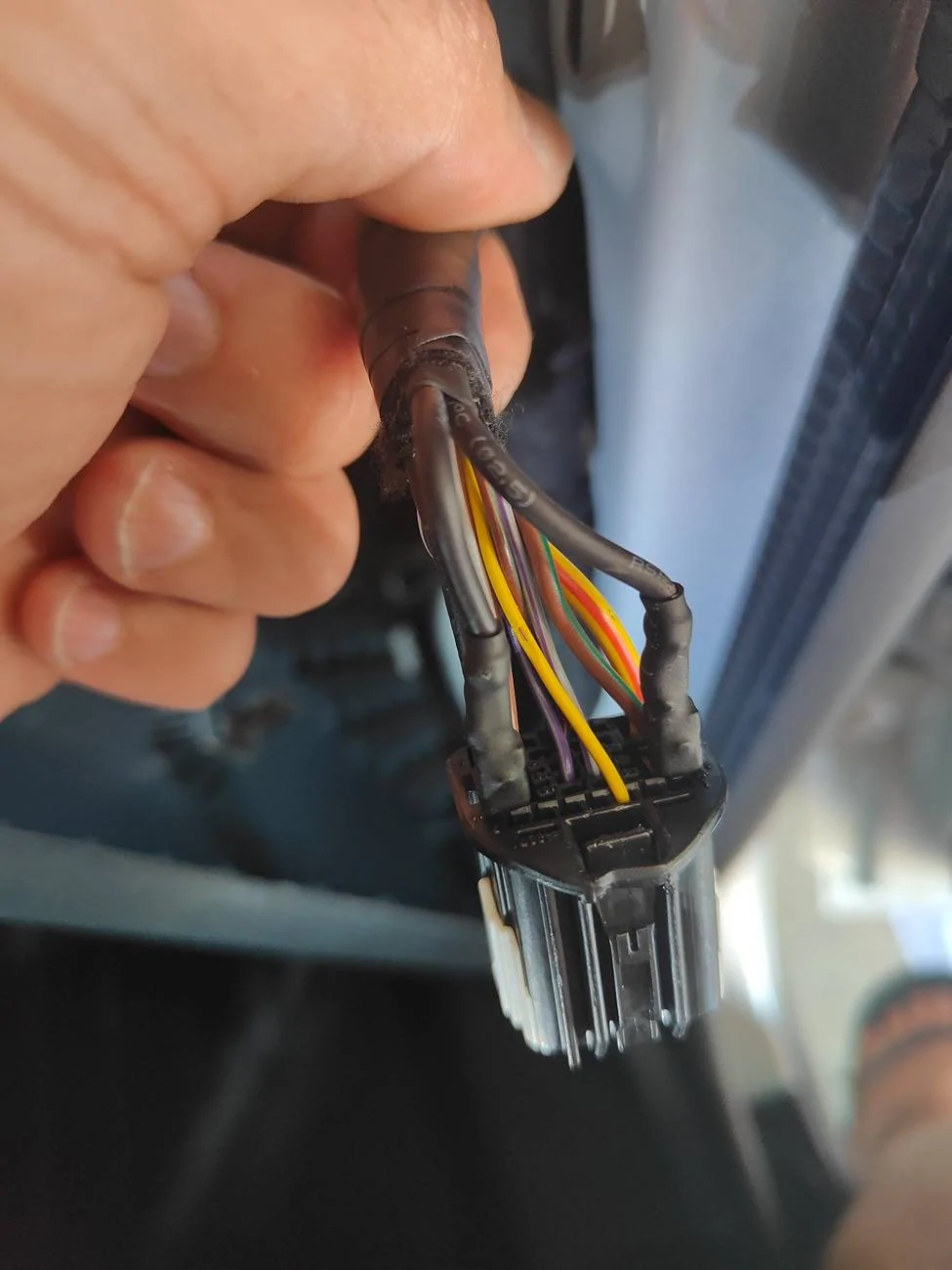

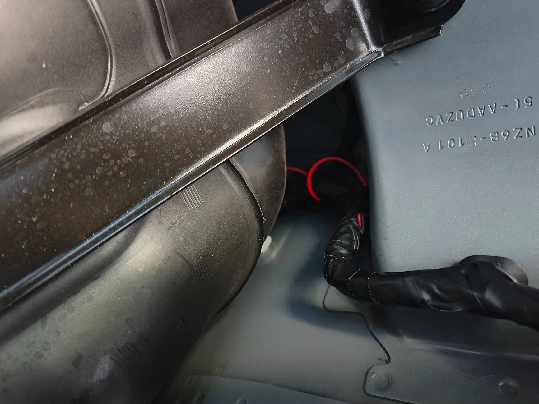

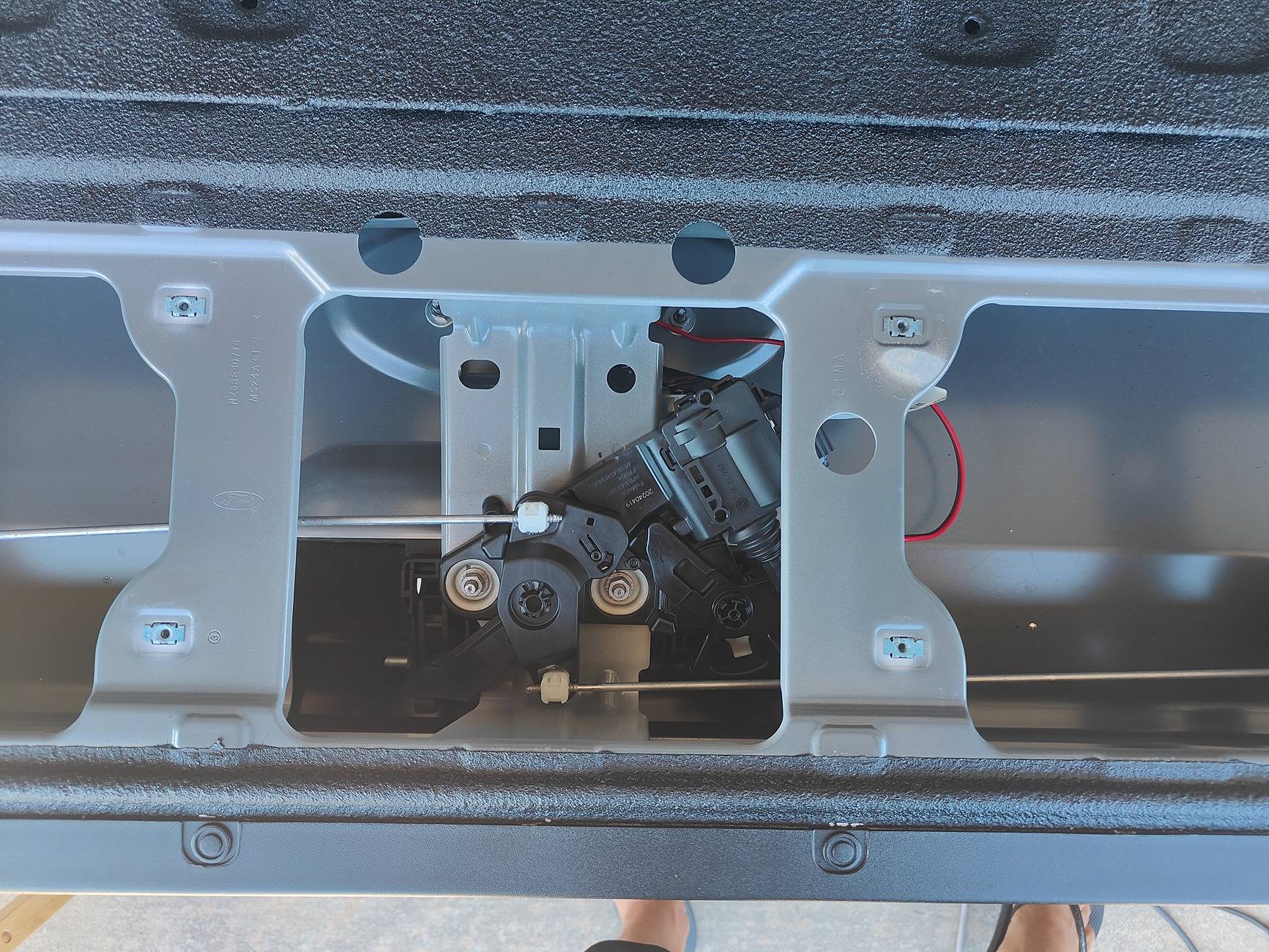

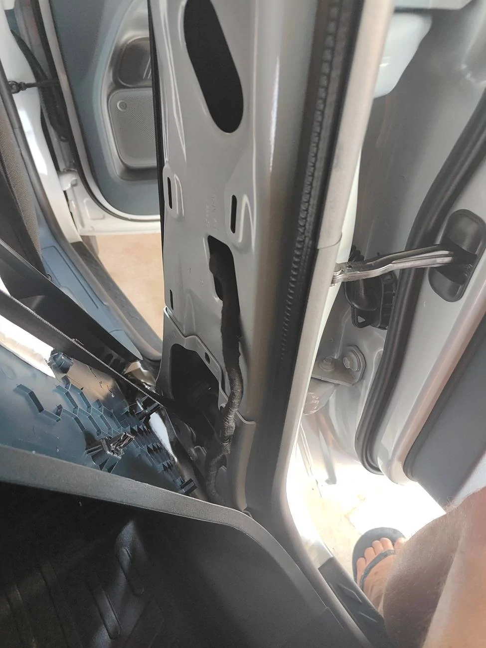

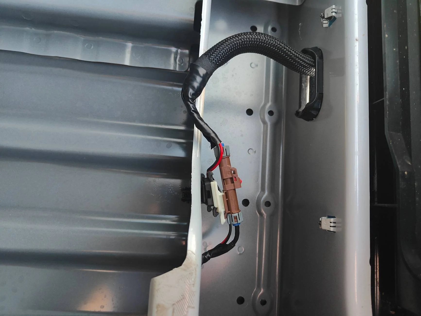

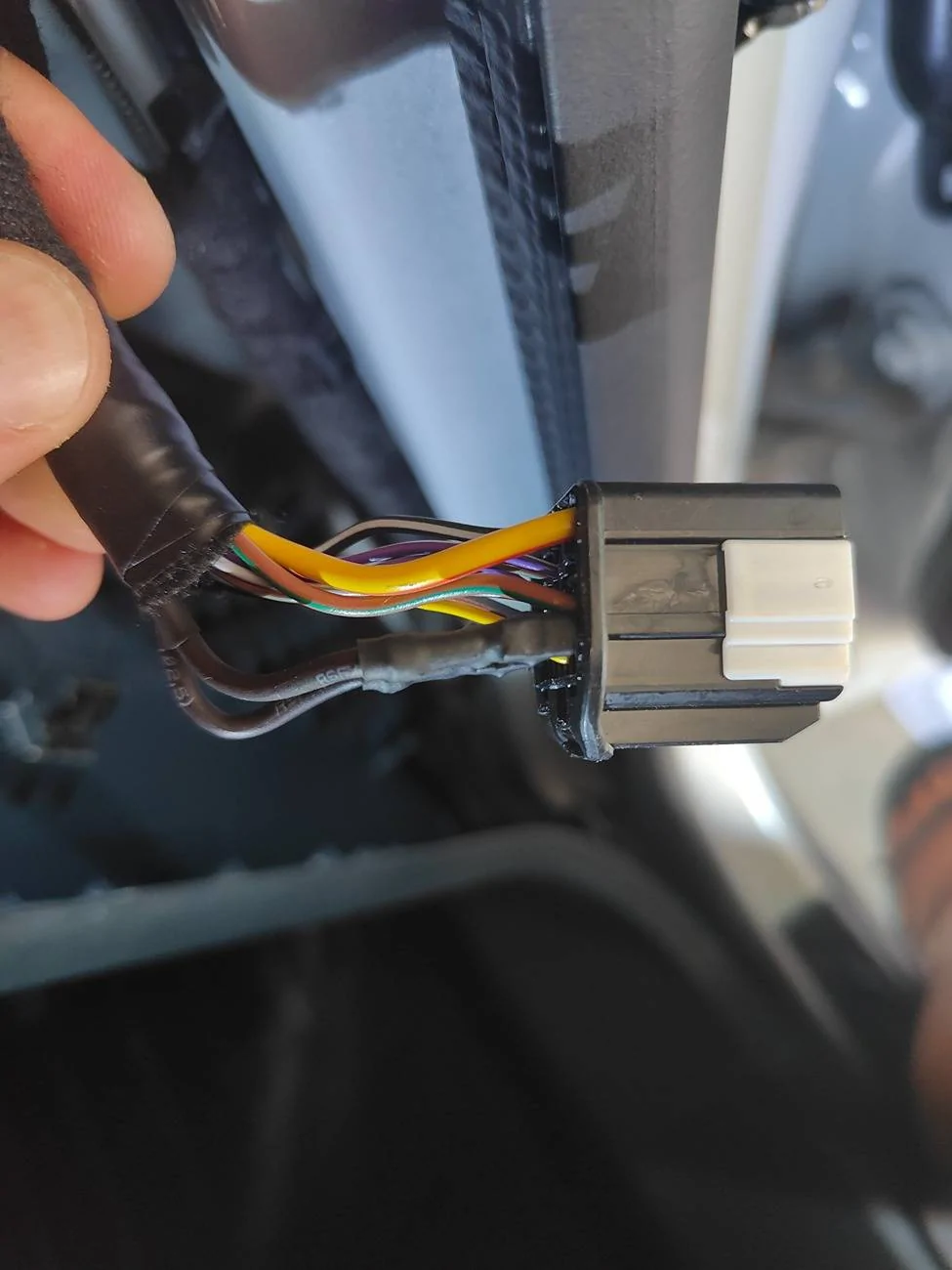

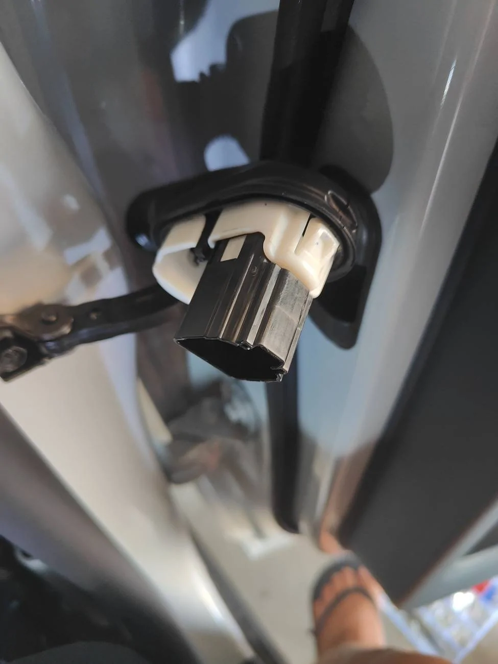

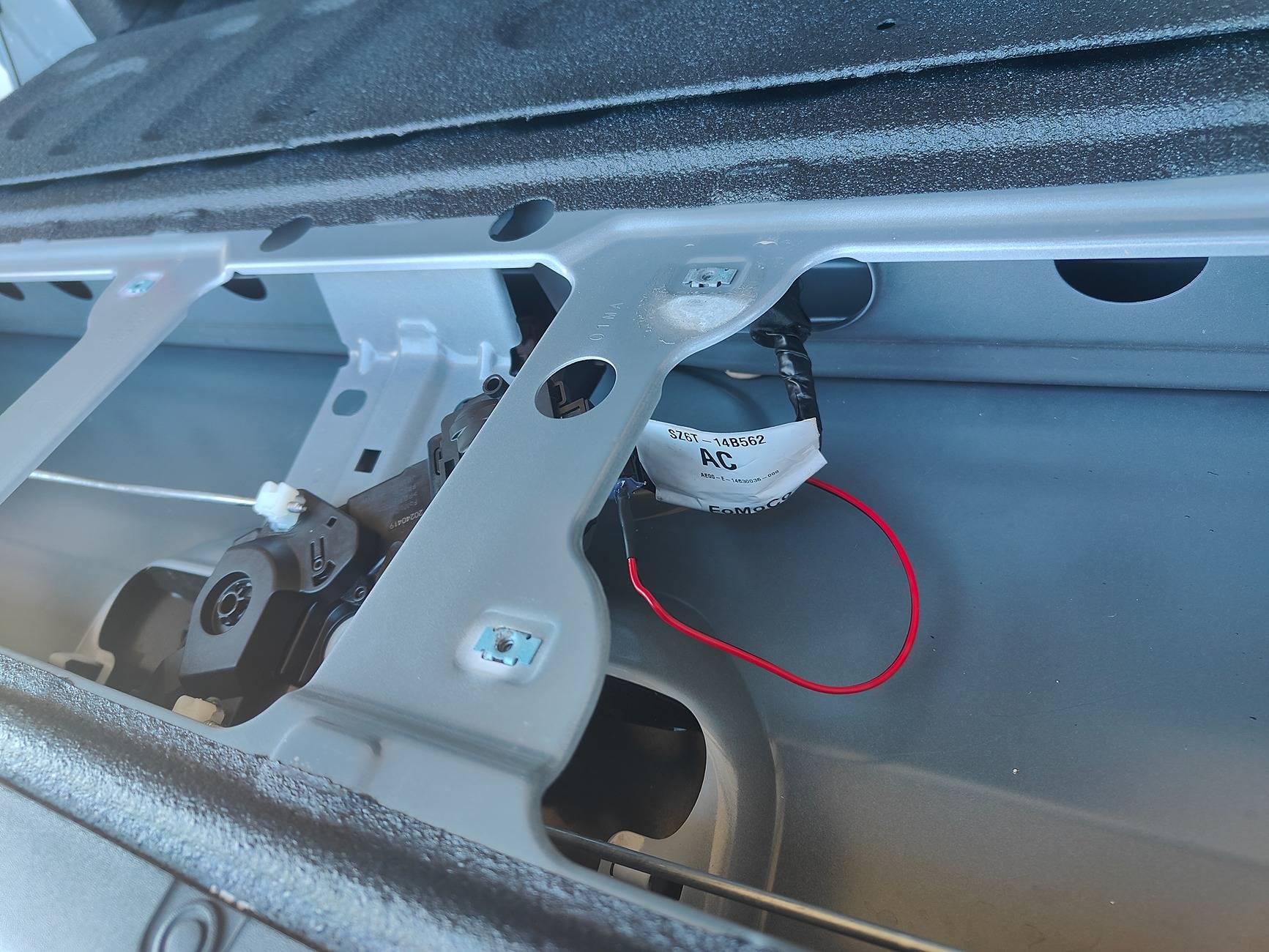

OK..... In the First 4 pictures is the location of the cable, and place/wires that I used to connect gate wiring. Last 3 pictures just how I made a connection to the actuator. Pictures in the middle just how I run my wires in conjunction with the main body wiring harness.

I am hoping this will make sense when I am looking at it but can you tell us more about the wiring in photos 3 and 4? Do you recall which wires you connected the new Red and Black to? Are those 2 wires specific to the polarity in that plug?

Sure, when you pull and disconnect connector from the door it will be 2 largest Gauge cables on the side, they are responsible for locking and unlocking door lock. It is easy to run cable from inside to outside just because of the cable need to go from under the seat to outside at next to the fuel tank, and it's almast impossible to do from other side. If you connect cables incorrectly, your back gate will unlock instead of locking. Only 50% if you do it wrong. Initially I did it wrong. If you did it wrong as I am, just siwitch places of those 2 cables by the passenger door before sealing everything.

And using that wire connector kit/pins was a big game changer since I don't have 2 splice and cut original wires. They have lots of options in the kit that you can just plug into Mav connector securely.
Same for the back lock itself.... Find a female connector and use a heat shrink to plug and secure to the lock connector. I used hot glue just to provide an extra guarantee.

Thanks so much for the clarifications! The plug kit looks key to the process it is on the way from amazon as I type this lol.
