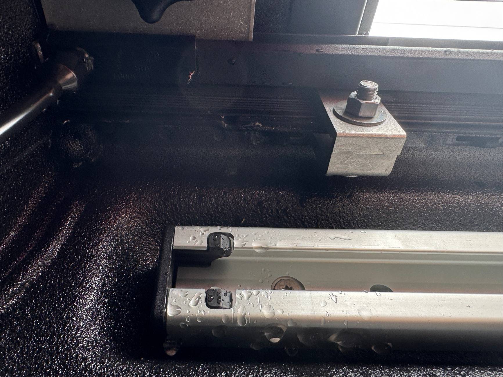

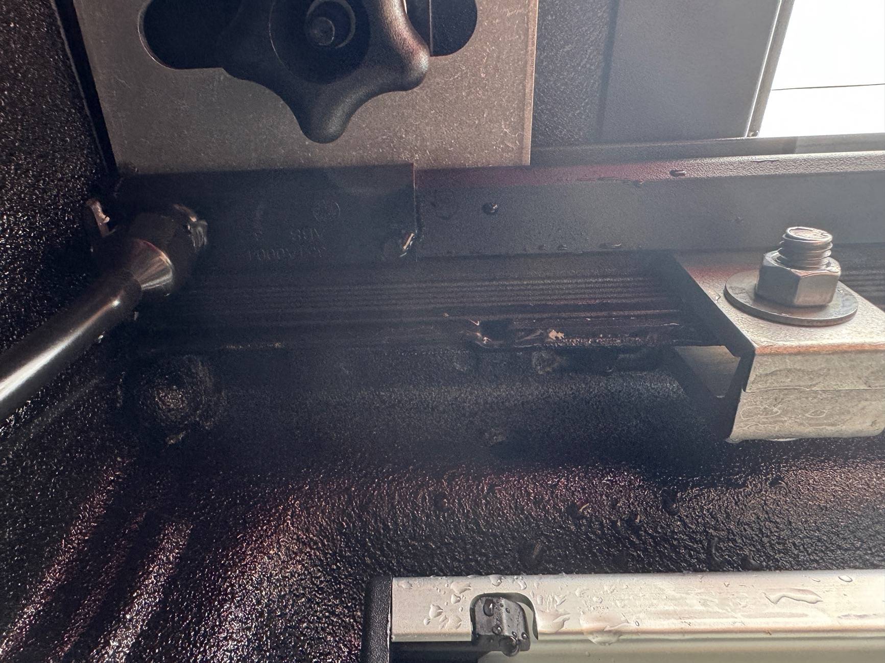

First decent rain last night since getting my Mav in Jan and having significant leaking at the cab end, especially passenger side. Anything adjustable here?

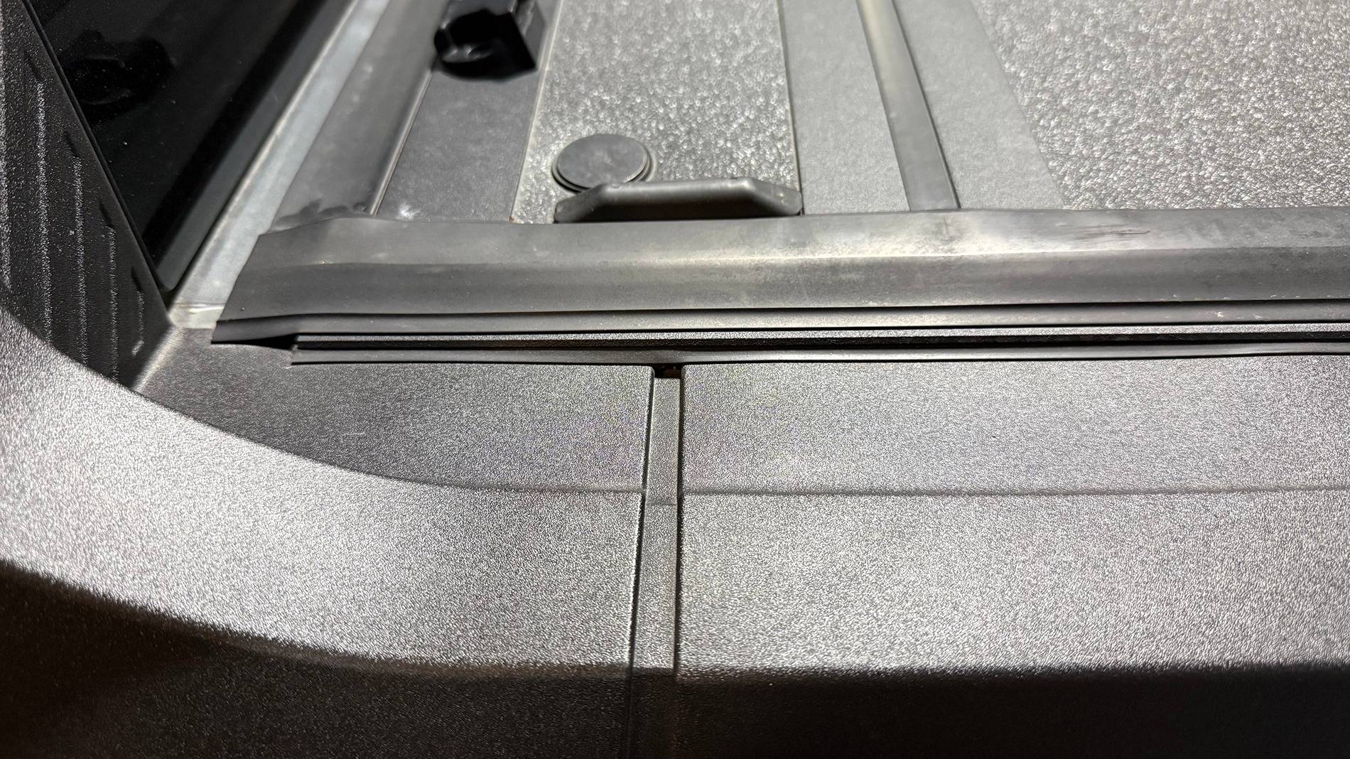

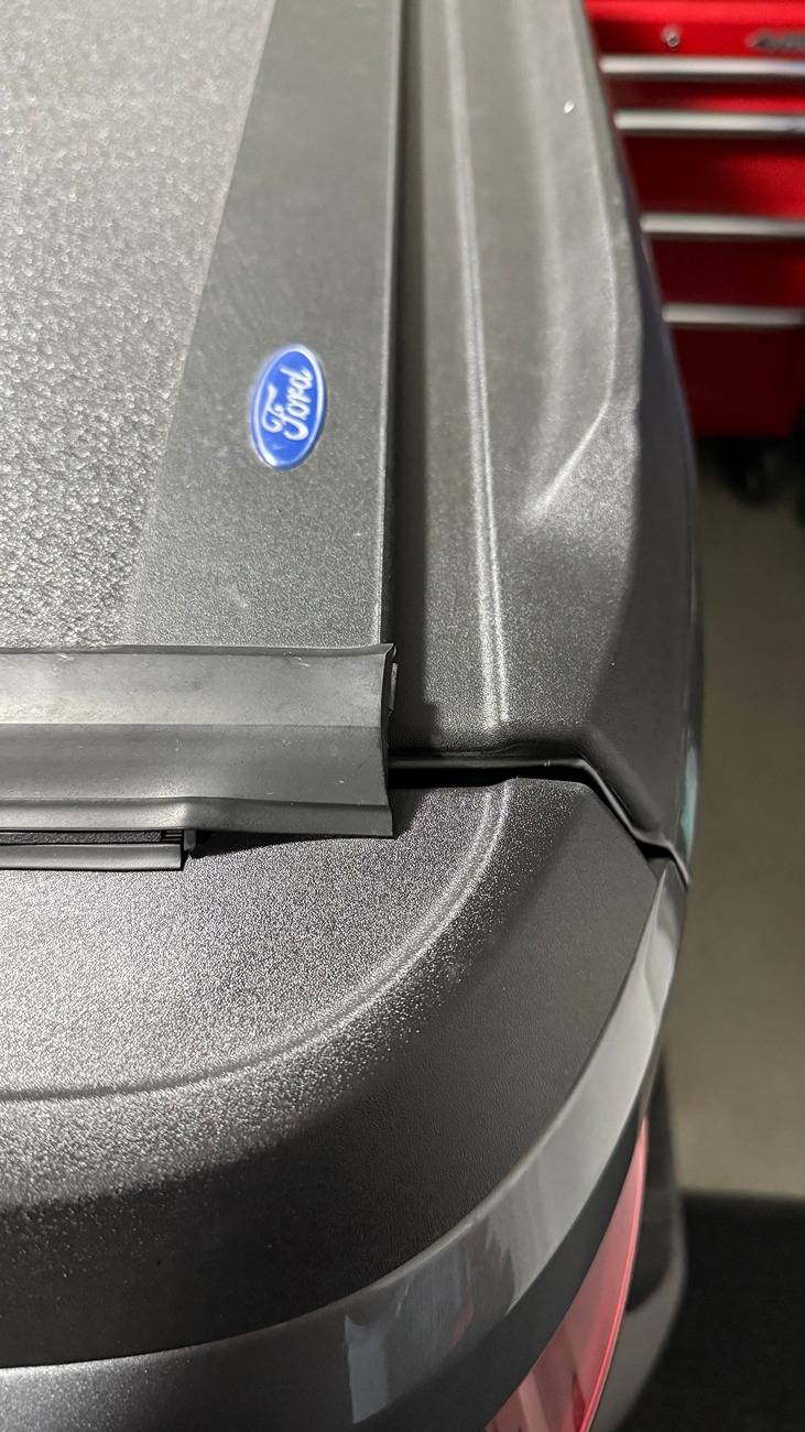

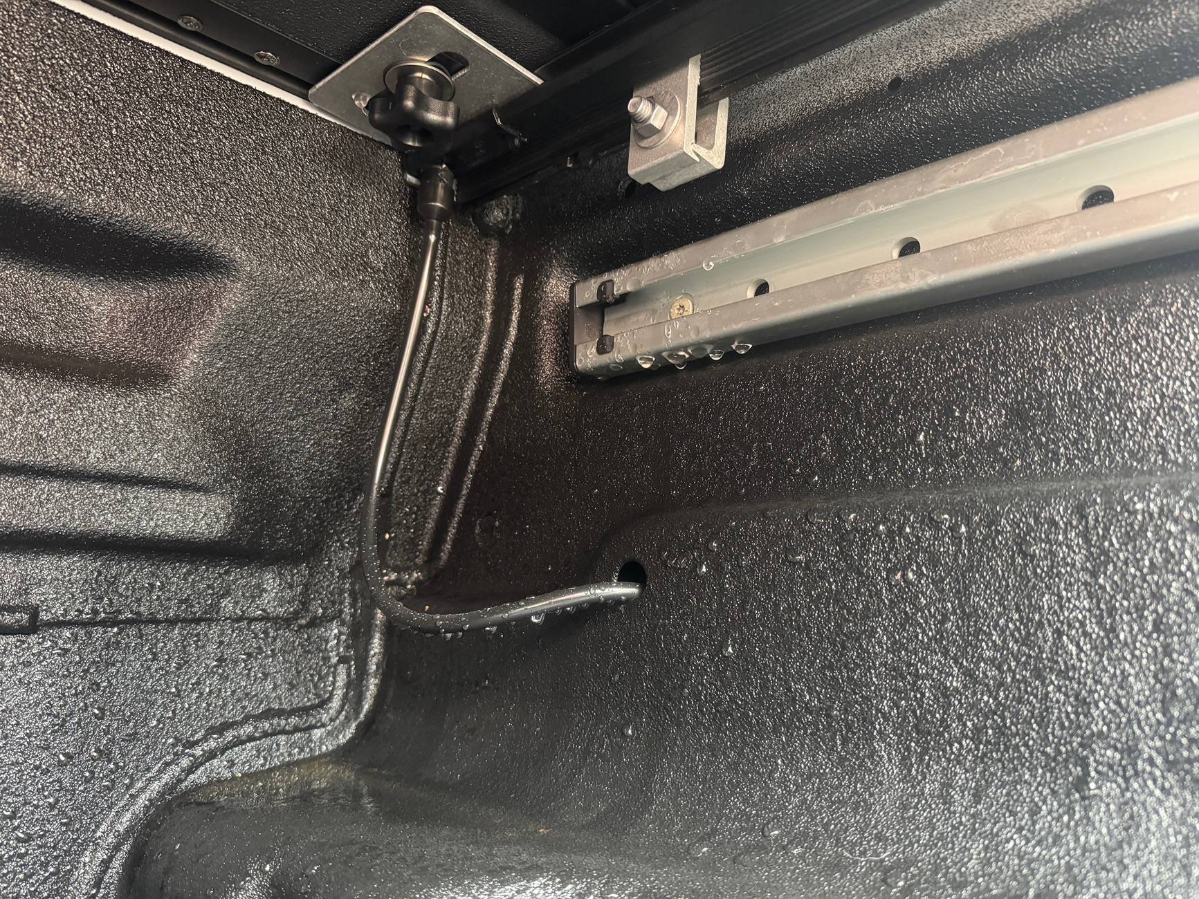

I have the Ford Tri Fold on my truck and I have very minor leaks. It did leak a bit more before I made 2 adjustments. 1) I untightened the two knobs near the cab and repositioned the cover a little further back to allow the seal at the tailgate to seal better. 2) Inserted a small piece of black closed cell foam into the channel they made on the plastic trim around the bed (pic below).
I also keep anything I don't want to get wet in storage bins with locking lids in the bed, like ropes and tie downs etc.

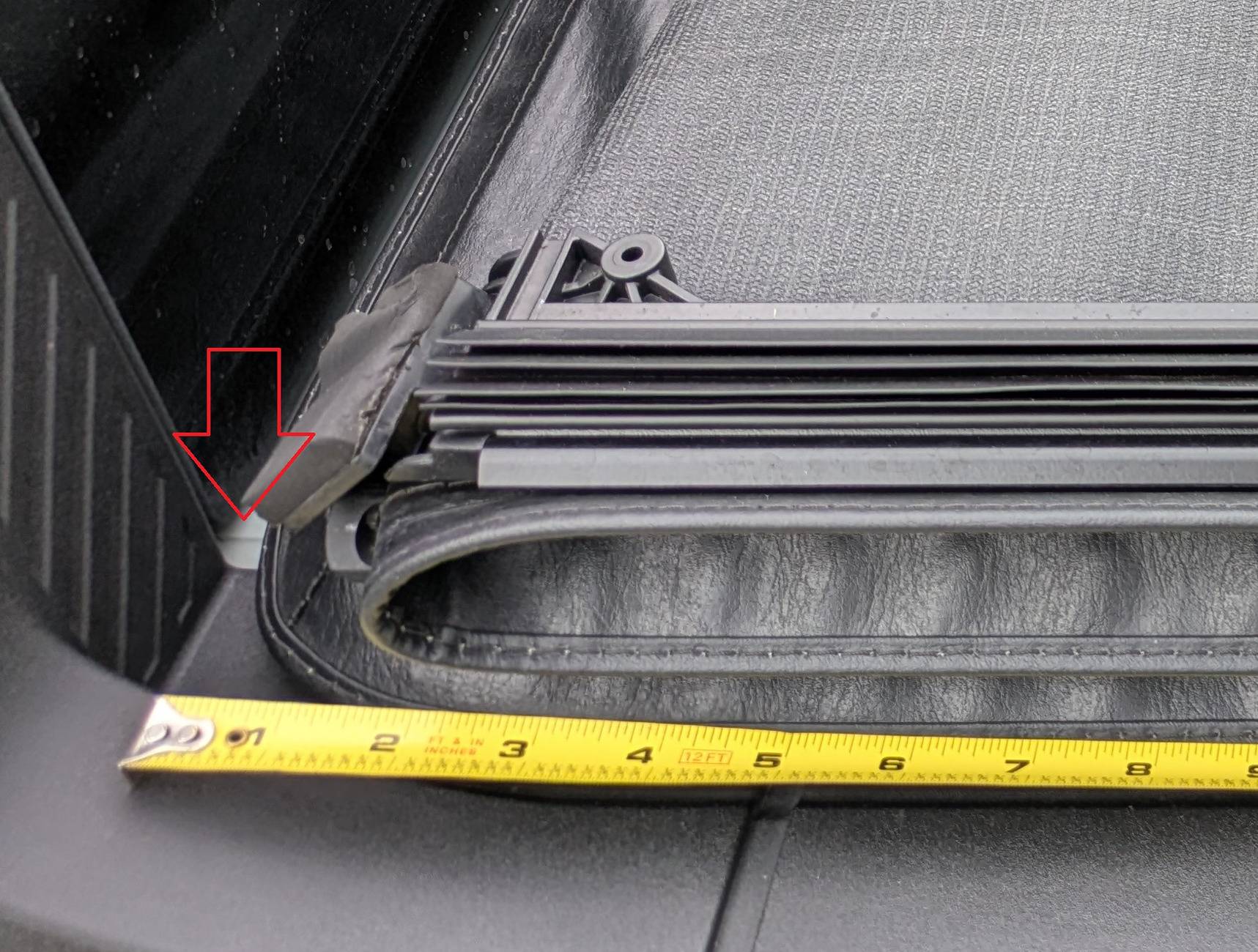

One question I have is how much paint should be showing below back window to front edge of tonneau cover?
roughly a quarter inch.

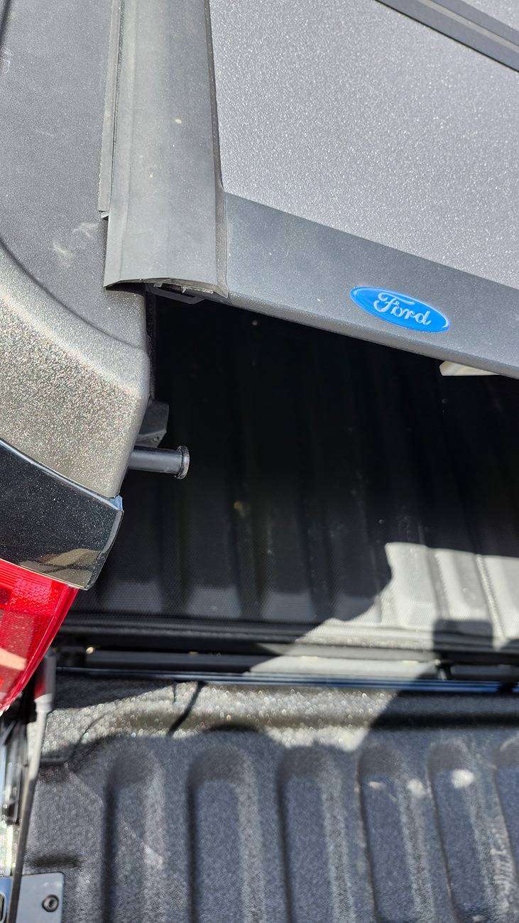

My Mav is about 3 weeks new and I noticed a big water leak where the edge of the seal meets the tail gate. Is this normal? It's a Ford factory trifold install. I'm not talking about some dripping, I'm taking about a significant amount of water penetrating into the box.
Anyone else having this problem?

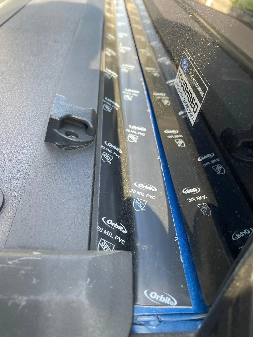

I'll probably get roasted for this, but I've always felt that my MX4 is 1/2"-3/4" shorter than it should be, to have enough overlap at both ends. I finally decided to slide mine back, to get more overlap at the tailgate, and found this 20 mil thick PVC tape to seal the edge at the window.
