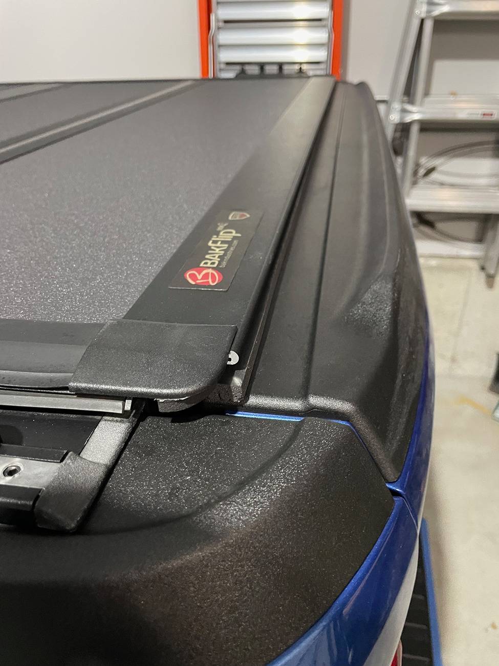

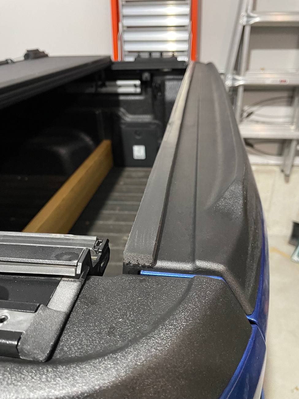

I wish they would have made the BakFlip MX4 about 1/2" longer, it's hard to get a good seal on both the front and tailgate. With my Elevate TS rails adding a little height, I added a strip of weatherstripping on the tailgate.
HRG
Thanks for the pictures "HRG"
Until I saw them, I hadn't realized that the bakflip set above the tailgate that much.😯
Looks like you've got a good seal now.👍

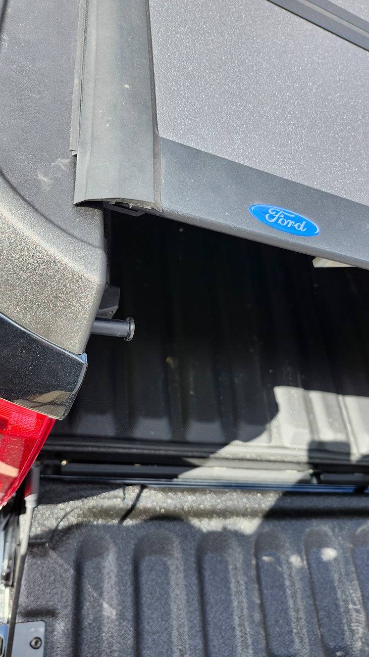

Here are the pics.
Ford Maverick 2025 Maverick Factory Tri Fold leaking 20250407_145527
Ford Maverick 2025 Maverick Factory Tri Fold leaking 20250407_145559
colinl
Colin
Jun 21, 2022
5,440
6,179
ICT
Here are the pics.
I would just get some adhesive weatherstripping and stick it to the bed in that end piece area. looks like under 3", maybe less than 2". you'll want to clean it with rubbing alcohol to prep for the adhesive strip.
I'd try either a wedge shaped or a d-shaped weatherstrip. you can find both of those (and more) on amazon, at a local hardware store, etc.
