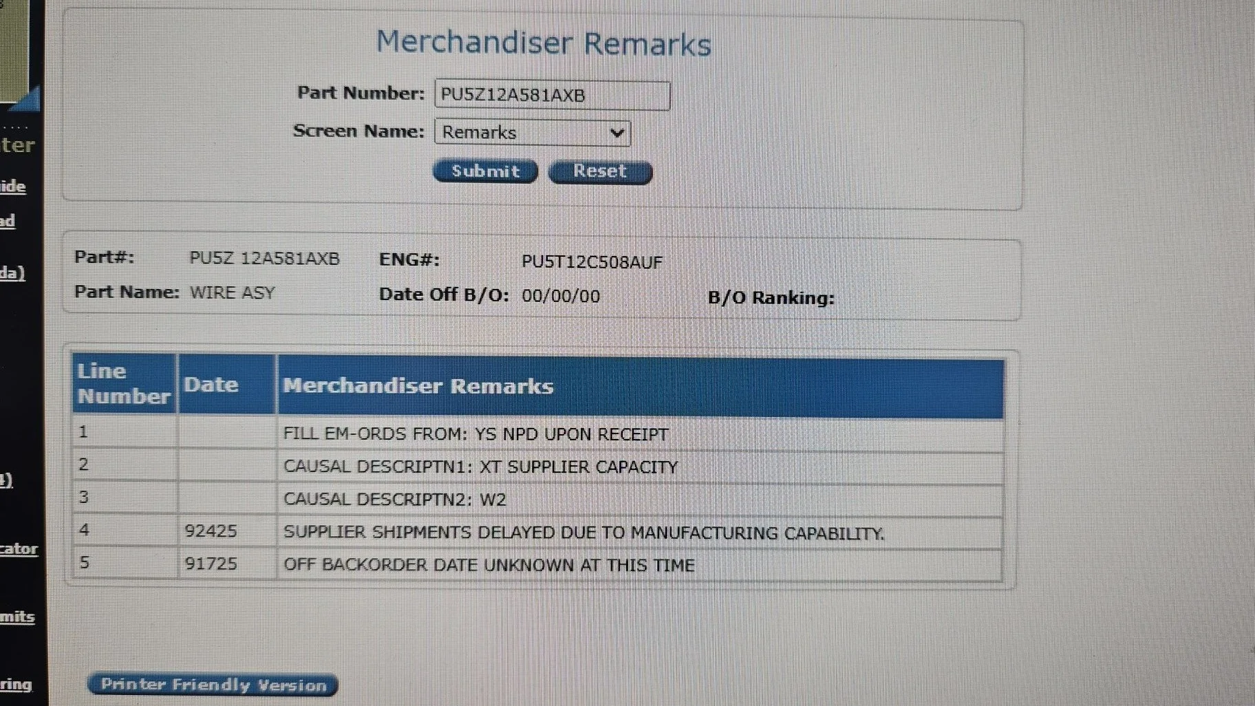

Here's a screenshot from a Ford parts manager that was kind enough to look this up for me. I can't believe these aren't available - especially since Mavericks are still being made (although I realize parts and the manufacturing line for new vehicles are 2 different chains.)
Definitely a frustrating experience. I'll keep this thread updated for posterity.

Another update: it's been over 3 months now with no news on parts availability and State Farm won't total out the vehicle. And I say this as a very enthusiastic (probably former) Maverick owner: my perspective is still that the 2025 Maverick isn't repairable. This has been a very disappointing experience.
I have never hired a lawyer in my life for something like this, but this is unfortunately going to have to be a lawyer's job now. I sincerely hope that I'm in the minority and most owners won't have to deal with this.
