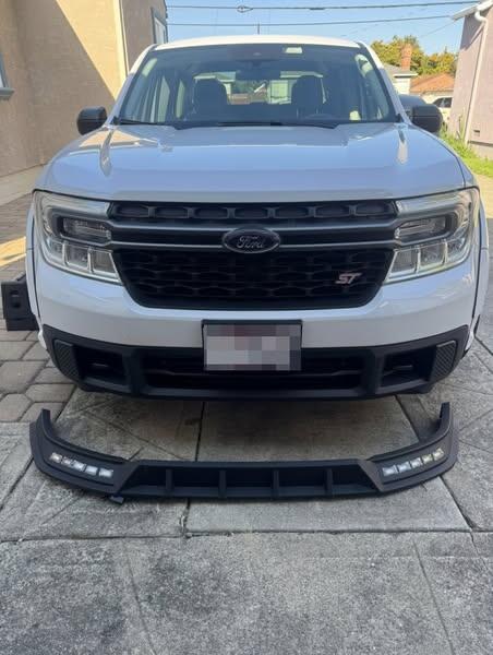

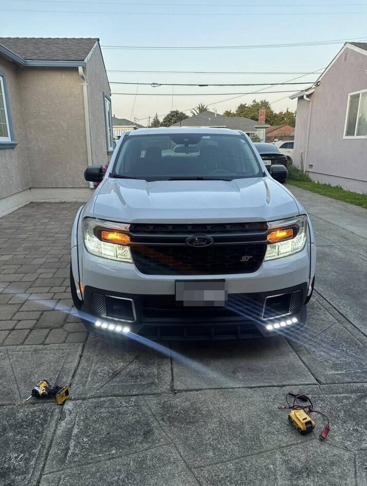

Mabett is making a lower valence with lights in it. It's on their fb group
