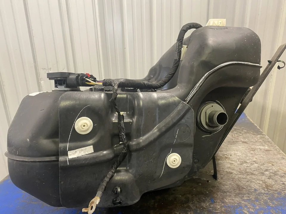

The tank is shaped oddly, I find mine drops quickly too.
