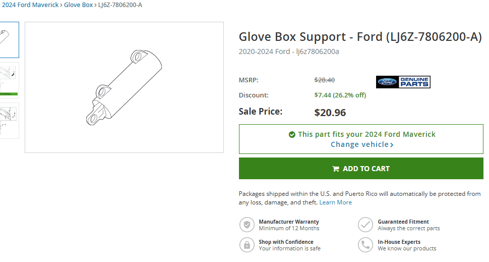

Visited my Ford dealership (Davidson Ford of Clay, NY) and spoke with the Service Manager. He spent the time to look of the shop manual for a 2020 Escape and my 2024 Maverick (February build). He printed the page showing the glove box damper area on each and the Maverick does not show the damper. So, it looks to me like Ford decided to save .50 and eliminate it.

I also went to see the Ford Service Tech and the Parts Manager where I bought my Maverick. It seems Ford stopped installing the damper at a certain VIN. He checked my VIN and my Maverick did not come with the damper. I thought I could get the damper under warranty but no luck.
I gave up and ordered the damper. It is supposed to arrive on Friday. I am still confused how it mounts using the two lugs on top of the damper. What I understand from others in this Forum is that only the rear lug snaps to a peg located deep in the glove box compartment and the front lug does not hook to anything. Am I correct?

You are correct.
Here you go. I dropped my glove compartment to show you the connections.
The first picture is the lug at the end of the PISTON and the nipple that it's attached to on the drawer.
Ford Maverick 2024 Lariat what's missing in this picture 20240619_145336
The second picture, is of the End Lug on the cylinder attached to the nipple inside the compartment.
Ford Maverick 2024 Lariat what's missing in this picture 20240619_145319
Not much more I can do for you now.
Good luck.
GB
The other lug is for a different vehicle. You can't use both of the lugs because the cylinder has to rotate somewhat.

Looking at the photo you posted for me, Is the lug/peg to mount the rear of the damper on the right side facing the glove box area opening?

...Looking at the photo you posted for me, Is the lug/peg to mount the rear of the damper on the right side facing the glove box area opening?
2-minute job, if that.
In the pic, the smaller end (lower left) simply snaps over the post on the glove box. The larger end snaps over the post in the dash. Do the back part first. The small rod can be pulled out to reach the glove box post.

You made me feel guilty about not installing the damper yet.
I severed the heat and got it installed today. I had problems installing the rear lug on the post. I tried several things but was able to get the lug on the post using a pair of needle nose pliers to grip it firmly.
