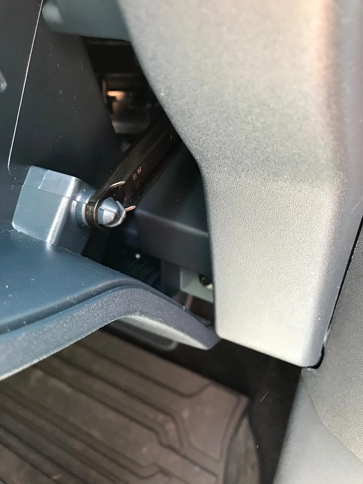

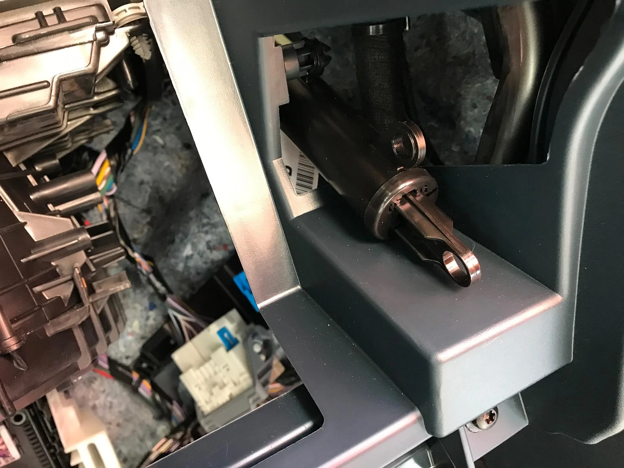

It fits just got mine an installed it…
Great very much appreciated. I see the post it attaches to in my truck too. Time to get one ordered. Absolutely no desire to even broach the subject with my dealer/service dept. But I will send pics to my salesman for his edification!

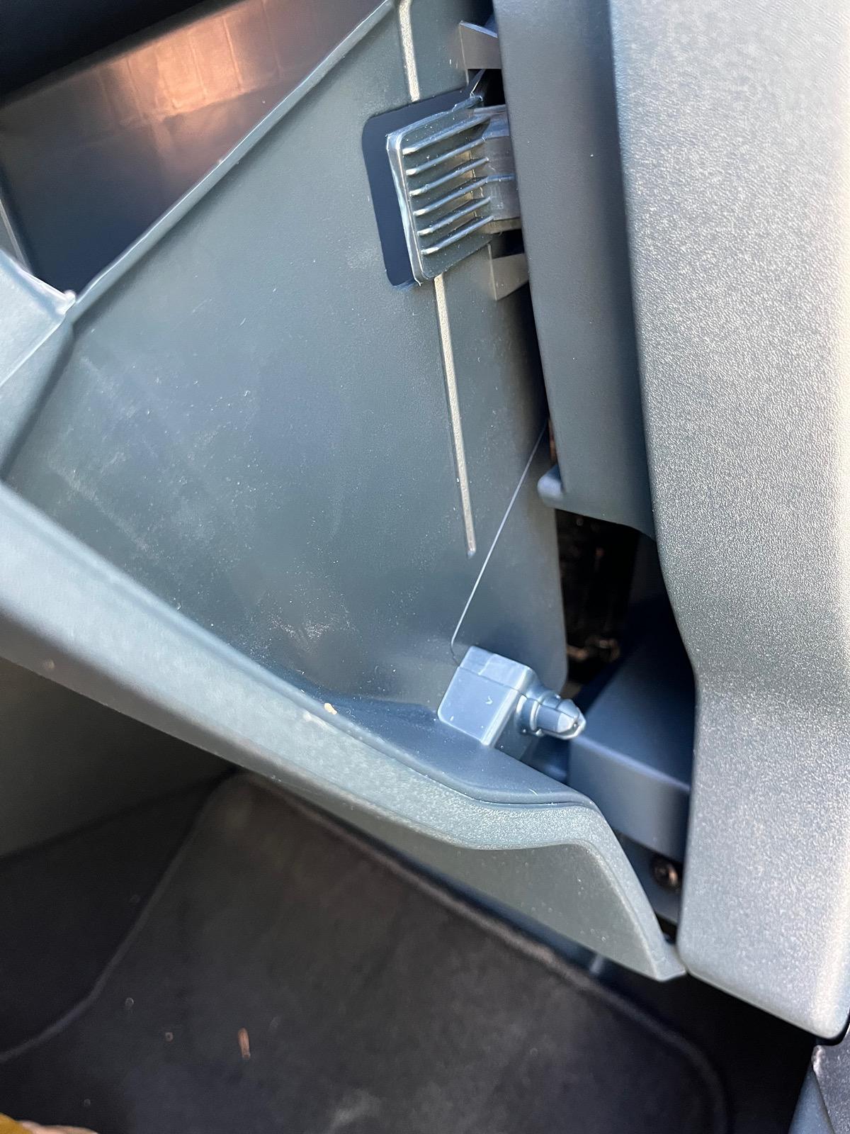

‘24 Lariat Hybrid manufactured in May and purchased in May. I also don’t have the dampener. I’m going to reach out to the dealer I purchased from to see if they can get me the part.
Emailed the dealer I purchased from. They said they could reimburse me for the part, but to talk with my local dealer first.
Local dealer said they need to take pictures to submit to ford and then they can get the part for me. My service guy has always been great, so I’m pretty confident he will get it resolved.
Hopefully,this helps others out there!
