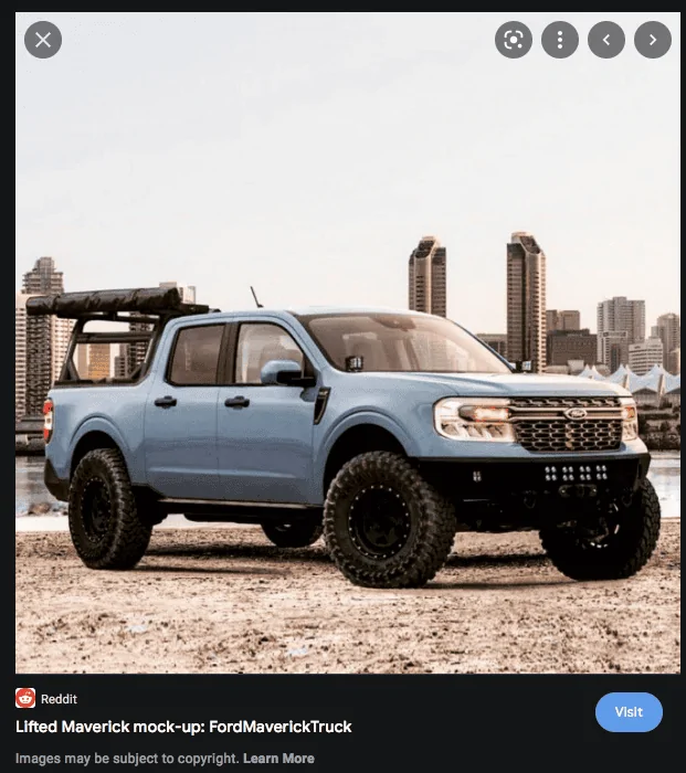

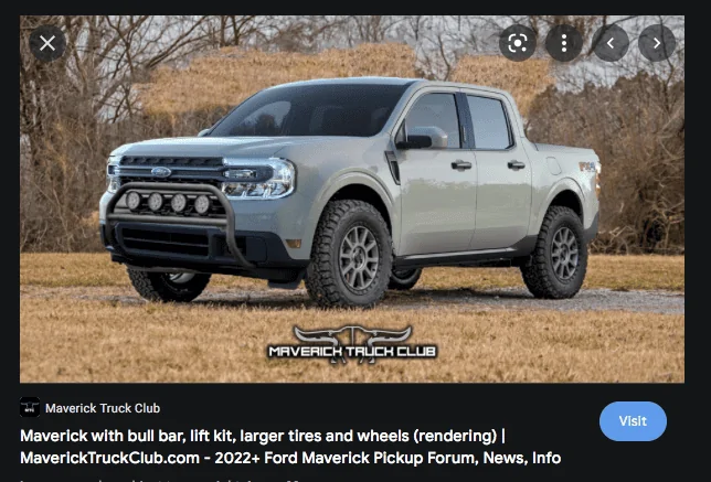

I want to get tires/ rims/ and a small lift immediately but will I run into any problems with it being a hybrid or should that not be a concern?
*picture below is not mine, but an example of what I'm hoping to have mine look similar to...hoping original poster doesn't mind me using their photo as an example*
Seems like nobody really answered your question, at least on the first couple pages.
Regarding wheels, they are going to work the same as on all Mavericks.
Regarding lift kits, the FWD models have a different suspension than the AWD models. AWD is likely going to be much more popular for lift kits, as its much more offroad capable.
If you were looking for something as aggressive as what you have shown, IMO I would cancel the hybrid order and get a AWD Ecoboost Maverick. FWD will limit you anywhere that aggressive tires like that would most feel at home.

I appreciate the response! I really would like the hybrid because of the awesome mileage but I will 100% be doing a lift and tires/ rims (if dealer has correct parts) before it even leaves the dealership. My concern now is if there will even be a lift for the FWD. I know that adding tires/ rims will affect the mileage for the hybrid but I'd guess it would still be better than the AWD. Would you think?

Better gas mileage in what way? On the HWY it will end up being very close to an EB AWD. If you're adding weight, increasing tire contact, and impact aerodynamics you're likely to cause the gas engine to work harder and longer than stock.
In the City it's likely you'll still get much better gas mileage than the EB but it'll still be hampered.
My question is why? The EB delivers pretty stout gas mileage for the performance it delivers. Seems like you're going to have a compromised build that probably won't really satisfy.
