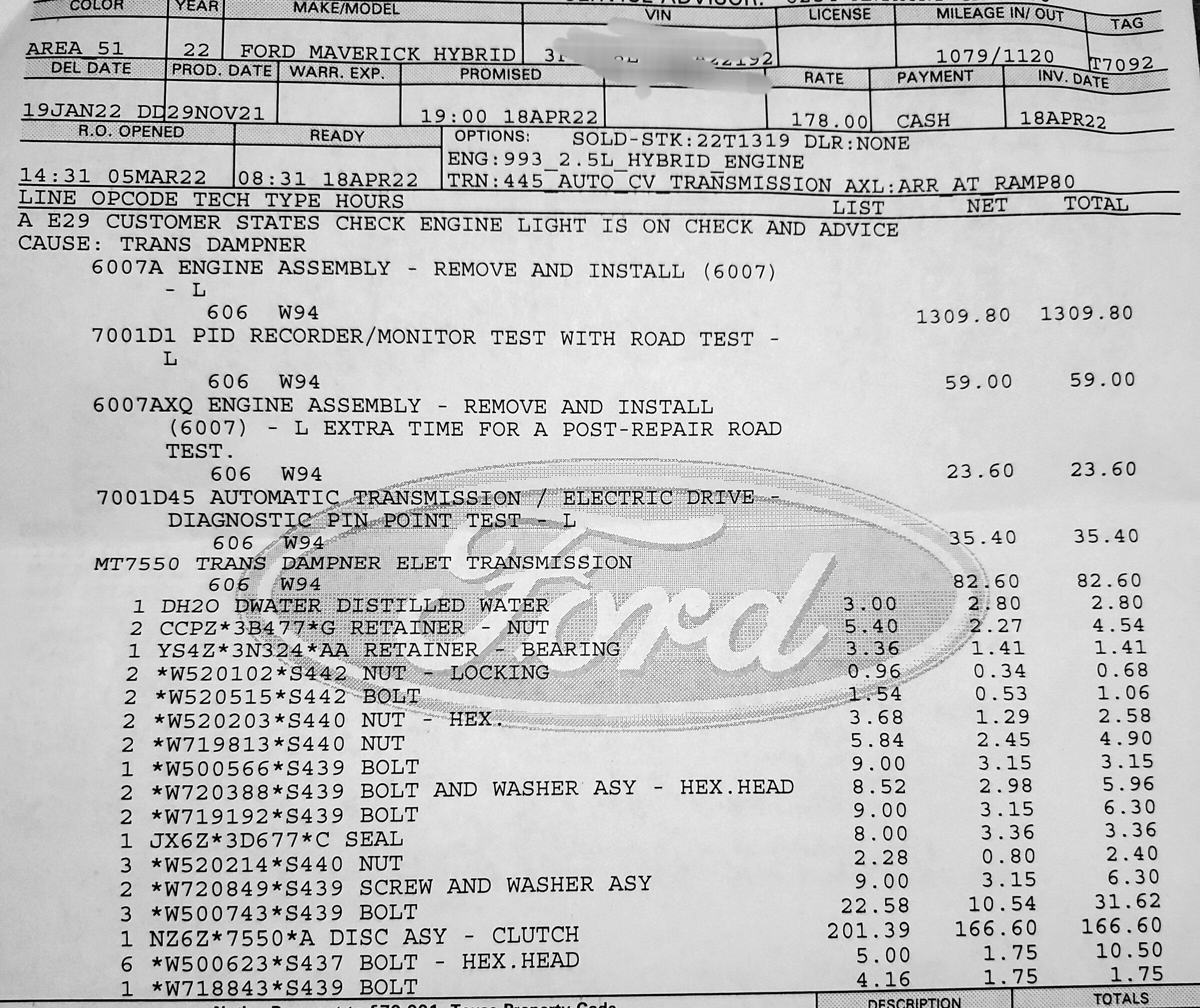

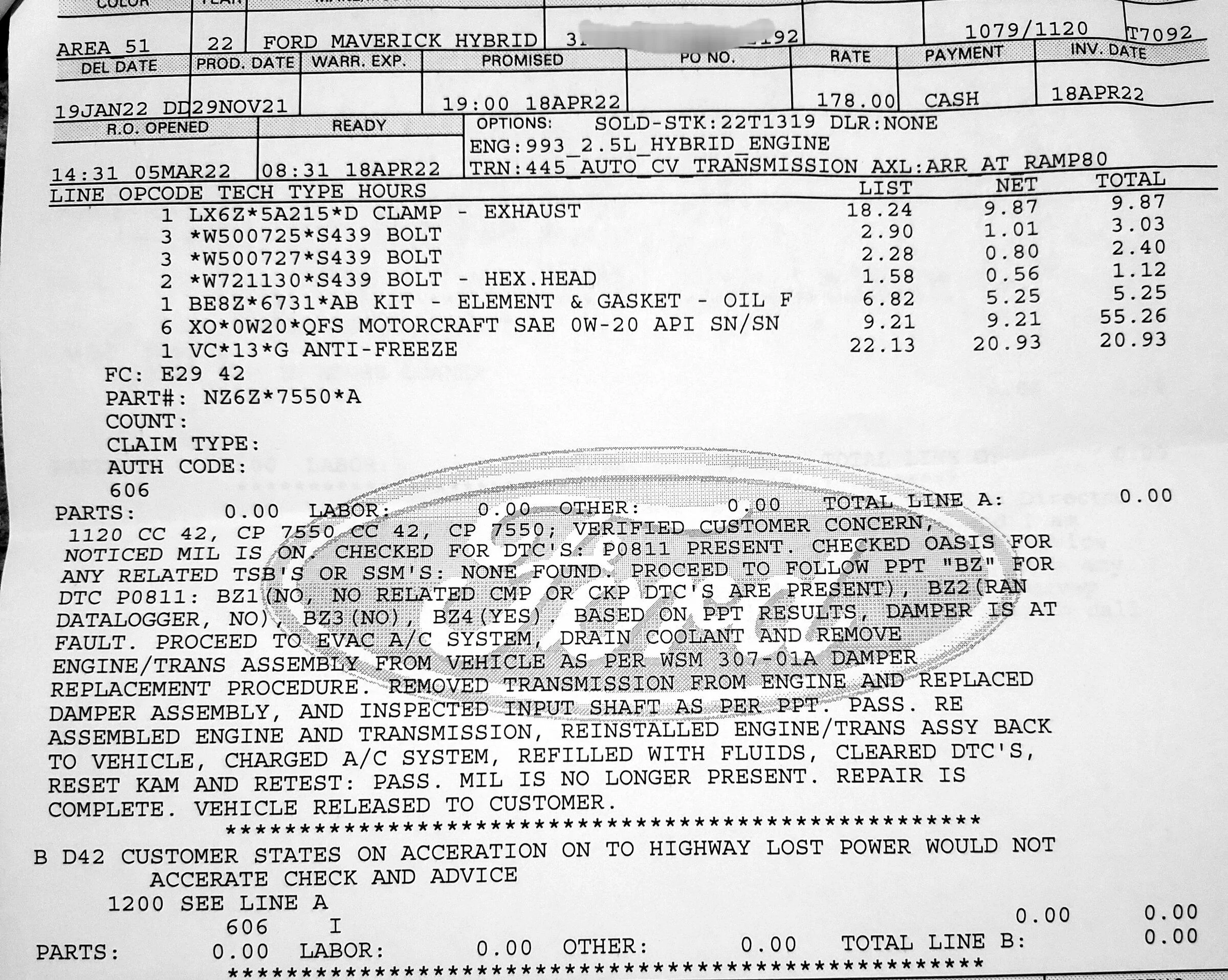

Ok so after a full day back with my Maverick I can say that the problem has been fixed!
A quick recap of events. My the CEL came on after accelerating hard, I took it to the dealership and they cleared it, and pushed an update but the CEL came back on after accelerating hard. They stated that they would have to replace the damper and that it was on backorder. Fast forward 6 weeks and they did replace my engine damper with a new one.
After I picked the Maverick up I floored the gas pedal multiple times. Each time the power gauge went to 100% and it accelerated with no issues. Both from a dead stop and merging onto the highway. Tried it again the next day with no issues. I will attach some pictures of my service order for those that want to see.
Overall it was a frustrating experience having my Maverick away from me for 6 weeks but that is what you get when you buy a first year model vehicle. I'm very happy to get my Maverick back and hope this issue was a one off!
Ford Maverick 2.5 Hybrid: P0811 code OBD2 20220419_213802
Ford Maverick 2.5 Hybrid: P0811 code OBD2 20220419_213629

As related to the Maverick 2.5 Hybrid, we can (cautiously) conclude the following:
- The Maverick Hybrid has a transmission damper called "Disk Assembly - Clutch" (Ford p/n NZ6Z*7550*A) located between the Internal Combustion Engine (ICE) and the HF45 transaxle. This clutch is designed to start slipping at a torque setting that is higher than the ICE can deliver i.e. under any engine torque up to 100% indicated it should NEVER slip.
- The Engine Control Unit (ECU) can read when there is a mismatch between the ICE RPM and the transaxle RPM due to said clutch slipping. It will then REDUCE AVAILABLE POWER for a while to prevent this slippage from occurring. This will not necessarily turn on the Check Engine Light (CEL). You may or may not notice this slippage when driving. If you generally drive the vehicle gently you may actually never notice that engine power is reduced (the power gauge won't go to 100%).
- When there is a large enough mismatch (slippage) for a certain amount of time the Check Engine Light will come on with an indicated "P0811 - Excessive Clutch A Slippage" code. This CEL will turn off after a few start/stop cycles. Engine power will be restricted, so you won't be able to see 100% power on the gauge.
- Replacing the Damper/Clutch unit appears to resolve the excessive slippage but is a pretty big job as it requires the engine/transaxle to be removed, and separated before reinstalling.
- A potential less intrusive remedy: Try loading up the clutch assembly under full engine torque a few times, and allow it to slip a few times (before the ECU steps in and reduces power for a while). This may cause the friction surfaces to be "bedded" properly and this may sufficiently raise the clutch slip torque level going forward. Basically: a few full-throttle acceleration runs over a few days may fix it (as it appears to have done on mine). The ECU will actively try to prevent slippage by reducing engine torque, so you may have to give it a few tries with some time in between.
- Ford will need to look carefully at this clutch assembly, the friction surfaces, and the installation procedure when mating the HF45 and the 2.5 Duratec ICE.
