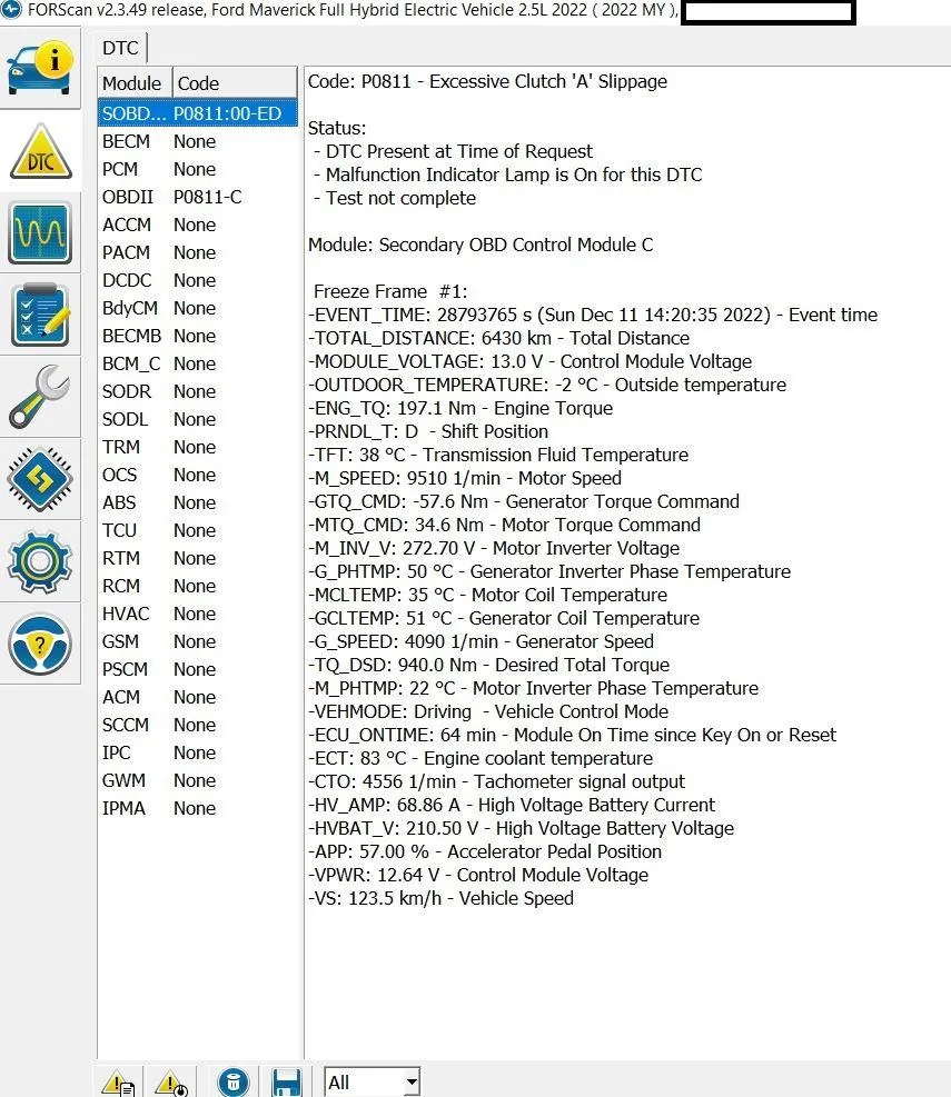

Mine came on for the 2nd time at 6400km and only 57% "Accelerator Pedal Position" so while I was moving right along, I wasn't exactly flooring it or anything.
Ford Maverick 2.5 Hybrid: P0811 code OBD2 11dec2022-dtc

Hmm....
But could it have been 57% on the way down from something higher just prior?

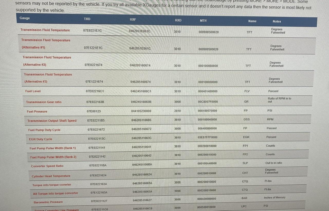

I don't have FORScan but looks like a neat item to have. I have something called ScanGaugeIII. Maybe you've seen it. Mine is only for dispLaying digital gauges. I have half the ones on your list. I can manually program additional gauges, but I need the hexadecimal codes or "addresses" for each. Will Forscan tell you this level of data, for say TFT or G_Speed?
looks like this: Thank You
