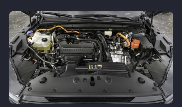

Could this fit in the Maverick engine bay? Currently used in the Lincoln Nautilus with a combined HP of 310. Maybe 360 HP with the “Big Turbo” from the 300T Ford Performance Maverick?

If you are talking about the motor, its already in the 25+ mavericks.

I know they make the 2.0T hybrid. Be nice if they would start doing more of that in the Mavericks. Really wish they had a plug in hybrid engine option.
The Maverick uses an Atkinson engine while the Nautilus uses the 2.0 EB Turbo engine in their Hybrid.
Not sure if they both use the same electric motors, although the $90k Nautilus shares the same battery problems (per “google”):
