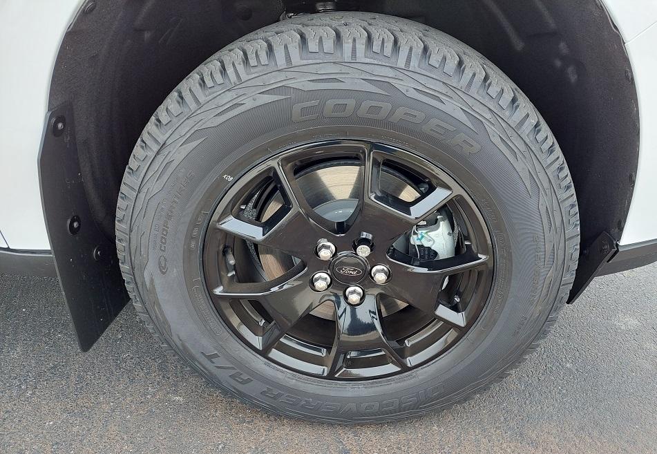

How much more sidewall could you possibly want? Here is a 245 65 17.
Ford Maverick 16” rims wheels? truck6
