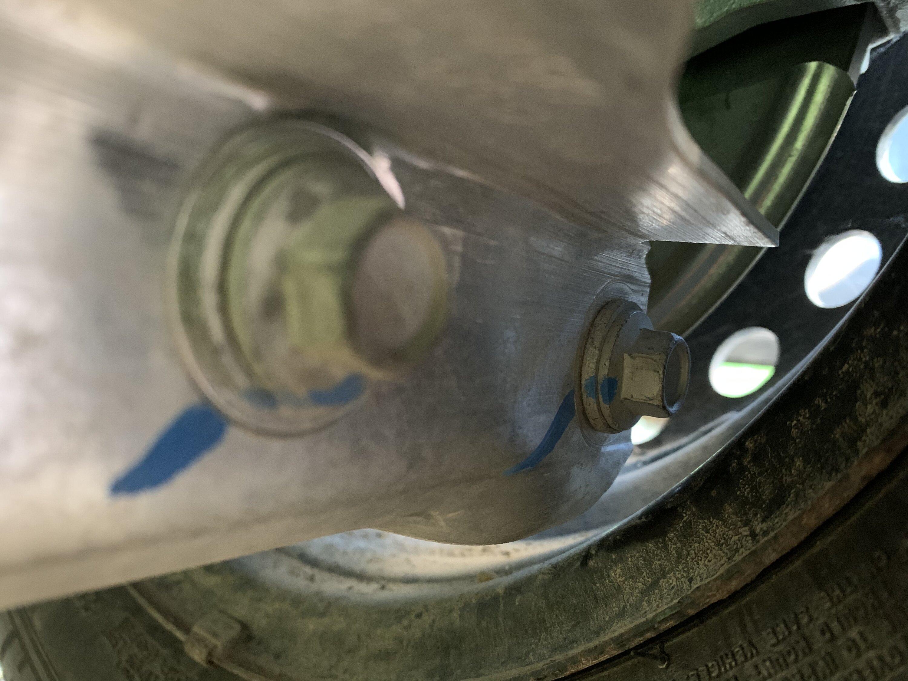

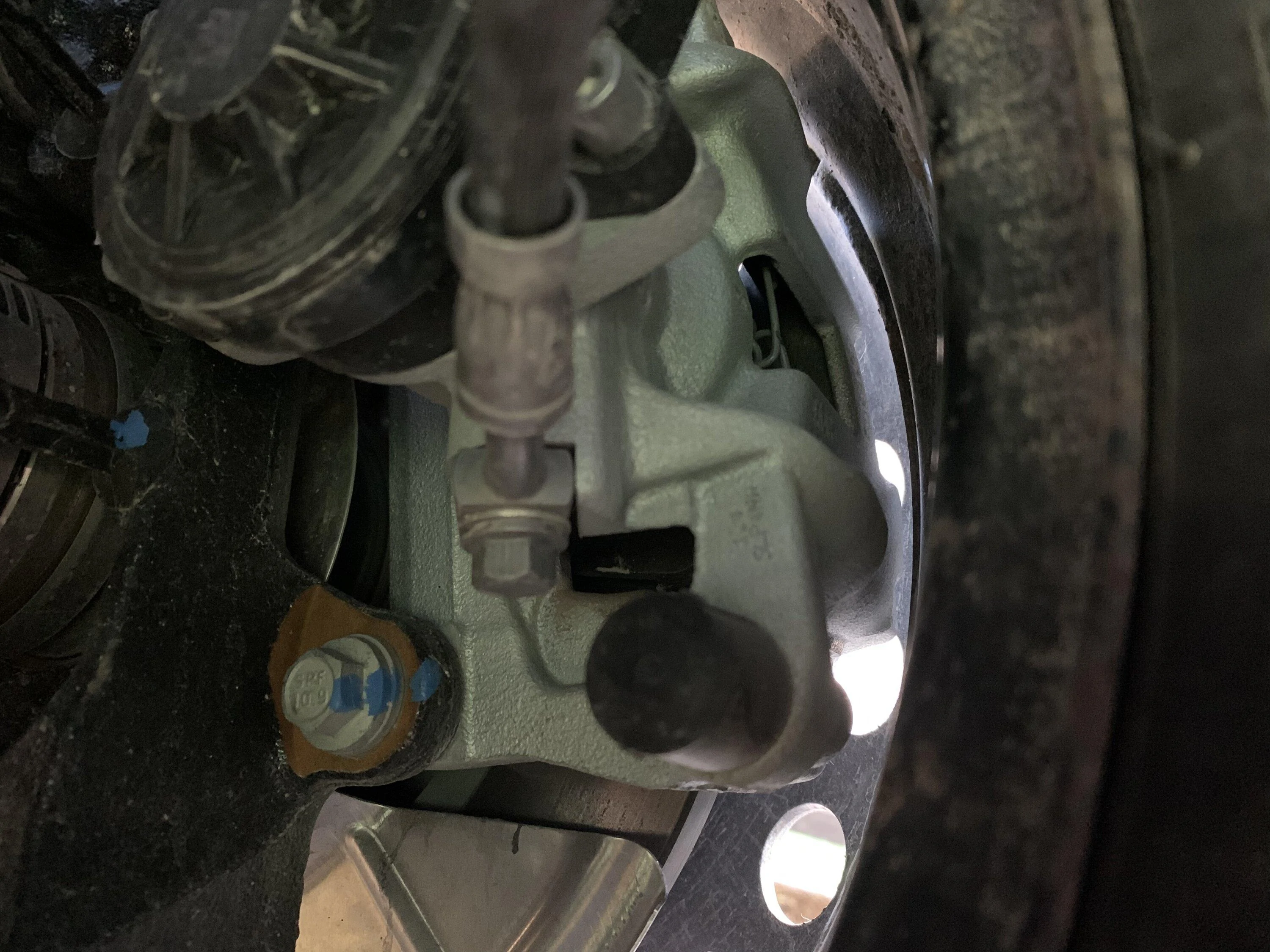

Finally got to trying the 16” steelies in my shed, I didn’t buy them new so I’m not sure of the offset, all I could find is that they are 16x6. From the looks of the rims, they are very positive, maybe +50ish.
Here is some photos of how tight the clearance is.

Wow, That looks tight!
Are going to run them to see if they touch at all? Might want to stay off of gravel roads.

Unfortunately, they are too tight for my comfort. Gonna have to sell them and put the money towards some 17” steelies…

You may want to try them with a 6mm spacer to see if you then have enough room. Steel wheels being much thinner than allows, with the spacers, should be no problem, maybe even an 8mm.
