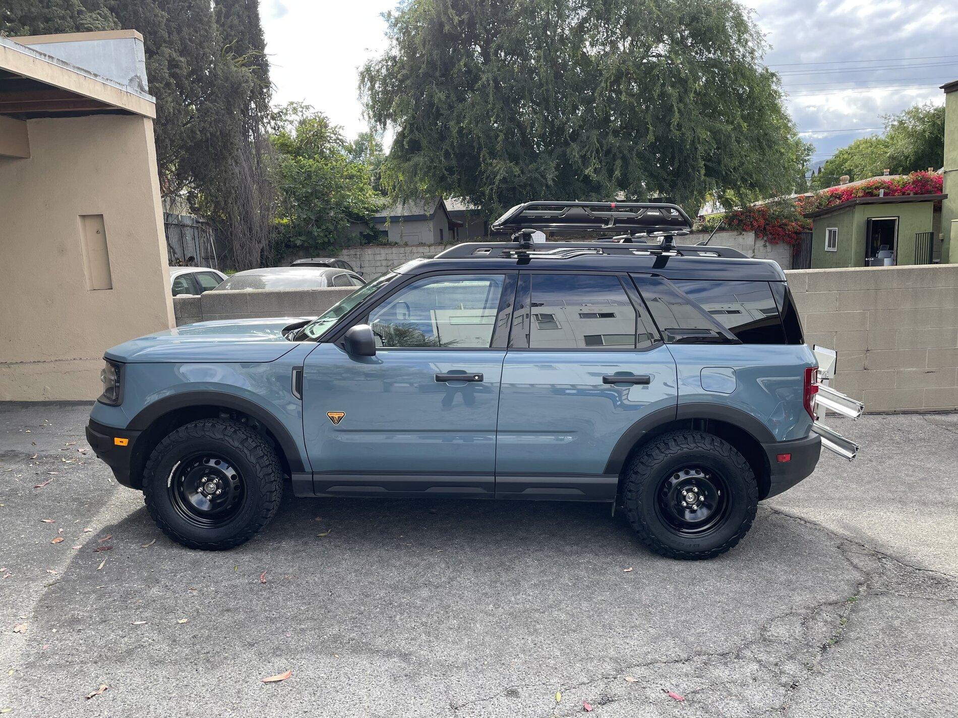

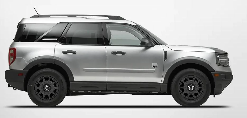

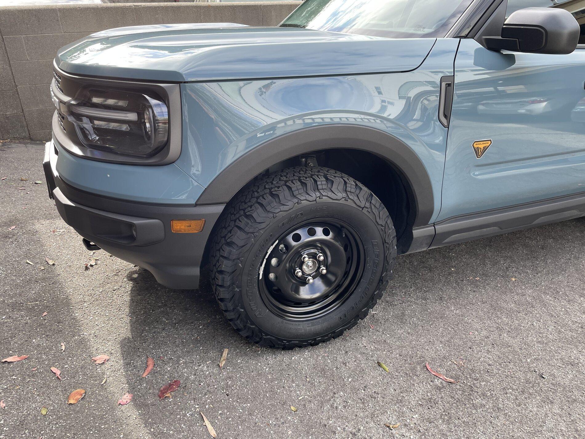

I am assuming since the Maverick is based on the Bronco Sport, we should be able to fit 16 inch wheel over the brake calipers and rotors yeah? See the pic from the Bronco Sport forum. Stock Bronco Sport size is 17x7 inch +38 offset. Running 225/70R16s would give you almost the same O.D., with no change to ride height or speedometer. Tire rack has Method MR502 in 16x7, but with +30 offset which I think looks sharp.
Anyone else have any other 16 inch wheel suggestions that may work?
