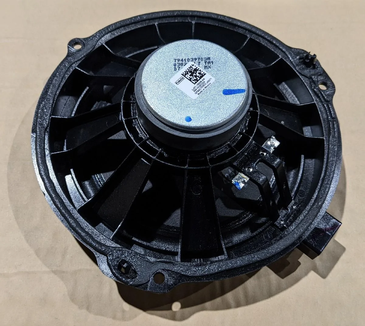

Front: 6.5". Much more substantial than the lower trims magnet-wise, but otherwise fairly standard paper cone woofers. No ratings markings, but they meter as 4-ohm (3.7)

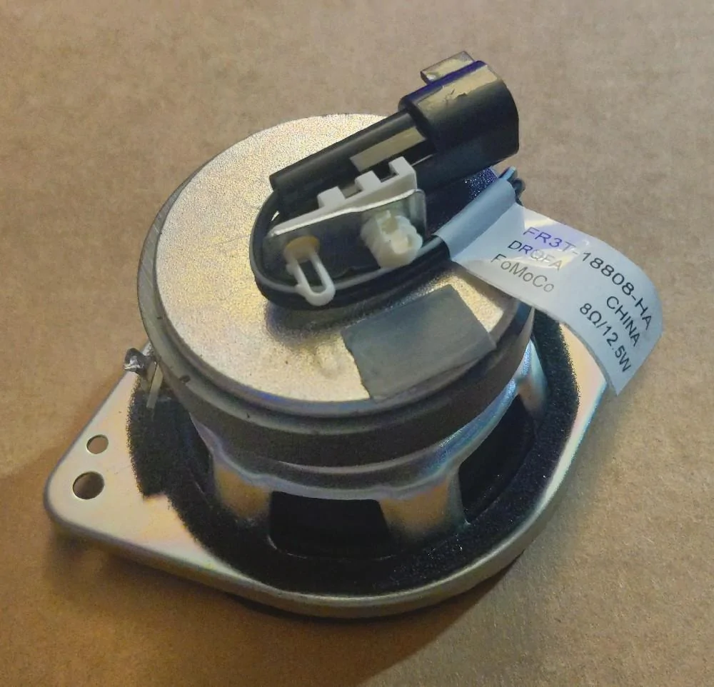

Center: 3-1/2“, 12.5W @ 8-ohm.

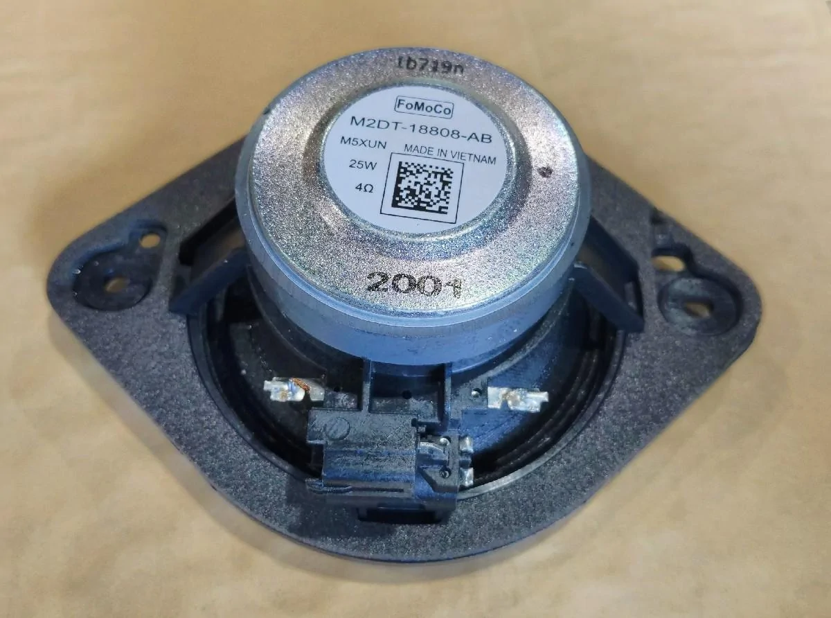

Rear: 4", 25W @ 4-ohm. Has a filter cap attached but too enclosed to read.

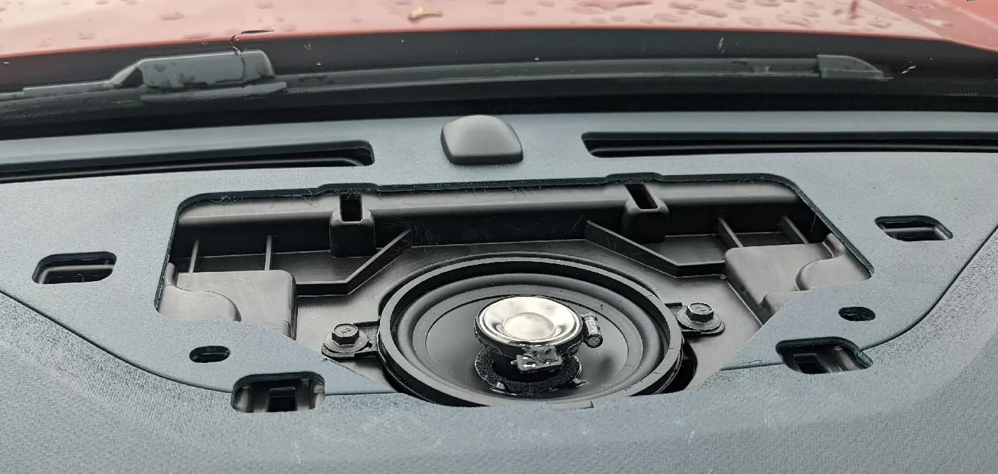

Here's the center speaker mounting area with the (slightly circumcised) MB Quart installed. I wouldn't be surprised if lower trims have this mounting location but the dash cover just isn't cut out since it's otherwise the same just the grille snaps on top.
