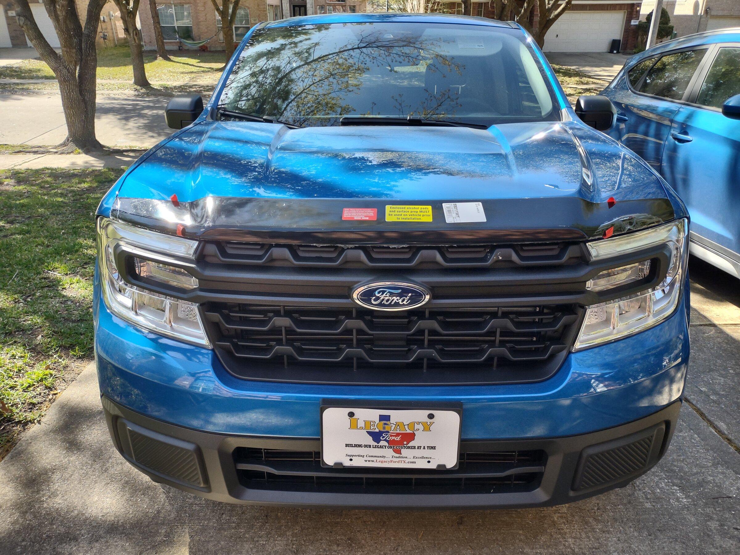

The before shot:
Ford Maverick Installing the WeatherTech Hood Protector IMG_20220403_160611311_HDR

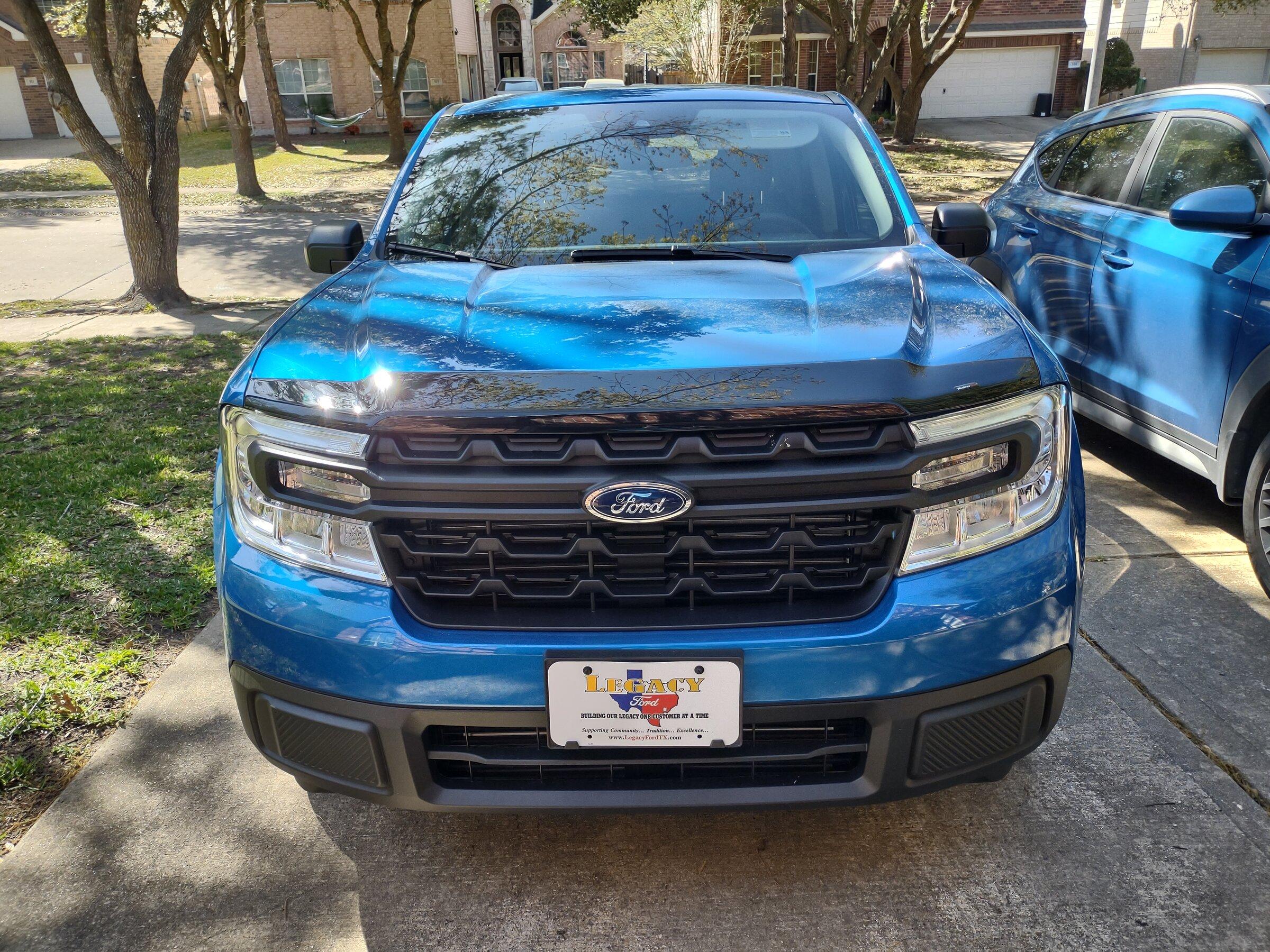

This is after masking:
Ford Maverick Installing the WeatherTech Hood Protector IMG_20220403_161305280_HDR

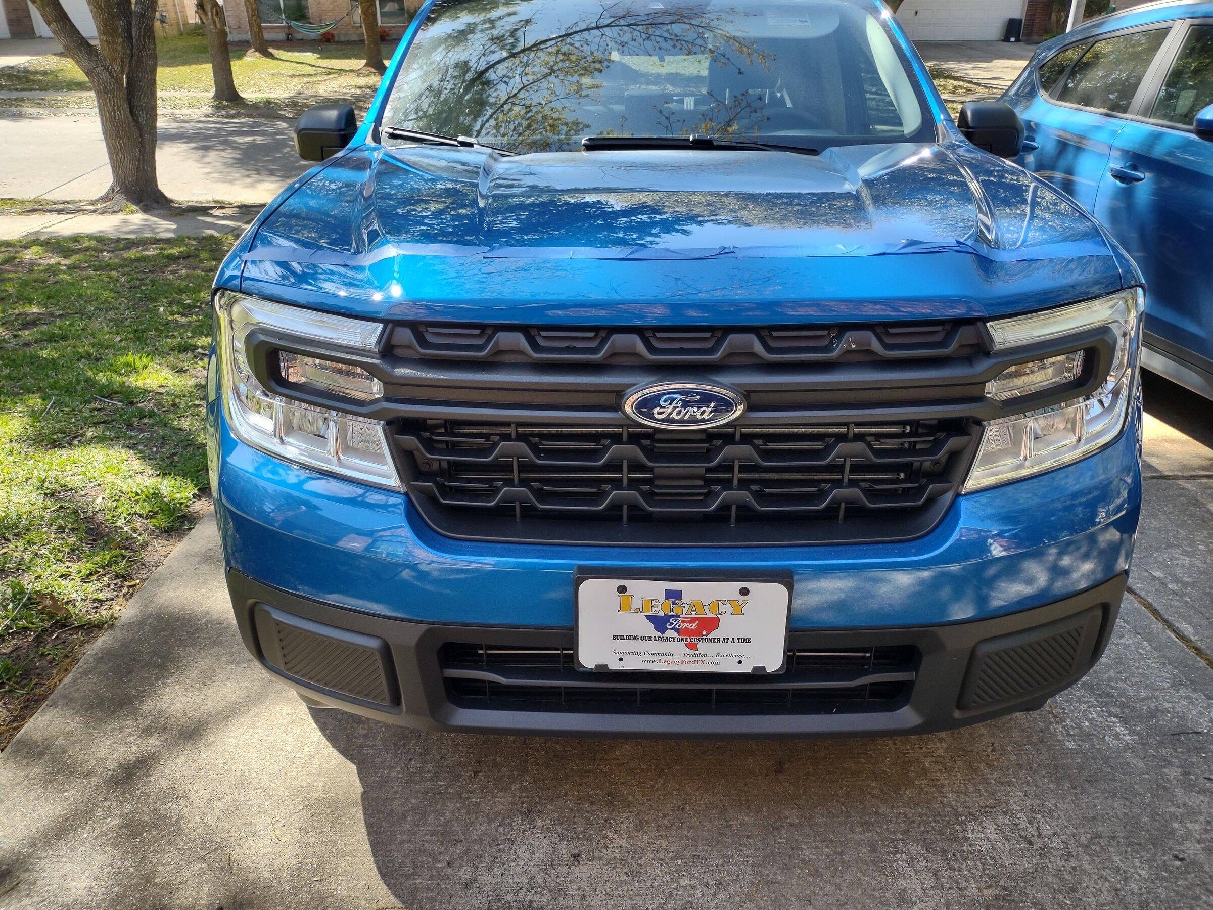

The next pick was taken after I had already pulled the top and bottom center sections of backing. You can see the backing for the edge sections still waiting to be pulled:
Ford Maverick Installing the WeatherTech Hood Protector IMG_20220403_162336153_HDR

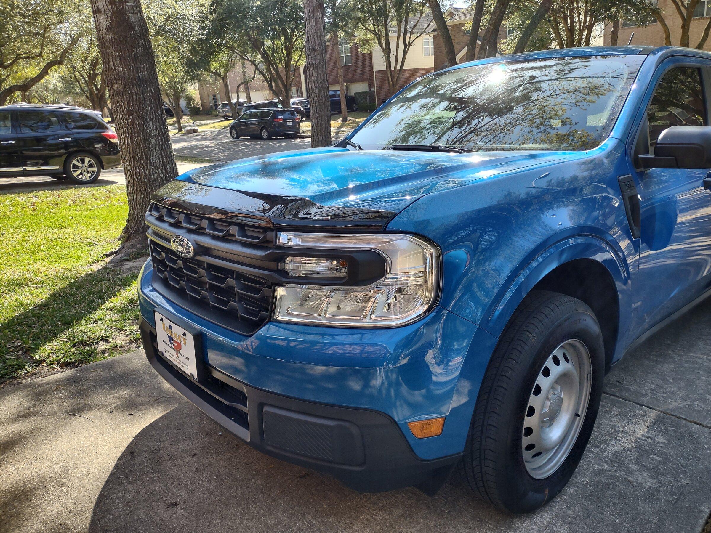

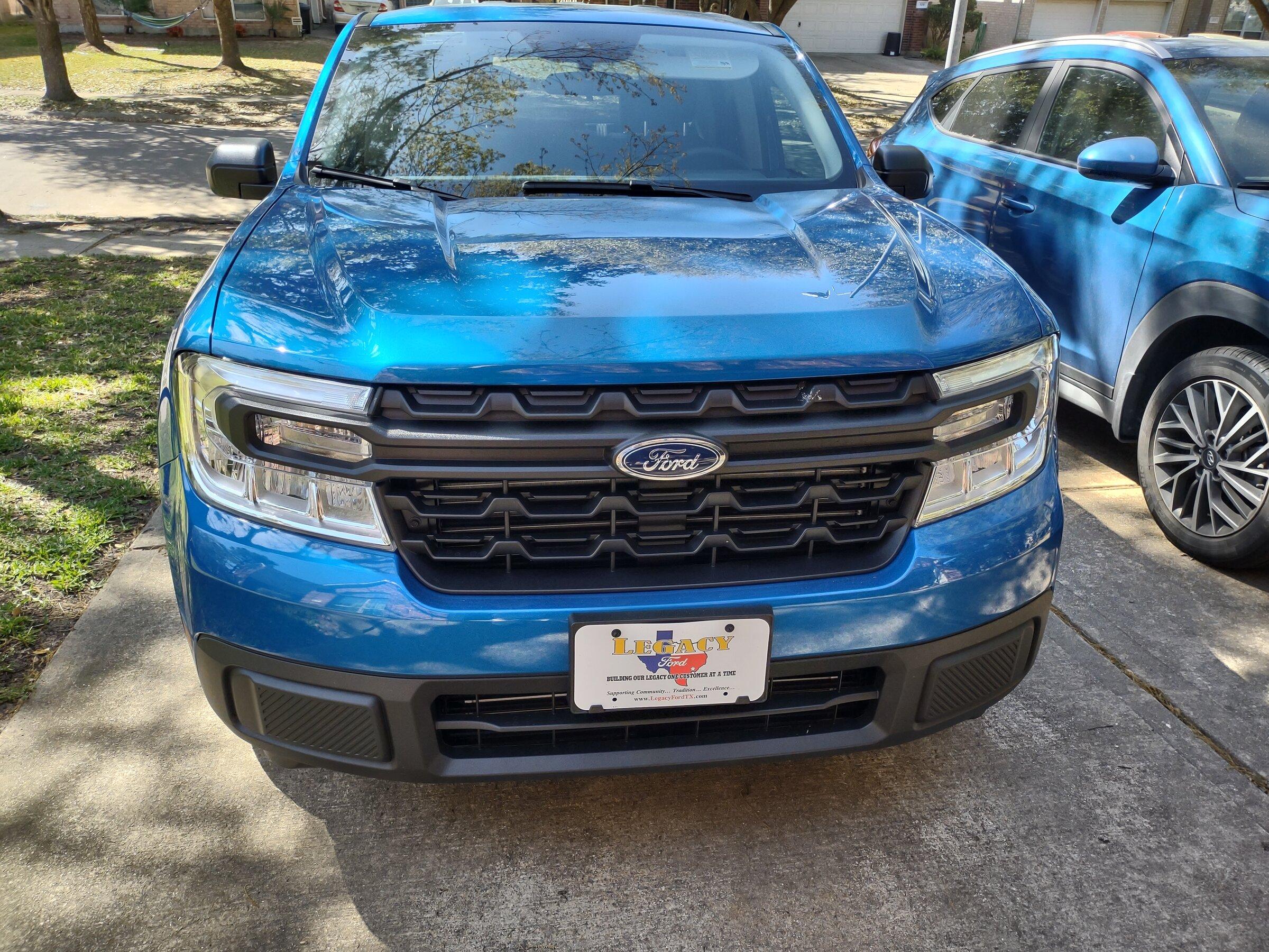

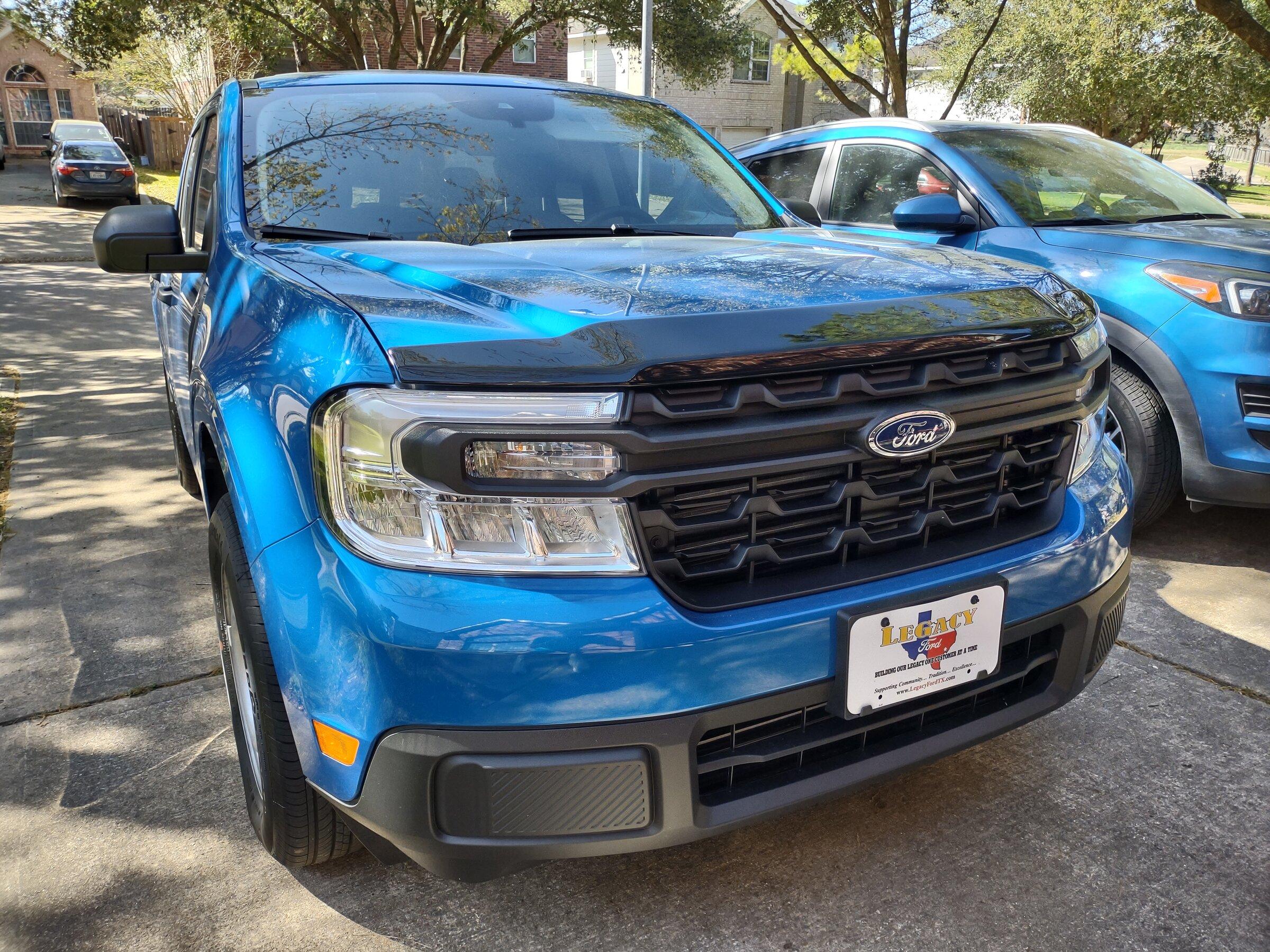

The finished product. It is recommended that you do not drive for 24 hours or wash the truck for 72 hours, so schedule your time accordingly.
Ford Maverick Installing the WeatherTech Hood Protector IMG_20220403_162533070_HDR
Ford Maverick Installing the WeatherTech Hood Protector IMG_20220403_162542375_HDR
Ford Maverick Installing the WeatherTech Hood Protector IMG_20220403_162557248_HDR

So it doesn’t stand proud of the hood like the old style bug deflectors?

It looks glossier than the one Ford sells, does that seem to be accurate? I was going to get the WeatherTech myself, but I'm not in love with that glossy look.

Does the WeatherTech logo come off?
Ford one is glossy too. Actually, they look exactly the same so I wouldn't be surprised if Weathertech is a rebranded LUND AEROSKIN.
Ford sells 2 different types. Smoke, which is glossy like the one you see posted from OP. Textured, which is flat black and not see thru or transparent in any manner.
It doesn't look like it would come off easily. It doesn't really bother me enough for me to risk making it look worse trying to remove it.
