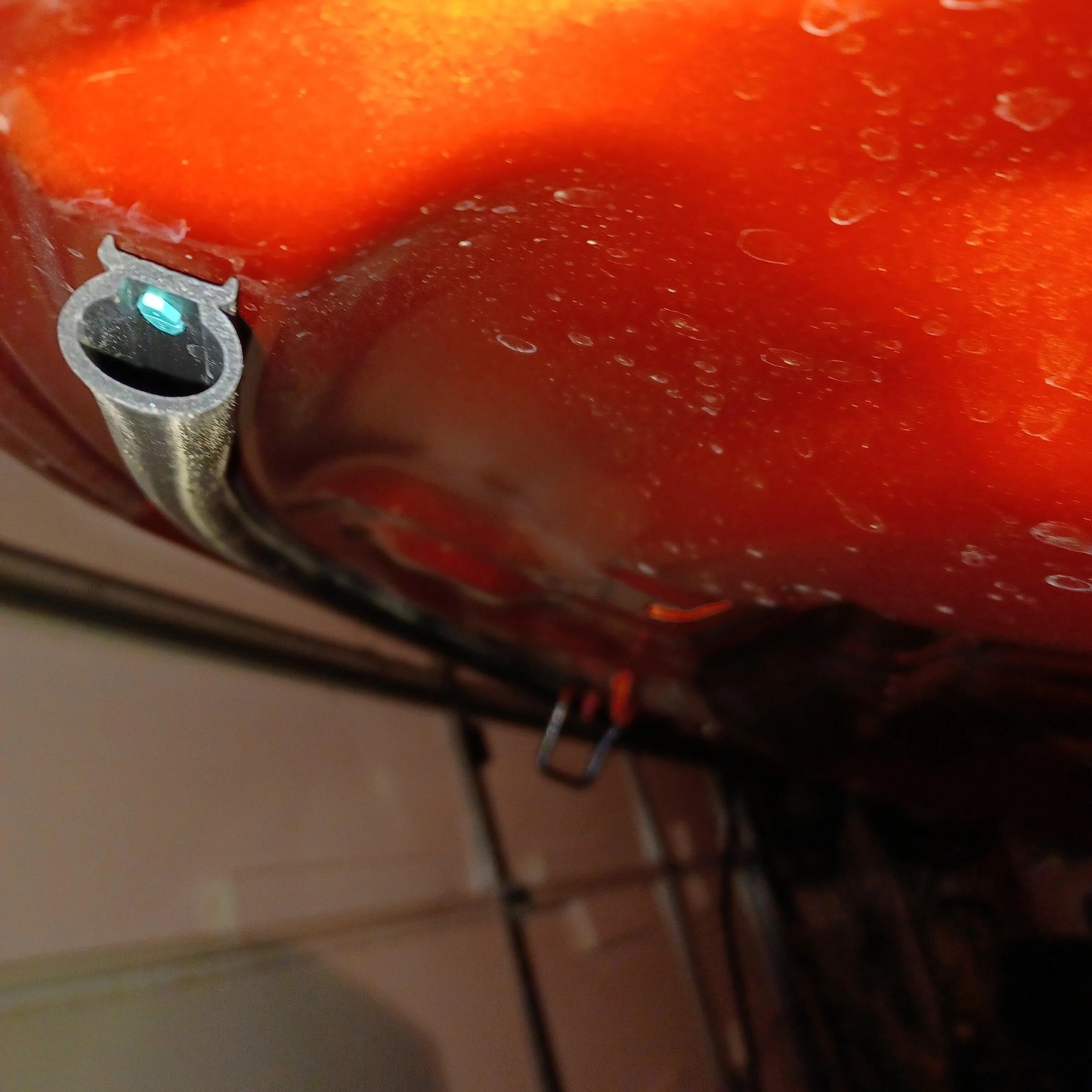

I just received the AVS BugDeflector II for my Maverick and it in fact mounts using four of the panel pin holes on the underside of the hood.
First Pic is the end of the weather stripping where you can see the aqua panel pin that holds the weatherstrip up to the hood.

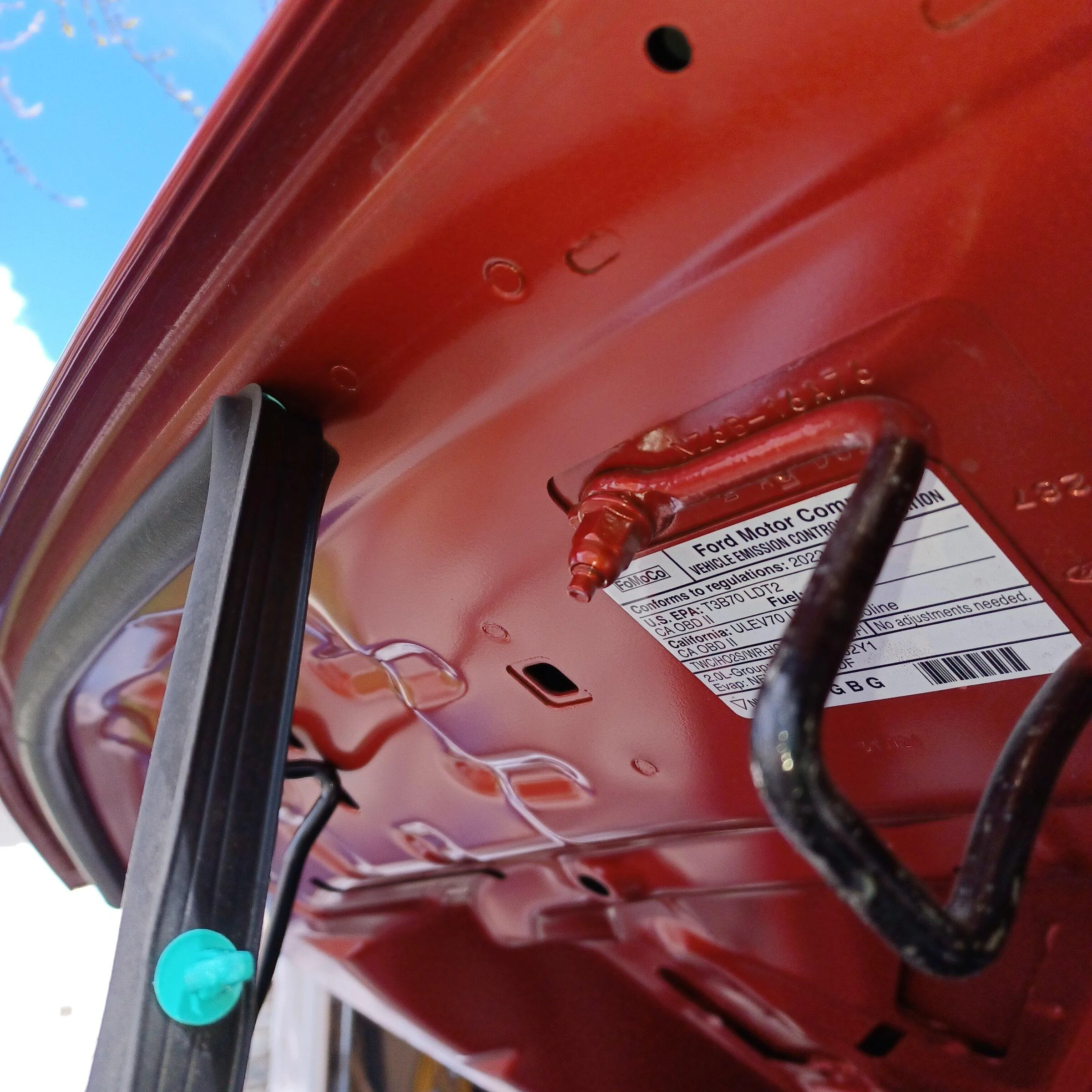

You need to get the narrowest panel clip removal tool as those pins are about 5/32" diameter and a narrow tool can catch both sides of the arrow that is in the hood.
Just get behind the weatherstrip and the pin and pop them out. I use a plastic pin remover that looks like a tack puller.
Ford Maverick Installing the WeatherTech Hood Protector 20220415_141106
The instructions say to just pull out the ones behind the four holes but they also want you to grease pencil the hood to mark the placement. No grease pencil needed if you take the entire strip off. I put it back after the deflector was on and it keeps the thing from rattling when you are running down the highway.

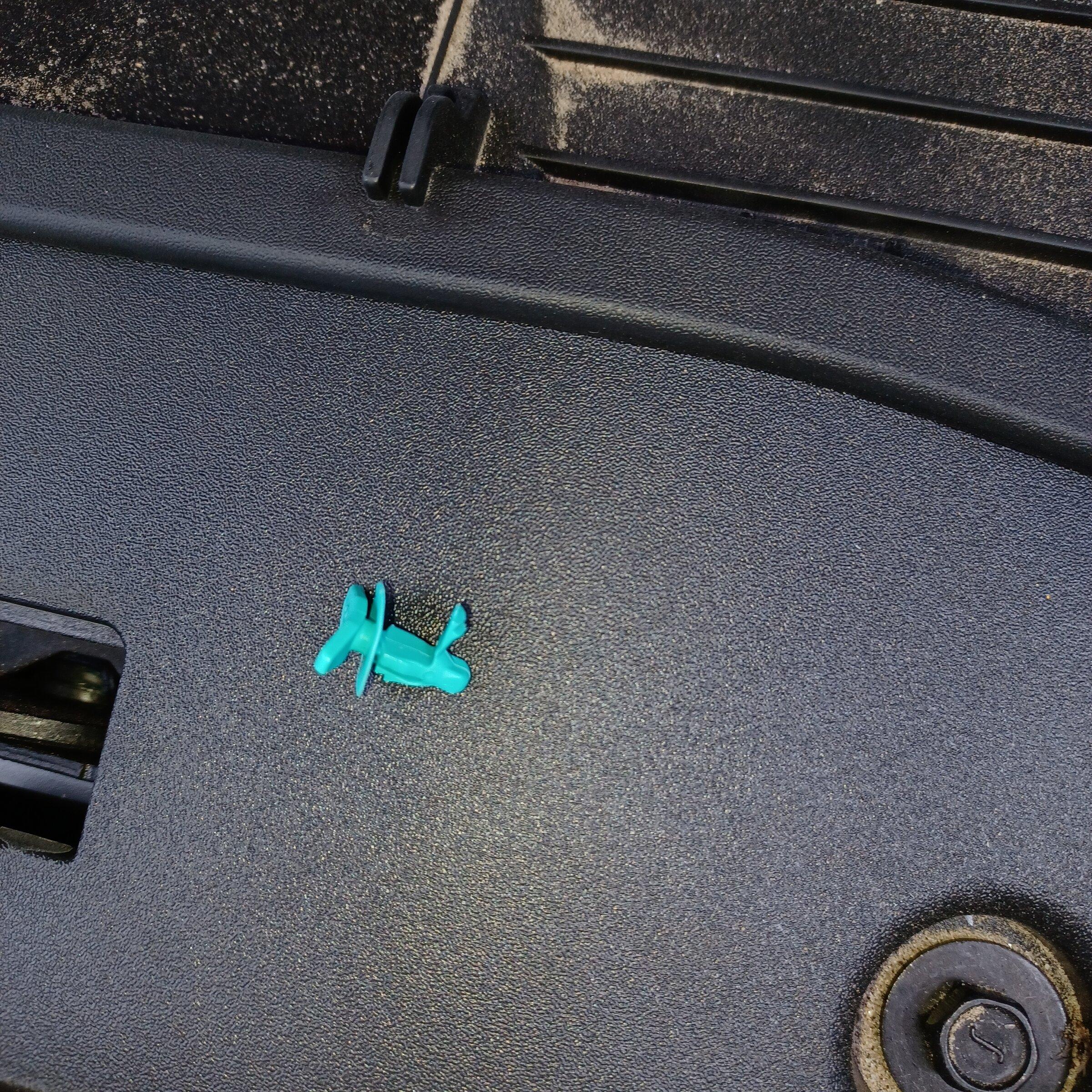

And if you aren't careful they get screwed up. The kit comes with four but I, fortunately had four pins that were longer and fit the hole better than the ones that come with the kit. You can pick them up at any Ford dealership. They are the same as the clips that hold the weatherstrip on the hood of a 2019 Escape.

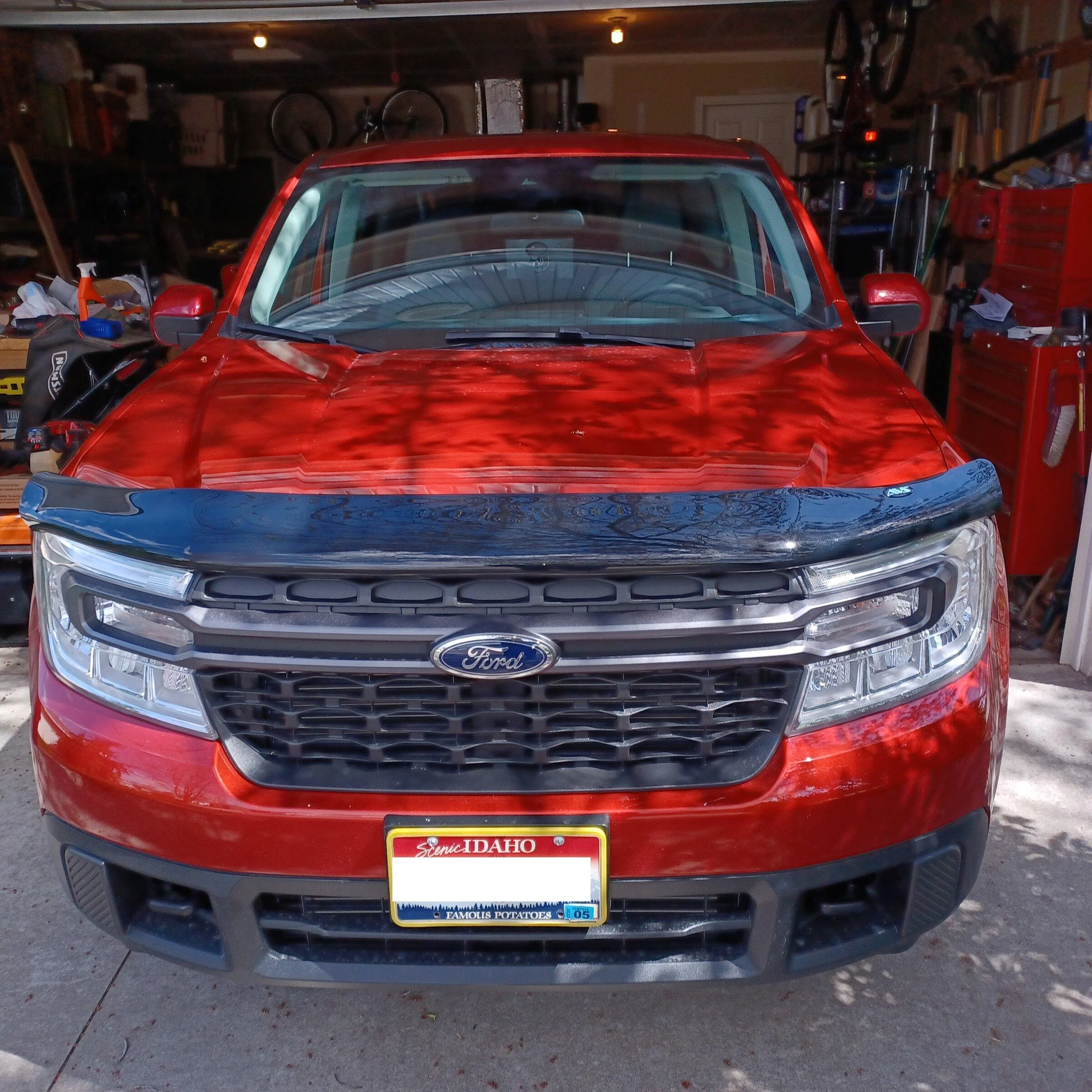

It took longer to get two coats of Carnuba on the hood before I put the deflector on than it did to install it. In all it took about 30 minutes. but it looks pretty good, notice how much wider it is than the Aeroskin and Weathertech. It is overall about six inches wider and protects the entire lip oif the hood and fenders. and with the weatherstrip between it and the hood rail it doesn't rattle around at all and you can barely see it at the end of the hood when you are in the driver's seat.

I drove on I-84 the next day and paid attention to the hood. No shaking at all. The deflector ends at the same height as the body line above the hood lip. so you don't see the top of the deflector except for the outboard above the headlight and just about 1/8" is all. After reading about hood shake I have been very observant of the hood. Mine is tight and has no added motion. There is no shaking or any indication that it isn't as tight to the body as the fenders or doors. I am pretty happy with the construction of this unibody truck. The only concern I have is if it will fold in half if I need to stop fast with the trailer attached or off-road pulling the trailer. We shall see how it behaves. I am paying close attention to the weight and height of the truck with the trailer attached.

Nope, it actually works fine for bugs and crud. There is enough airflow directed over the top of the hood that bugs go over the roof, mostly. I got a hornet dead center of the windshield but that has happened with almost every bug deflector except the one on my '76 Granada Sport GT. That was a dead vertical deflector that was more of a bug dam than a deflector. It was always coated with mosquitoes and bees a few bumblebees and hornets hit the top of the windshield but few hit the middle of the glass or lower.
I got a rock chip, barely noticeable but it stood out, before I got the deflector, right at the curve of the hood lip. Half an inch lower and it would have gone into the engine bay. So this will stop those and that is what I wanted it for more than anything. The grill on this truck is pretty much an air dam and pushes everything either up to the hood or into the radiator. This will guard the hood against that and it pushes the smaller insects over the roof.
