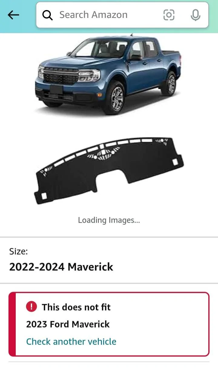

That explains why Amazon messages "Won't fit your vehicle".Since the Maverick doesn't come with an AGM battery, Amazon will state it's not for your Maverick, regardless if it physically fits or not.
