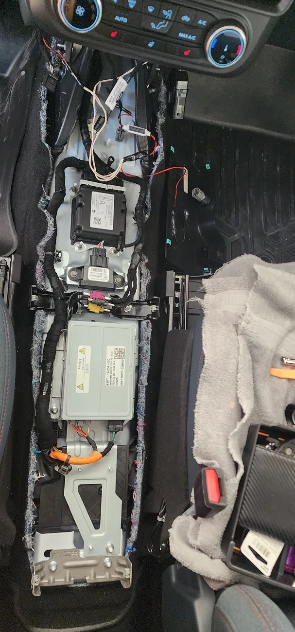

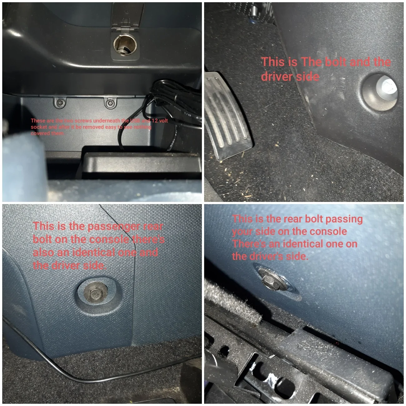

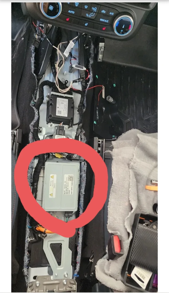

As others have stated it sits directly below the console but you have to remove the entire thing if I remember correctly it was a total of six bolts and you'll also have to pull the panel w/ the USB ports & 12V port above the front console tray under HVAC controls to access two of the smaller bolts. there's also a large wire harness to disconnect the front.
I remove my console when I installed my ambient lighting kit in the footwells cup holders and rear of console.
